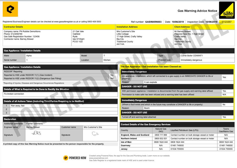

It is odd that you have no "readings". He should have recorded them on the Warning Notice. Did you get one? Typically looks like this - although different printers vary:
