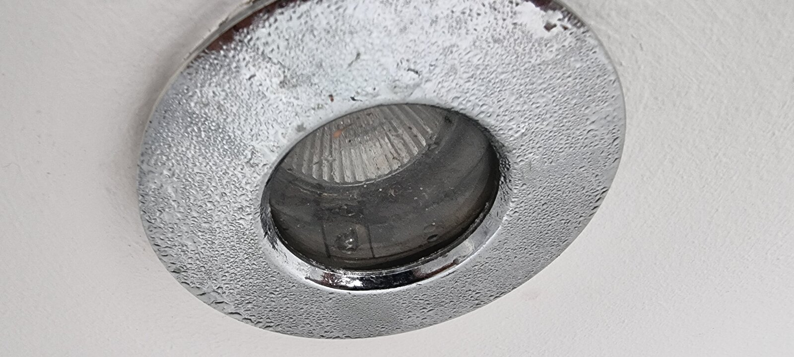

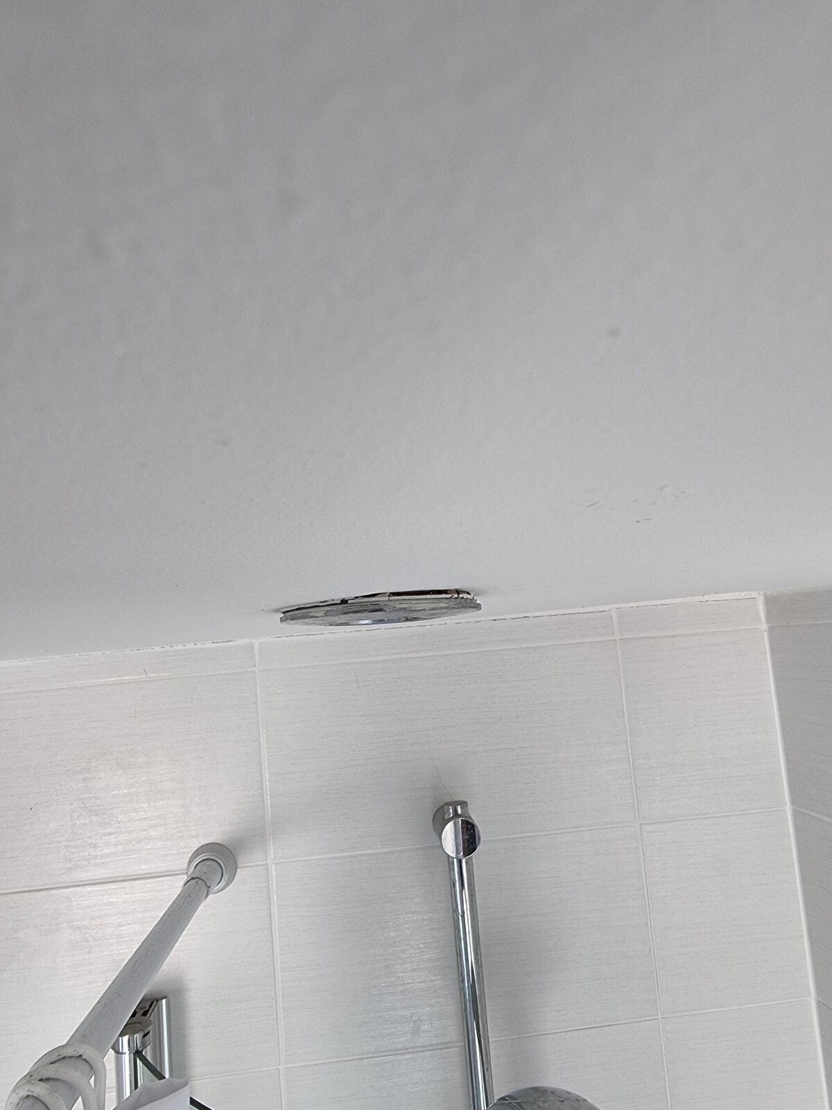

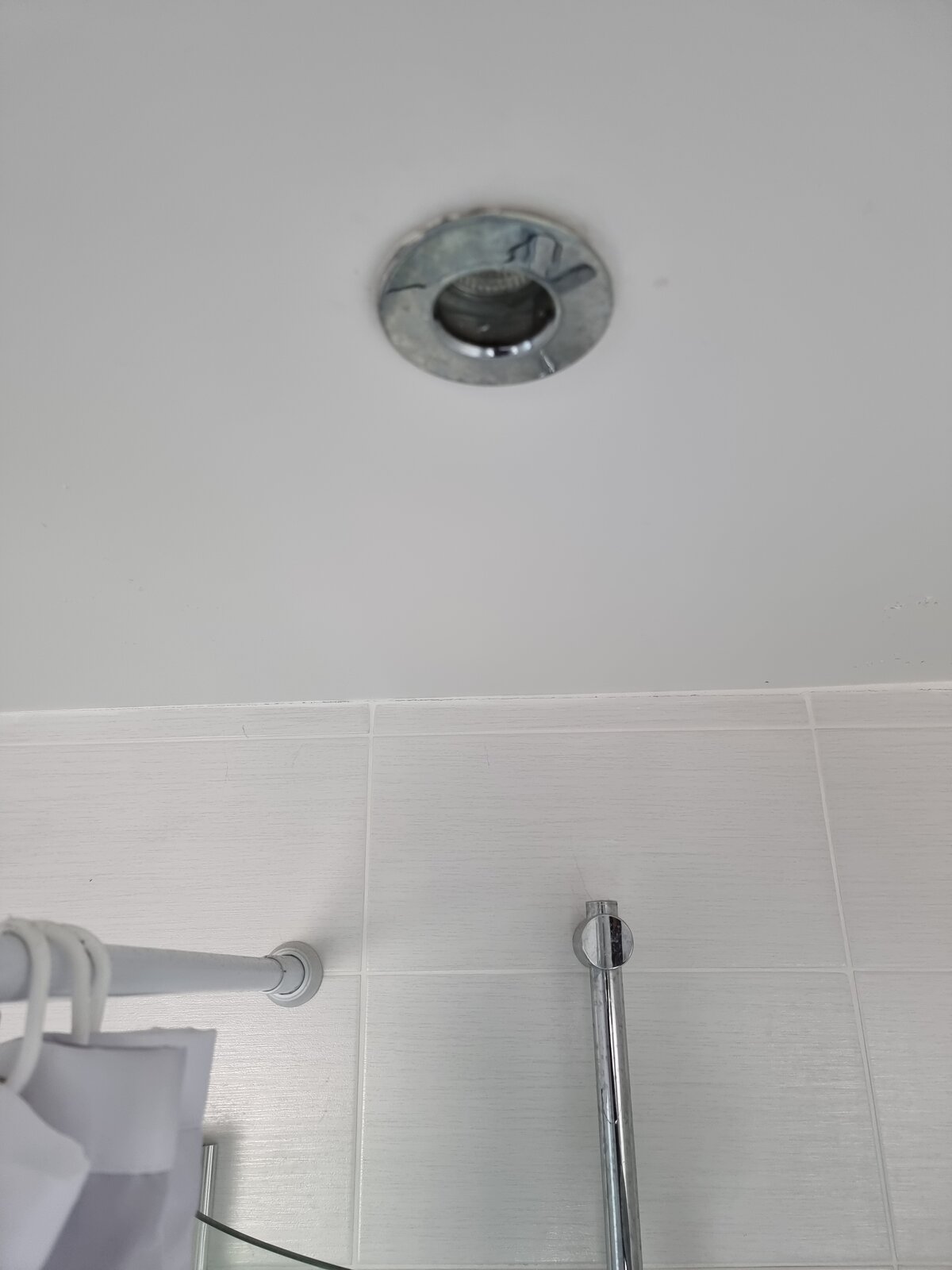

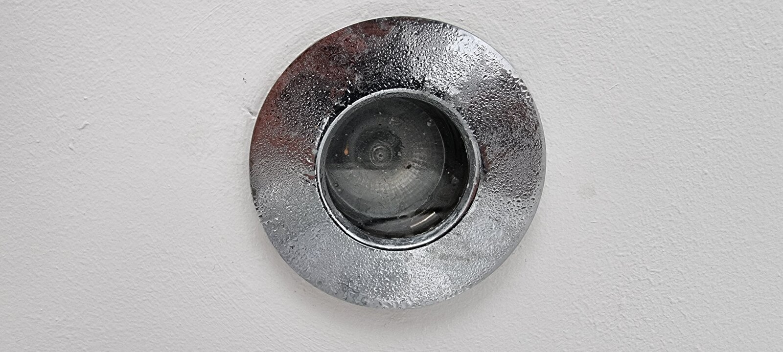

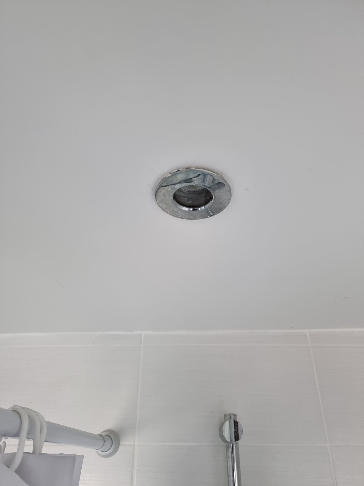

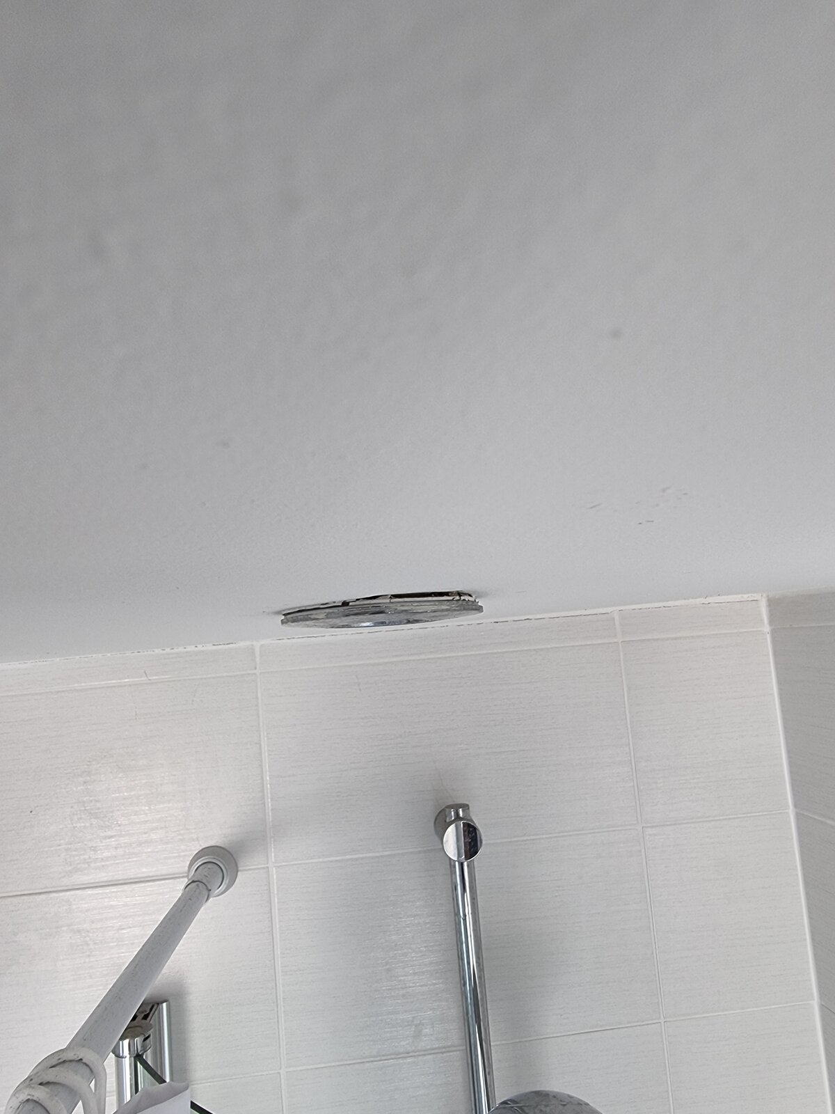

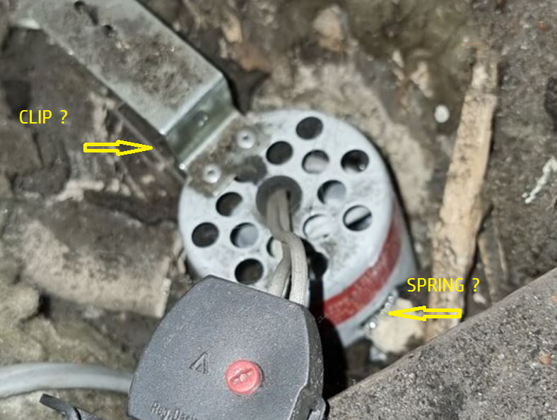

I have three spotlight type halogen bulbs in my bathroom and need to replace 2 (blown). Wasn't as easy as I thought it would be. I've never had these sort of lights before but I thought it would just be a matter of popping them out and replacing, it doesn't seem to be that simple.

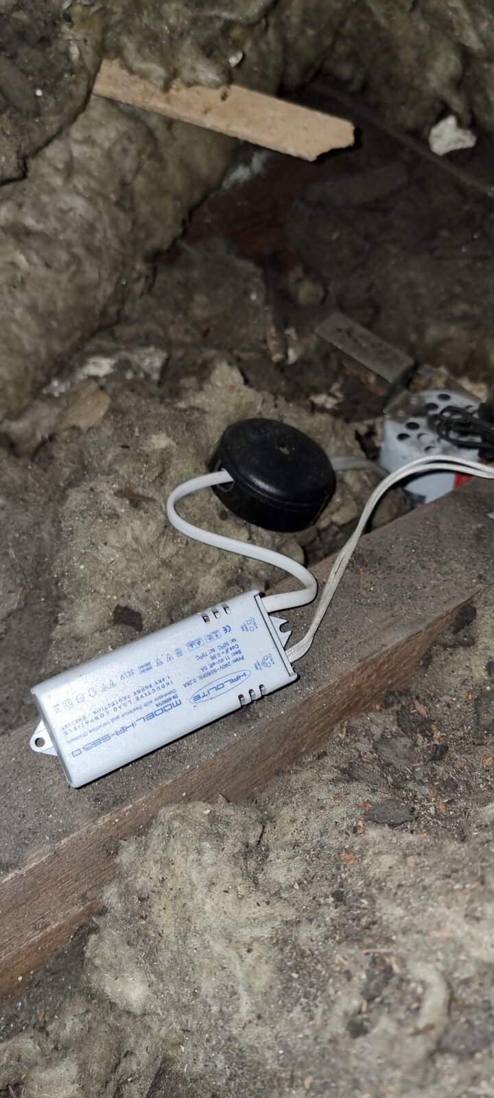

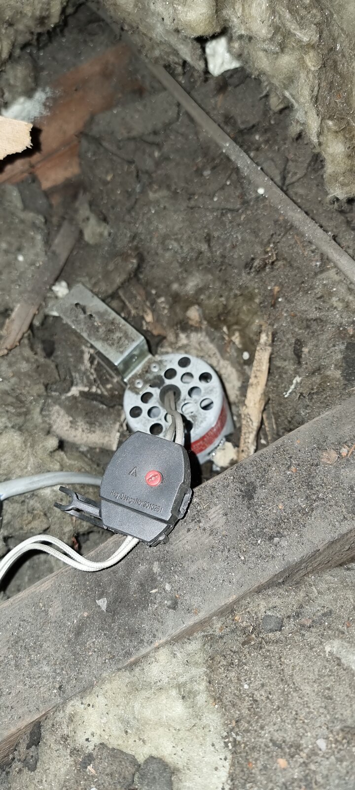

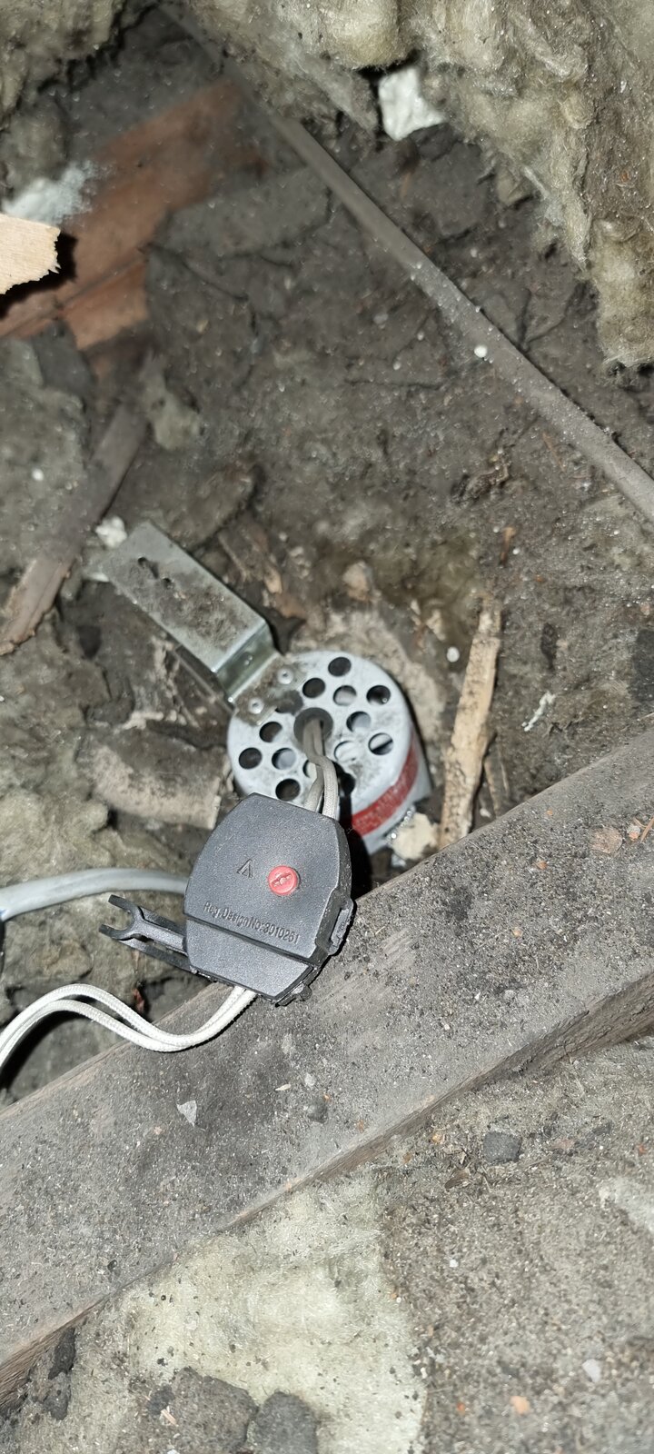

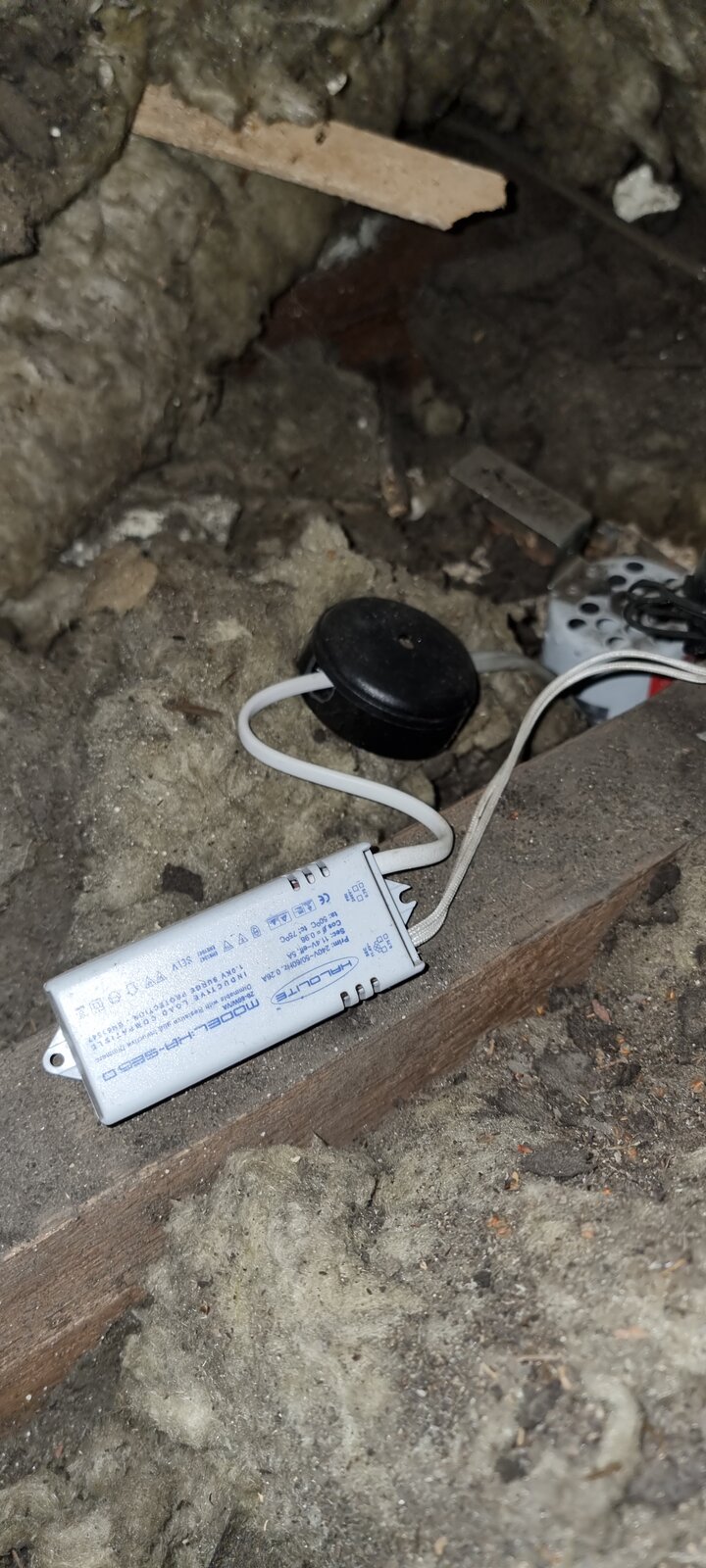

First I tried seeing if the silver piece on the front screws off, it doesn't seem to. Then I thought maybe the whole unit comes out so gave it a little tug but it felt like I was having to use too much force, so I stopped doing that. Then I went up in the attic to see if it came out there, and it did, but again, doesn't look like it's meant to be done there either.
Any idea on how to replace these?

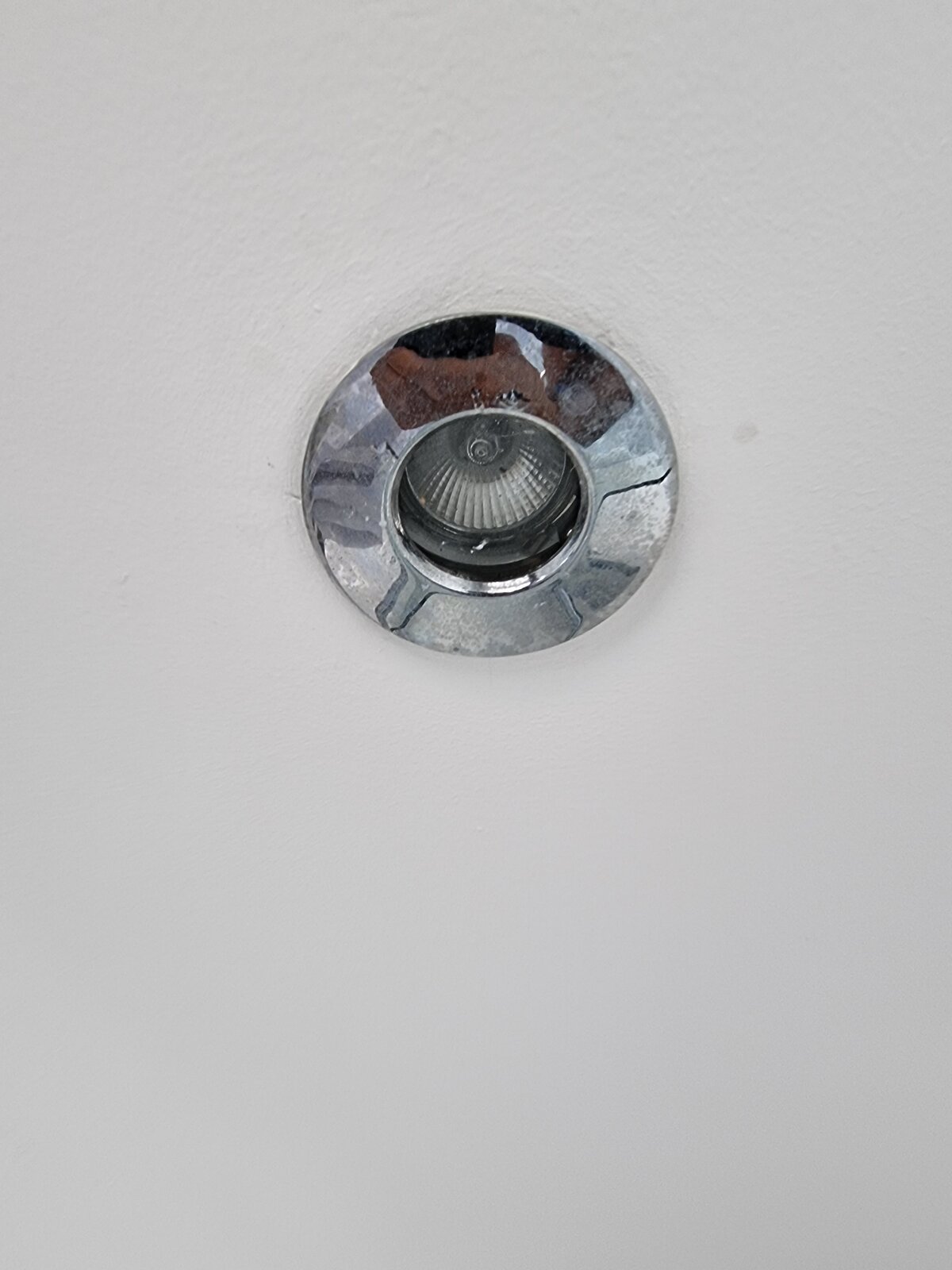

In your 4th pic you can see the 2 ends of wire clip that need to be squeezed together & pulled out to allow the lamp to drop down.

I can't see the clips you're referring to. Also there's a layer of glass right at the edge, the bulb sits behind that.

Sorry I thought I saw the ends of a wire clip, wrong again! I've not seen them before either, can you get a quarter turn on the cover to release them. I'm sure one of the other sparks will help you out later.

I did try turning it but that just seems to turn the whole unit.

@EFLImpudence has pointed out the clips, in theory they should simply pull out of the hole, in practice often there is too much tension on the clips and you need to manually hold then against the unit and pull well since in loft push out.

Just another guess, but removing the whole assy just to replace a lamp seems a bit over the top. Does the glass covering the lamp screw out?

Not sure what to do with this? :confused:
Do you think I need to somehow release the whole unit down into the bathroom buy unclipping something in the attic?
I would gently pull it down so its halfway out, enough to grab hold of the main body, you will be fighting against two spring tensioners though, they are what you can see in the loft, so will need a little force.
Mind they dont catch your fingers as it will hurt, if they snap back on you.
Whilst holding that body retry twisting the chrome bezel bit.
Sometimes the lampheat causes metal to expand jamming things together.

Also do yourself a favour and clear some of that crap from around the lights

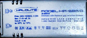

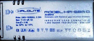

under model it says 20 - 50 VA this means can't use LED as too small, not enough load, so better renewing the whole thing and go to GU10 so no need for the electronic transformer, I would call them a power supply as far more in them than simple transformer.

Ok I somewhat gave this a try and then bottled it as I didn't want to crack the pain in the ceiling. But I'm going to try again as the chrome did very slightly turn.
Is that because these overheat?
View attachment 243834 under model it says 20 - 50 VA this means can't use LED as too small, not enough load, so better renewing the whole thing and go to GU10 so no need for the electronic transformer, I would call them a power supply as far more in them than simple transformer.
Is this a relatively simple task? Or is their a lot to consider compatibility and fitting wise?
