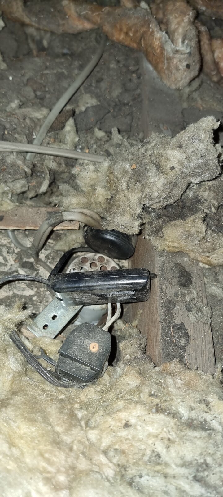

So I tried to twist the chrome bezel off and whilst it sort of spins, it doesn't seem to come loose. Think I'm going to have to take the whole thing out just to change the bulb. But thinking, as was suggested, maybe this would be a good time to switch them to gu10 if it's as simple as it looks/sounds.
Would something like this be the direct replacement for what I have?
https://www.toolstation.com/fire-rated-cast-ip65-gu10-downlight/p11096
Or is it a little more complicated than that?

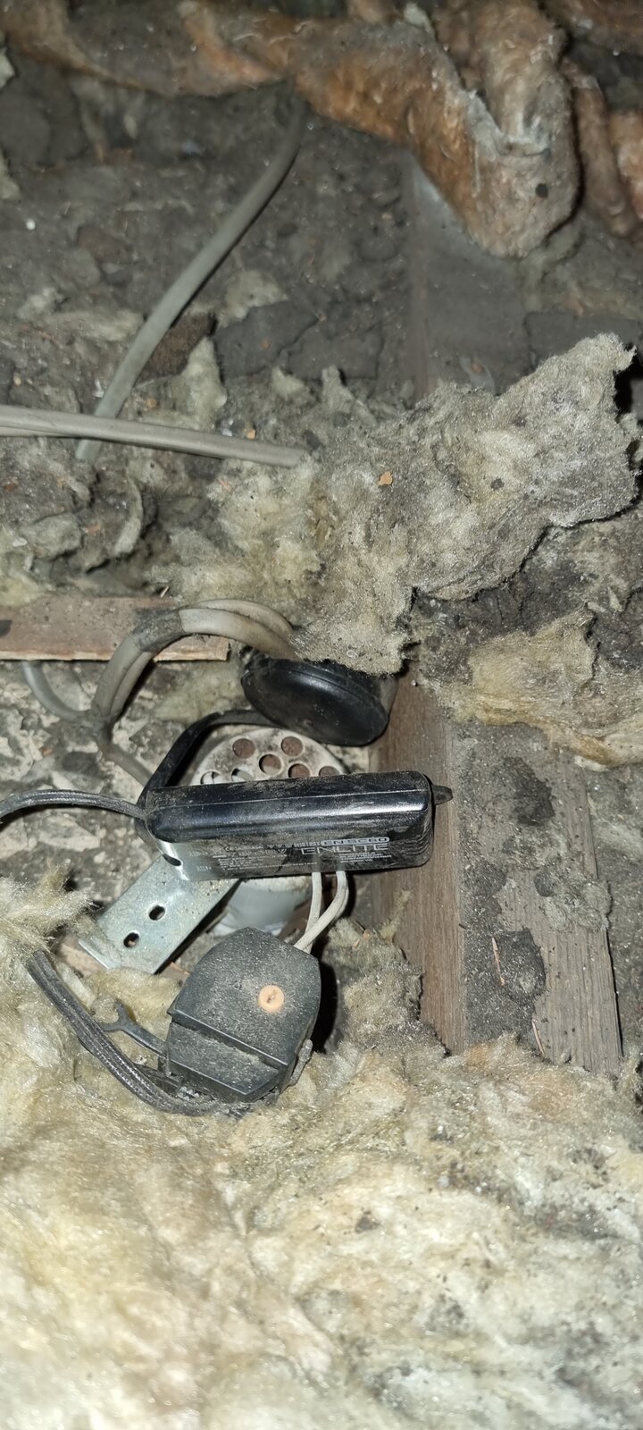

Just had a look at the other one from the loft and looks like it's cabled a little different in that, there's two mains power cables going into the power supply rather than just one like the other light.
Edit: just realised this is probably because the lights are linked, I think this one is the middle of the three .
well…the lamp is enclosed in a can, so removing the light from the ceiling still will not give you access to the bulb!
It might give you the chance to discover how the bezel comes off though!
If/when you change to mains downlights the Toolstation downlight you linked to is the sort of thing you need. The main criteria will be to select one that needs the same hole size as the old ones, or you’ll have to enlarge (not too difficult) or reduce (almost impossible) the size of the hole.
Yes. When you change to 240v lights, just run a short length of mains cable from the junction box to the new downlight.
