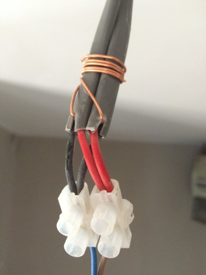

By all means I'm no electrician. I'm changing the spot lights in our house from halogen to LED. I have the GU10 fly leads (converters) but when I take down the old halogen leads and affix the new ones it doesn't work.... What am I doing wrong? It is literally just 2 small black wires L &N coming from our ceiling so I'm stumped... Help

The other issue is I have 2 lives and 2 neutrals running to the existing transformer
OK. So you need to put the wires from your new LED holder to replace the blue and brown wires in your picture. Leave the black and red wires as they are.
Whoever did that was not an electrician......Those bare wires should have green&yellow earth sleeving on then and should also go into a proper bit of terminal block.
I hope that the terminal block was inside an enclosure? If not you need to get some chocboxes as the connection must be enclosed inside something.

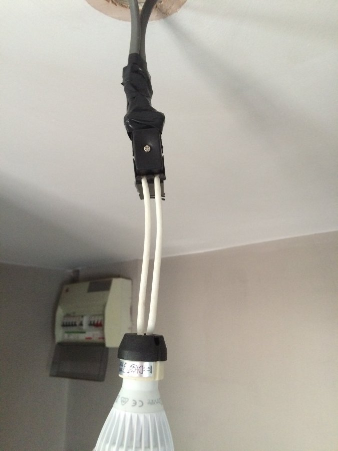

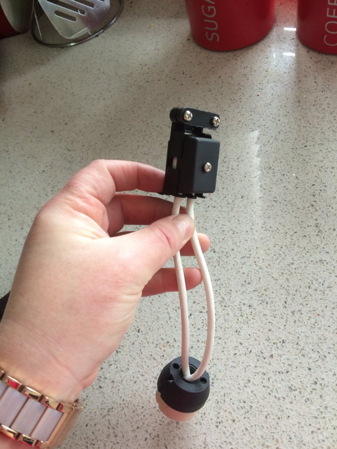

Whoever did the electrics in this house is an idiot. I've got the power off and the light turned on. They weren't in chocboxes but I've bought gu10 leads with them attached... See picture. They just had loads of insulating tape around
And last question I promise (thanks for your help) I'm guessing the copper wire wrapped around the upper two mains wires will need to have insulating grape around
