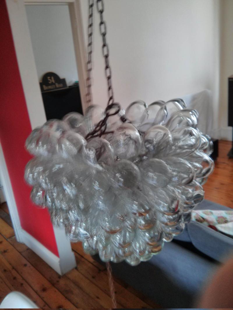

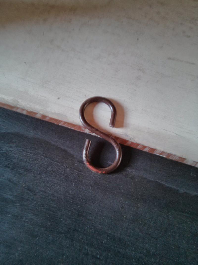

Here are some pix. The chandelier weighs about 10Kg. The cable wraps around the chain
There should be a metal bracket in the cup that attaches to the ceiling - is it missing?
