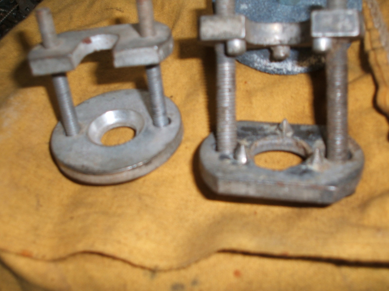

Incidently, they came with black plastic pots and seals all done in the factory.
Compression tool on left is for the plastic compression pots and seals I mentioned earlier, on the right, the conventional compression tool for brass pots.
