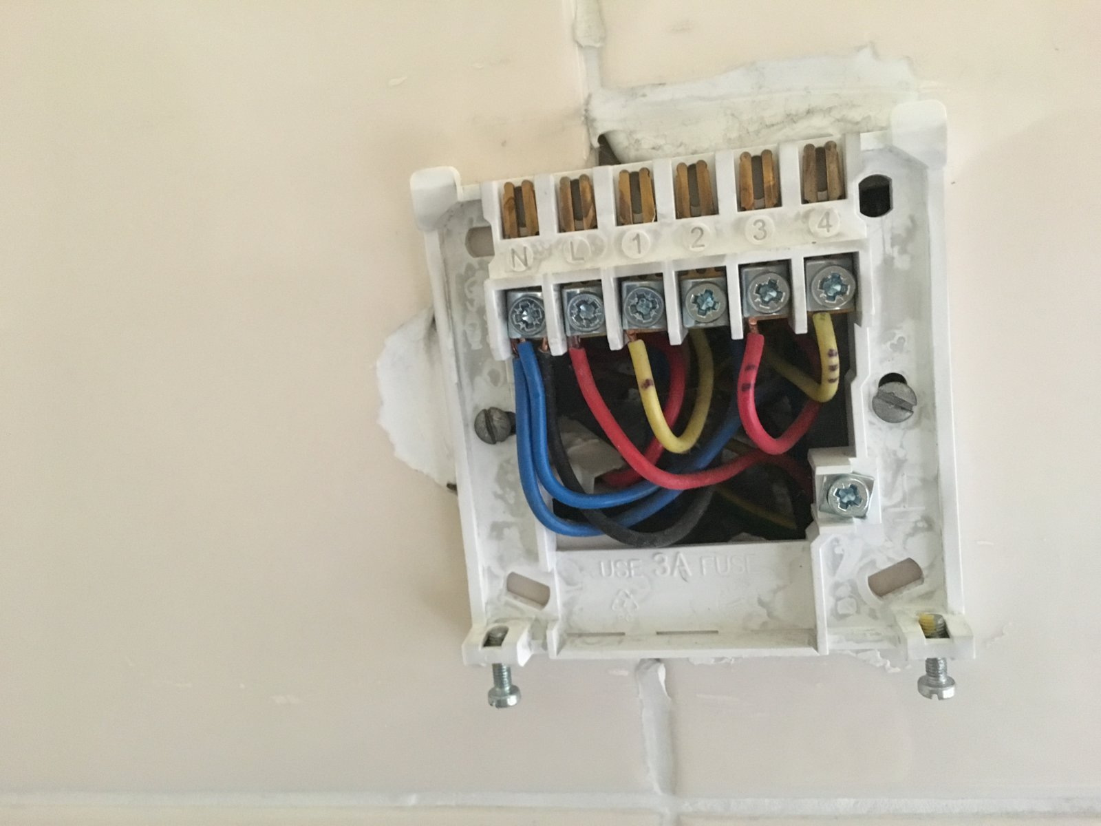

hi,
I’m trying to install a hive which replaces an up2. I have wired up like for like but the heating does not operate.
There is a red and a grey wire terminated into a block behind the up 2 which I can’t help thinking should be used for something.
I terminated all wires at the thermostat with tape.
Any help greatfully received!
Rob.

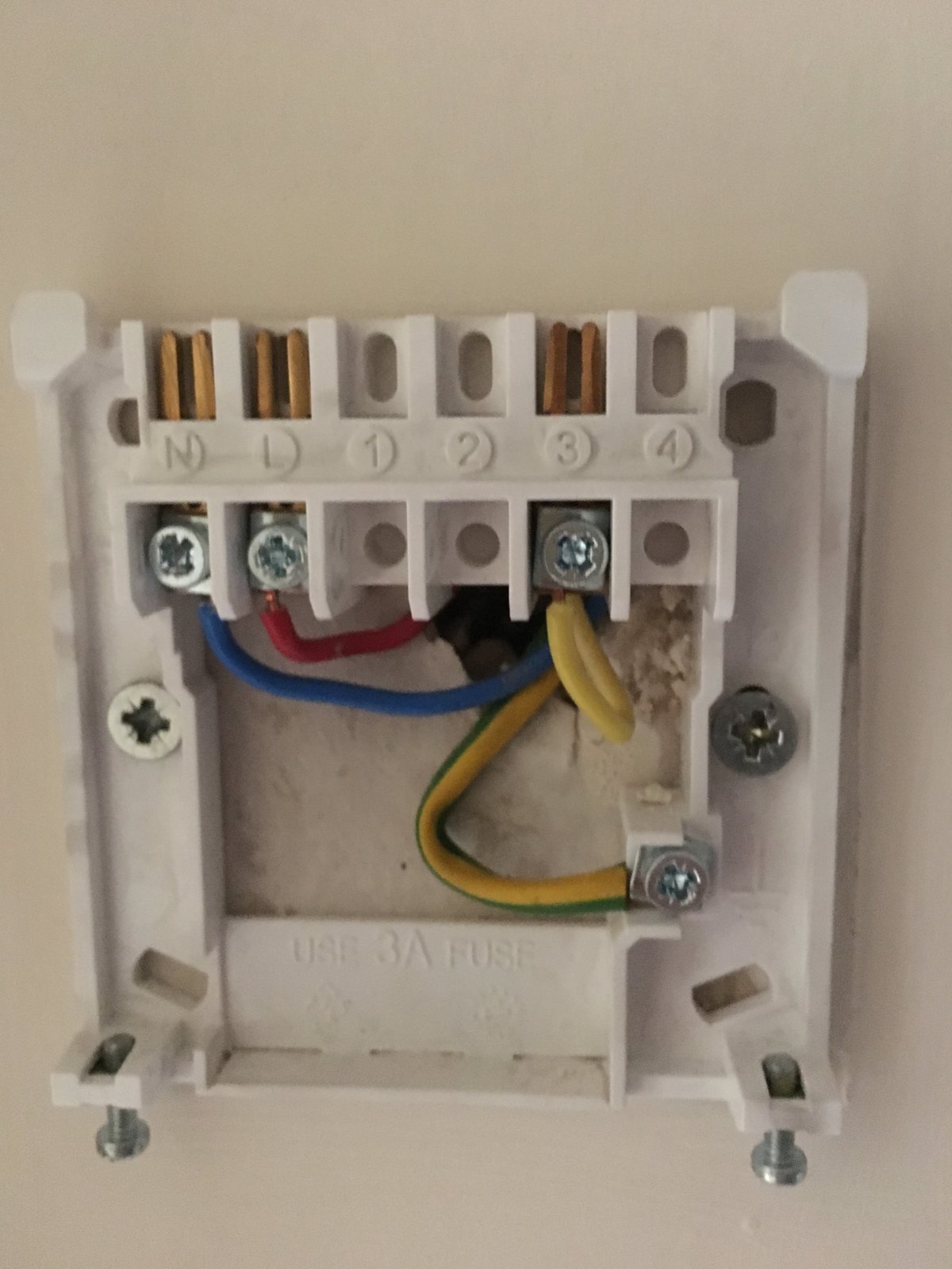

I'm assuming that the second photo is the original thermostat and that you have disconnected the wires at the other end. If so, I hope you can remember exactly where they were connected.
The old thermostat can't simply be disconnected as this leaves the heating wiring 'open circuit' and it will not operate, so the integrity of the circuit needs to be maintained.
1. The Red and Yellow are the two switching wires, and Blue is a neutral wire.
2. You have already traced the thermostat cable back from the thermostat to its origin, so know where the other end of it is.
3. Normally I now say take take a photo, or make a note of where the Red and Yellow switching wires are connected at their origin. As you have disconnected them, I hope that you can remember where they went.
4. Disconnect all of the wires from the cable going to the old thermostat and remove the cable and original thermostat. All other wires to the same terminals remain in place.
5. Insert a wire link between the terminals where the red and yellow switching wires have just been removed from, so that they are now electrically joined together.

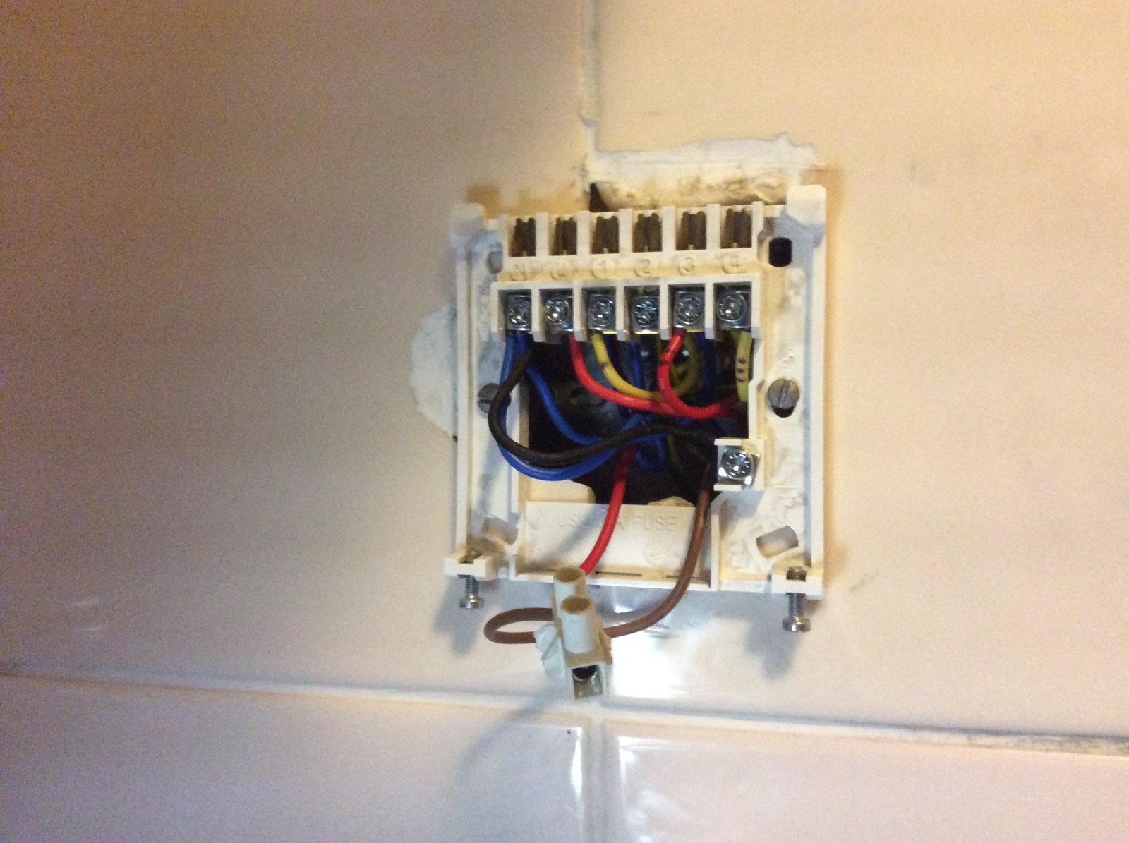

Thanks for your reply. Apologies as my original post was not clear!
I tried to install hive but as the heating wouldn’t work, I’ve reverted back to the original up2 set up and the photos are both the original controller and thermostat so nothing is not disconnected or taped. This is how it looks now.
The two extra red and brown wires go into a terminal block together as per the new photo and are currently unused. These are at the controller end.
I don’t know which wires are for the thermostat as I can’t trace them due to the amount coming into the main controller.
I hope this is a bit clearer.
Thanks again
You will see that the Dual Channel version of the Hive and British Gas up 2 are a straight swap, their terminals have the same functions, like for like. So don't worry about the extra wires behind they are just terminated there, and shouldn't be changed.
You can get around removing the original thermostat ,it by putting the Hive back in place of the up2 as before, then at the thermostat take the red wire out of L and put it in terminal 3 along with the yellow wire. Obviously the old thermostat will have to remain in place as live wires are present, but it will no longer have any control of the heating.
The only way to get rid of the original thermostat completely would be to trace the wire back to its origin and add the link as per my original post.
