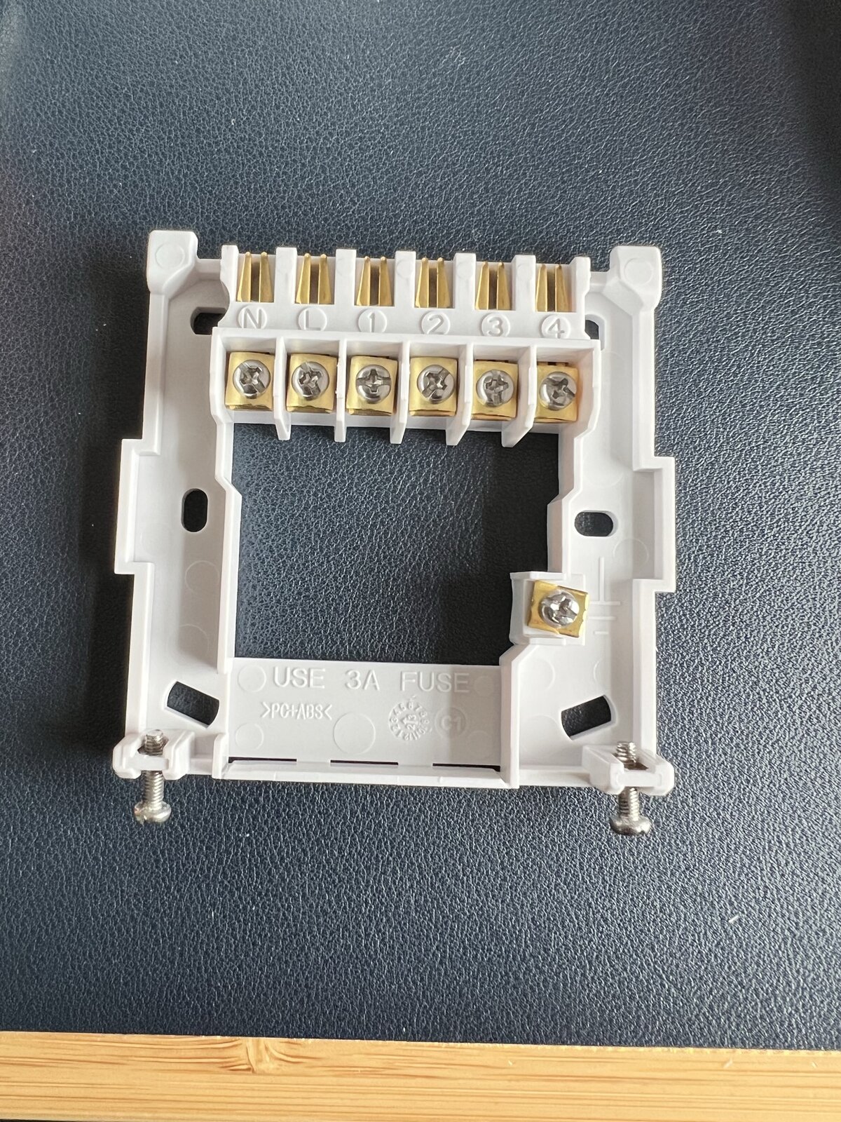

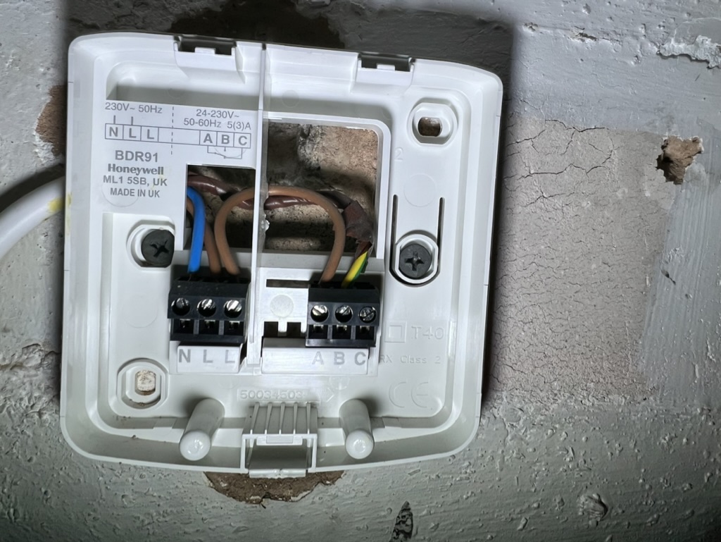

I have just brought a hive and need help with how to wire it up to my existing system
can someone please tell me where to transfer the wires in the image attached : N L L A B
Many Thanks

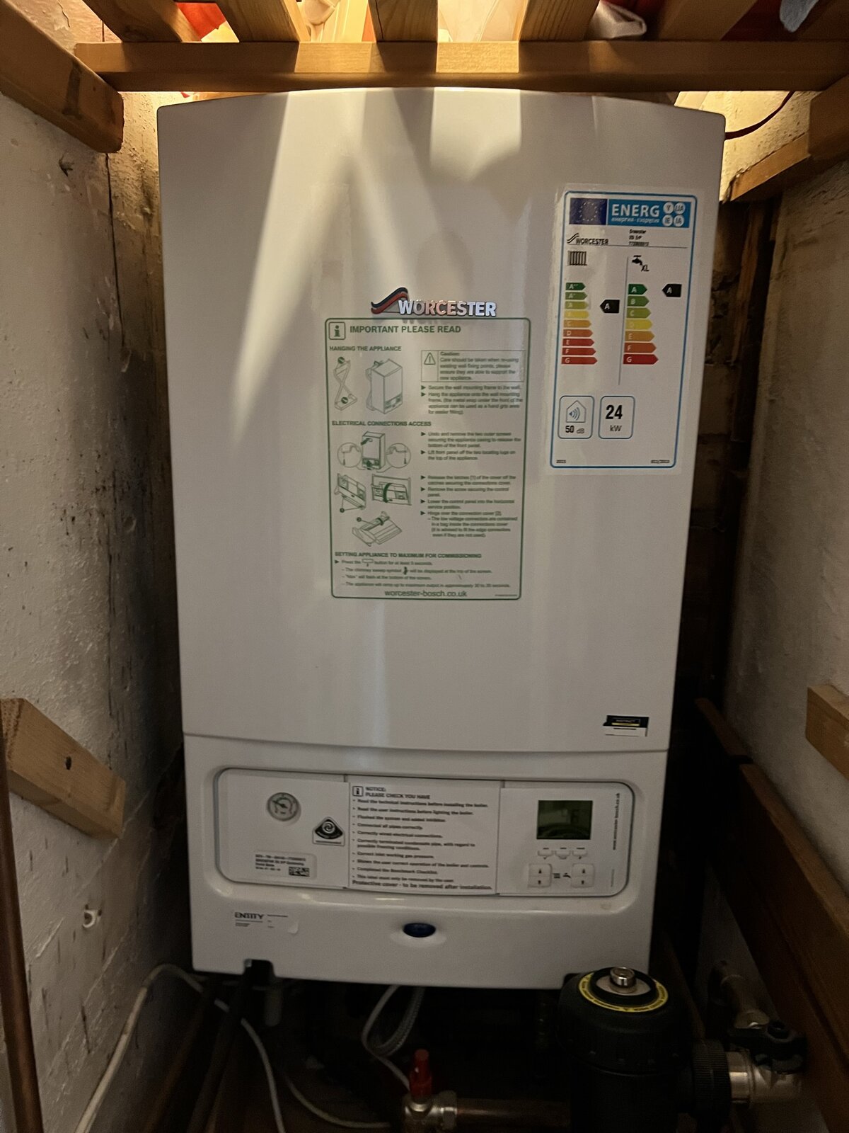

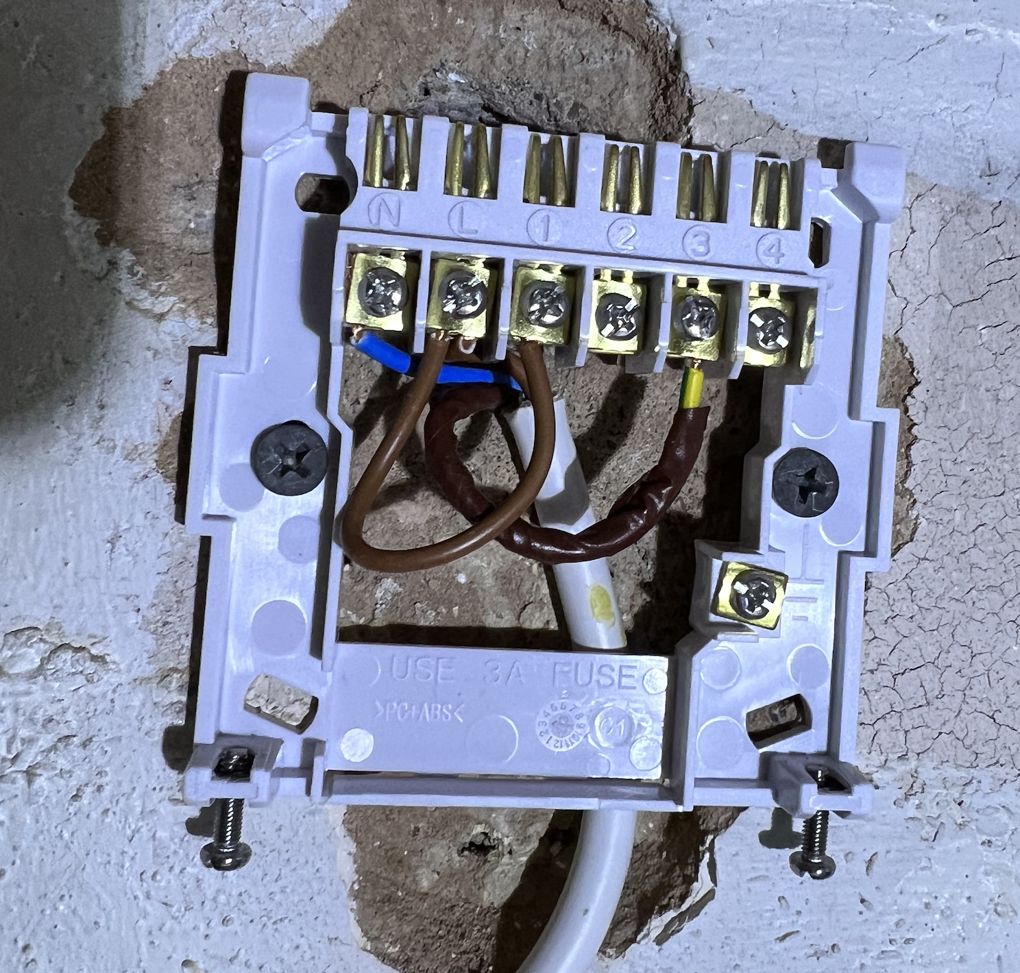

So have you bought a 2 channel version? Do you have a combi boiler? Oh dear another where they think the CPC/earth can be used as a switch live, granted they have taped it brown.

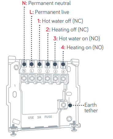

Ok, so you look like you've purchased the correct one (wiring diagram earlier is different).
Transfer as follows:
L to L
N to N
Link that goes from L to a now from L to Com (1)
B to heating on (3)

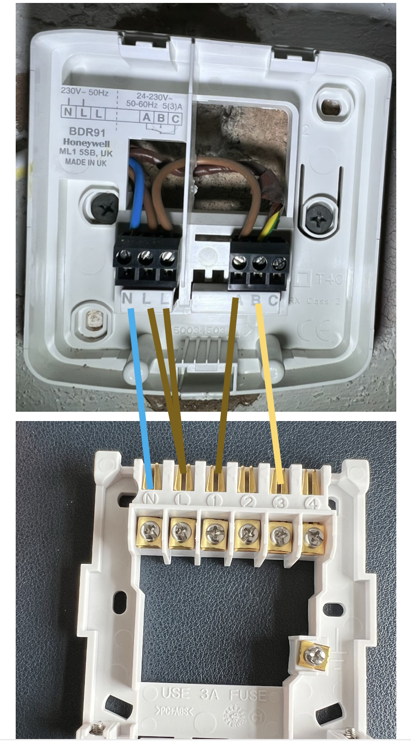

So to confirm configure it as I have done in the attached image?
As attached
