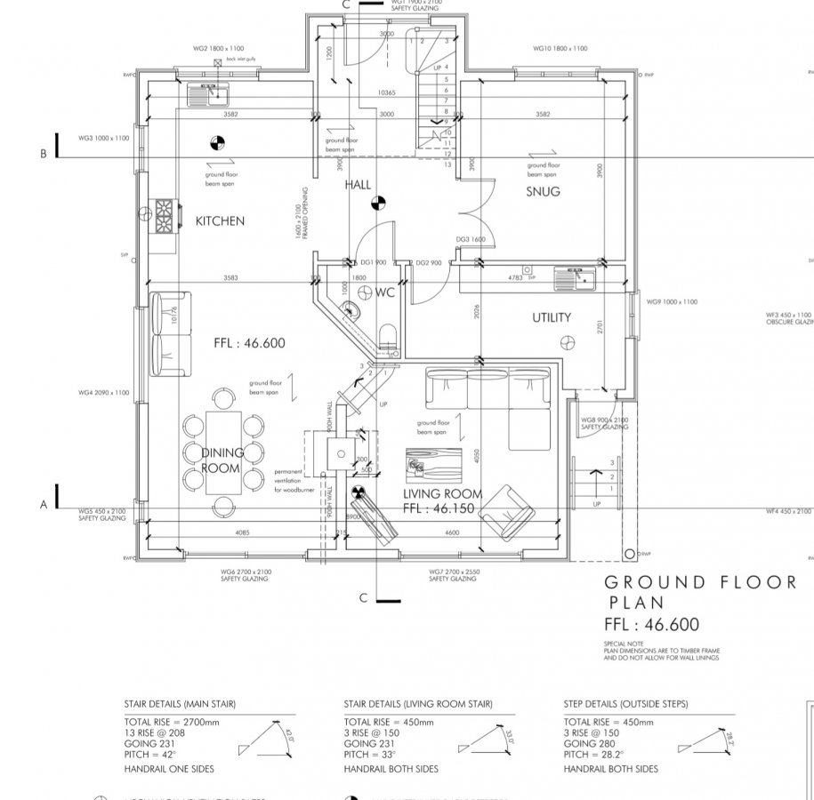

About to start a self build property that has an open plan ground floor with a sunken living room and 900mm high dividing wall with dining room The floor level in the living room drops 450mm and the steps have 3 rises of 150mm. The architect has specified that a handrail is needed on both sides of the steps (Over 1000mm wide stairs) but this will totally ruin the look / feel of the room as part of the dividing wall is a 3 sided fire that will have an ugly handrail running along side it. Is there any way I can avoid having to put in both or one handrail?

Why the sunken living room? Surely this introduces sub-DPC tanking issues as well as that awkward set of steps?
Can we have a peek at the A __ A section drawing please?

I agree with fmt. I doubt that there's a BCO in the land that would insist on a handrail here (and both sides is frankly bonkers) - knowing full well that you'll just remove it once they've gone. I would be more concerned about the proximity of the WC pan to the return wall, and the (apparent) lack of fire compartmentalisation - although, a BCO may suggest that this can be addressed with alarms and/or suppression.
The step down to the living room is for 2 reasons.. A) to follow the site slope B) to create some more interest in the house layout
