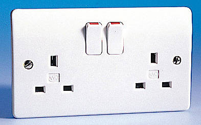

I'm just saying that from the technical point of view, it makes no sense to say that you can put one of these at the end of a spur cable:
But that you can't use two of these next to each other in a grid with a few inches of wire linking them together:
In my book, and according to the regs, a spur cannot have another socket connected to it.
I agree that if we take "double socket" (assuming that's still the term used in BS7671?) to mean only "a unit manufactured as a single device containing two socket outlets," then by a strict application of the rule two single sockets as above would not be permitted.
I was just observing that you yourself, perhaps subconsciously, talked about linking two devices to "make it a double, rather than two singles" in the context of the two single devices being mounted right next to each other in the same box. If there is no specific definition of what is to be considered a double socket for the purpose of the rule, couldn't such a unit be considered to be a double socket?
Whilst I agree with TTC's interpretation, and also John's reasoning, it can be seen from the picture I posted the other day that double sockets are indeed connected in the same way as these proposed Twin single sockets, albeit with a piece of metal rather than a wire.

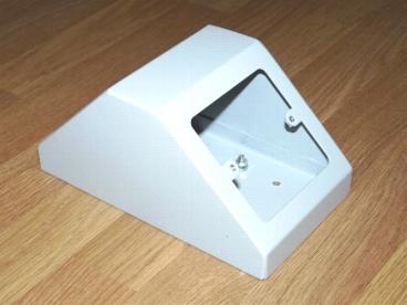

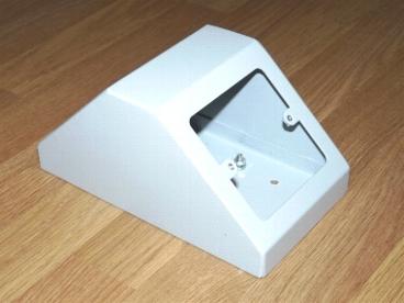

But when we're talking about two single sockets which are mounted right next to each other in the same box, can anyone really see that from the point of view of what somebody might plug into either or both of them, it's any different from just having an all-in-one double socket at the same location? And what exactly is a "double socket" for the purpose of this regulation? In the absence of something specifically defining it, I think a pretty good case could be made for saying that two modular single sockets fitted on a grid and mounted in the same box become a double socket. Or indeed two single sockets mounted together in any combined enclosure, for example:
Double socket-outlets are defined in BS 1363. Your pair of singles differs in that it isn't type-tested to BS 1363 as a dual socket-outlet.
From what has been said (over the years), that type-testing, surely, is satisfied with them being less good than two singles.
