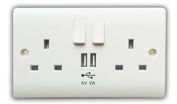

And I just had another thought while pedantry about what may or may not be connected to a ring spur is being debated. Not that I'd ever want to use one of these things myself, but does BS7671 allow you to put one of these on a spur? It's not just a double socket, after all.....
Not just a double socket but only has one set of terminals
Oh I see. Well I don't think many of them will actually pull 4.2A across the two USB ports, I think it's limited to 2.1 shared generally. The better quality ones might be a bit meatier.
And wrt that query I'm not too sure. I don't think they're mentioned at all are they? If it confirms to 1363 it must be allowed
Do you have in mind (surely not) that it may be a quadruple socket and therefore not allowed?

No, but as far as the 240V side is concerned it's a double socket plus a power supply for something else, not just a double socket.

What is the exact wording about what may be connected on an non-fused spur?
That's probably true, but even if they could supply 4.2A at 5V, that would only represent about 91 mA (ignoring inefficiencies/losses) drawn from the 230V supply!

I doubt he means that, but ... if there were a socket (double or single) on an unfused spur of a ring final and someone proposed connecting ('spurring off') a USB charger (or anything else, come to that) to the supply to that socket, would you not tell them that such was 'not allowed'?
BS7671 itself is totally silent on the matter, other than saying that "ring finals, with or without unfused spurs" may supply accessories to BS1363. It is only the guidance of ('informative') Appendix 15 which talks about "only one (single or double) socket" on an unfused spur.

I just checked the spec and even MK's only draw 2A shared. I have an MK and it's great, wouldn't use any other brand for fear of burning my house down!
Ah, thanks, I'd forgotten we'd already discussed how that had changed in the current edition. So if that's really only a suggestion, and there's no actual definition of what BS7671 considers to be a double socket anyway, I would have thought that anyone could wire two singles in the same box together and quite definitely claim compliance with BS7671, and possibly even compliance with the "informative" appendix suggestions as well.
