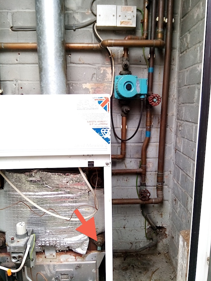

This problem started after I've drained my CH system. I drained the system via my radiator. Not from the boiler, as the arrow the picture below.
Should i try to drain it from the boiler (as the arrow in the picture) instead? Due to any blocked or airlock.
BTW all the CH heating is working but not the HW.
Turn your CH off and HW on, turn your boiler thermostat to MAX this might force the air out of the open vent.

Yes it is. It has pipes that go to back boiler before, which I capped it. And also one radiator always get hot when the HW is on.
