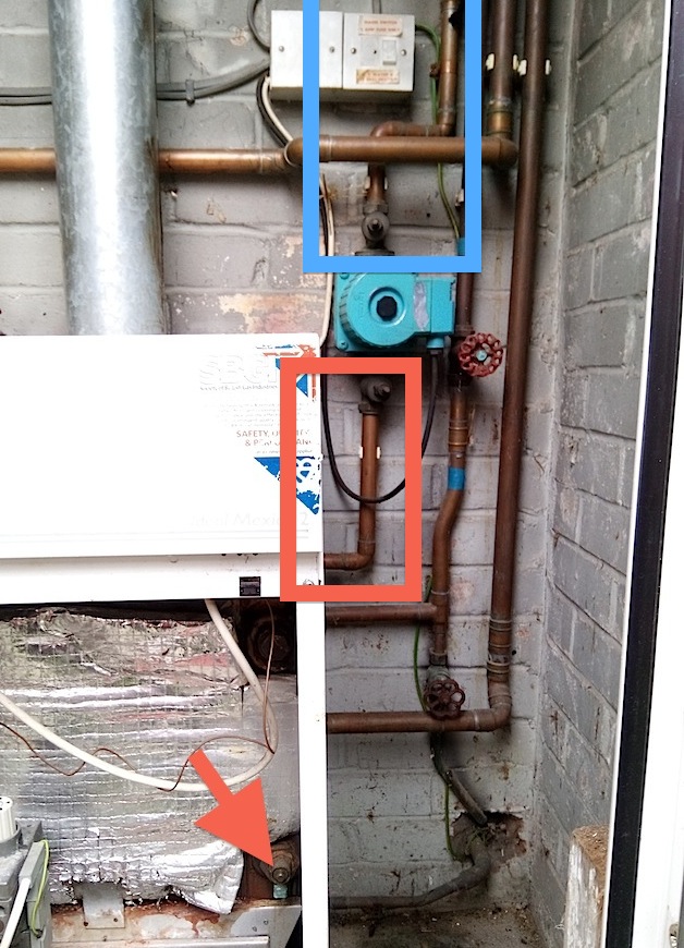

I turn the HW on and it ignited for a couple of minutes. As the picture below, the flow pipe, which is in the red box get a bit warm and the blue not warm at all. Could this be the pump is not working?

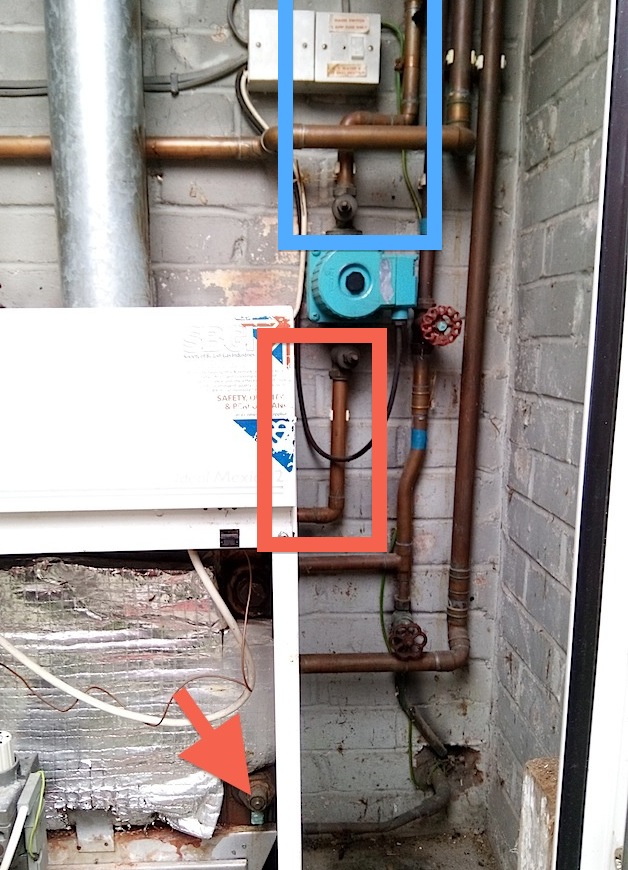

NO because that is your heating pipe, the pump does not work when you just have hot water on. the pipe in your blue box will get hot only when you have heating on also.
Looks like you've blown something, has the controller, (or anything), worked since you took the pump apart? That pump has nothing to do with the hot water side of your system. All the pump does is shove hot water from the boiler around the radiators when the CH is switched on.
Secondly, the heat sink rad in the toilet, is this getting hot since you had no hot water? The HW circuit relies on gravity to circulate, if it is blocked or air locked, circulation will not happen, hence you've no hot water.

The heat sink rad doesn't get hot at all. If you refer to the picture above the thread, which I've drawn the blue and red box, it only gets hot with the red box and the fire dies off.

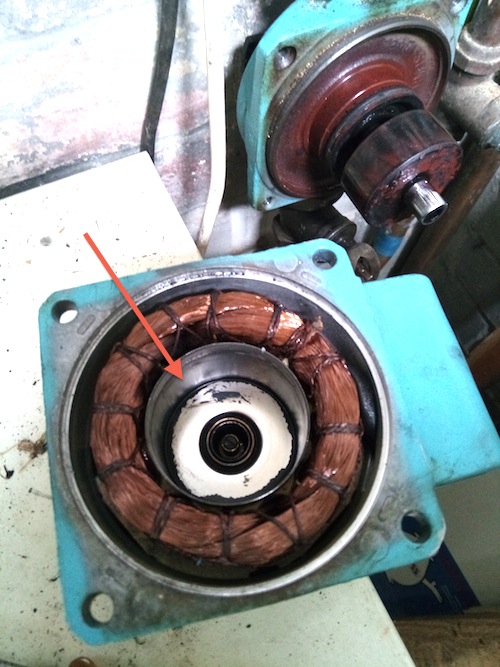

If the controller died when you turned the CH on then I suspect you've done something to the pump which has blown the electrics. Your HW issue has due to a blockage of some description in those 28mm primaries, assuming there is enough water in the system. The toilet radiator connected to the HW circuit, when you bleed it, do you get a fairly strong jet of water come out or just a slight dribble?
You spot it right. Because I just opened it again and found some water in it, as the picture below. You I think this pump can't still be used after i dry it up?
Now i remembered I think i didn't close the bleed nut tight and water leak into it.
Im not sure if your still thinking that is part of the HW circuit, its not its your heating flow so you wouldn't expect it to get hot above the pump unless your heating was turned on.
