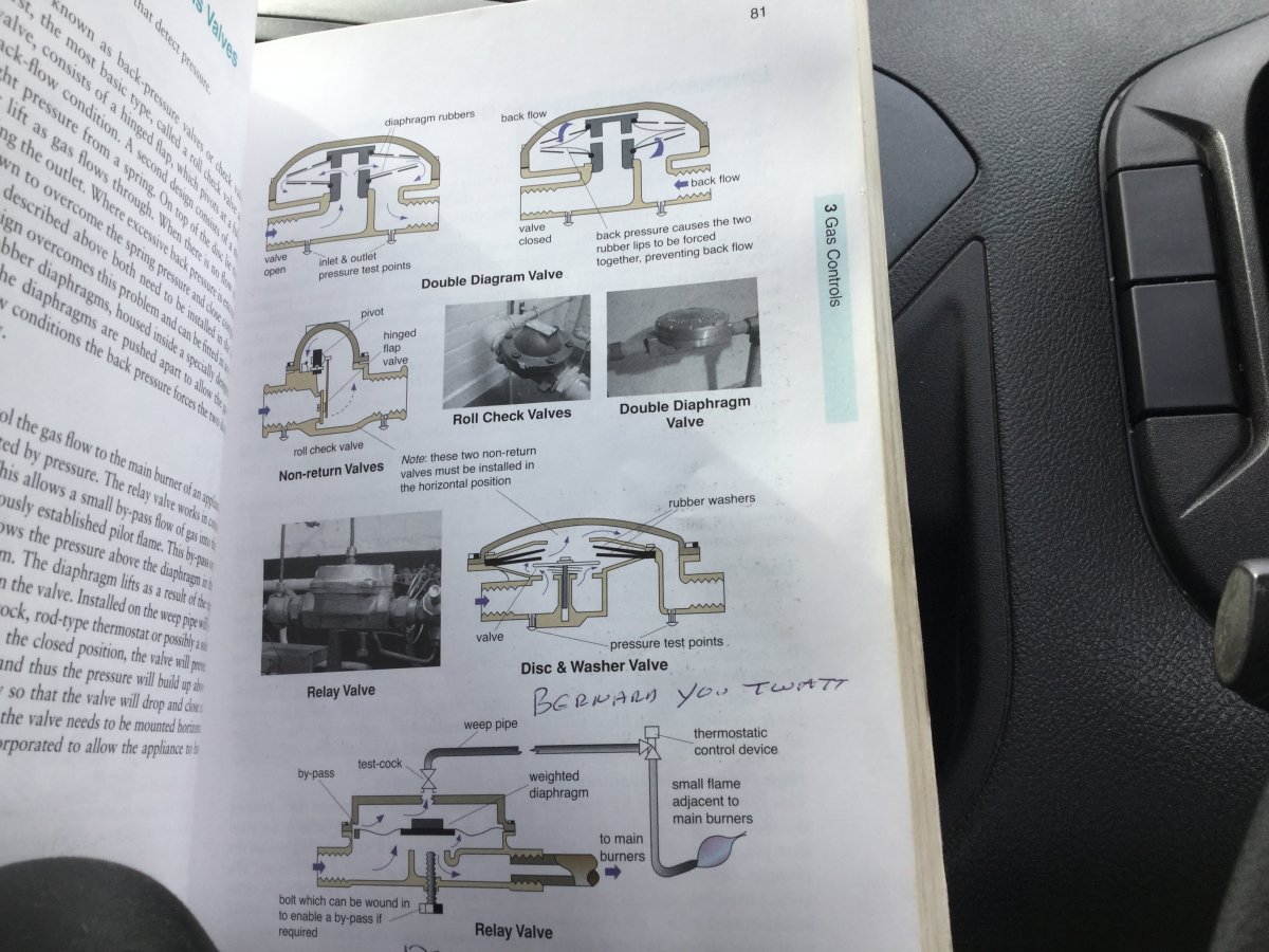

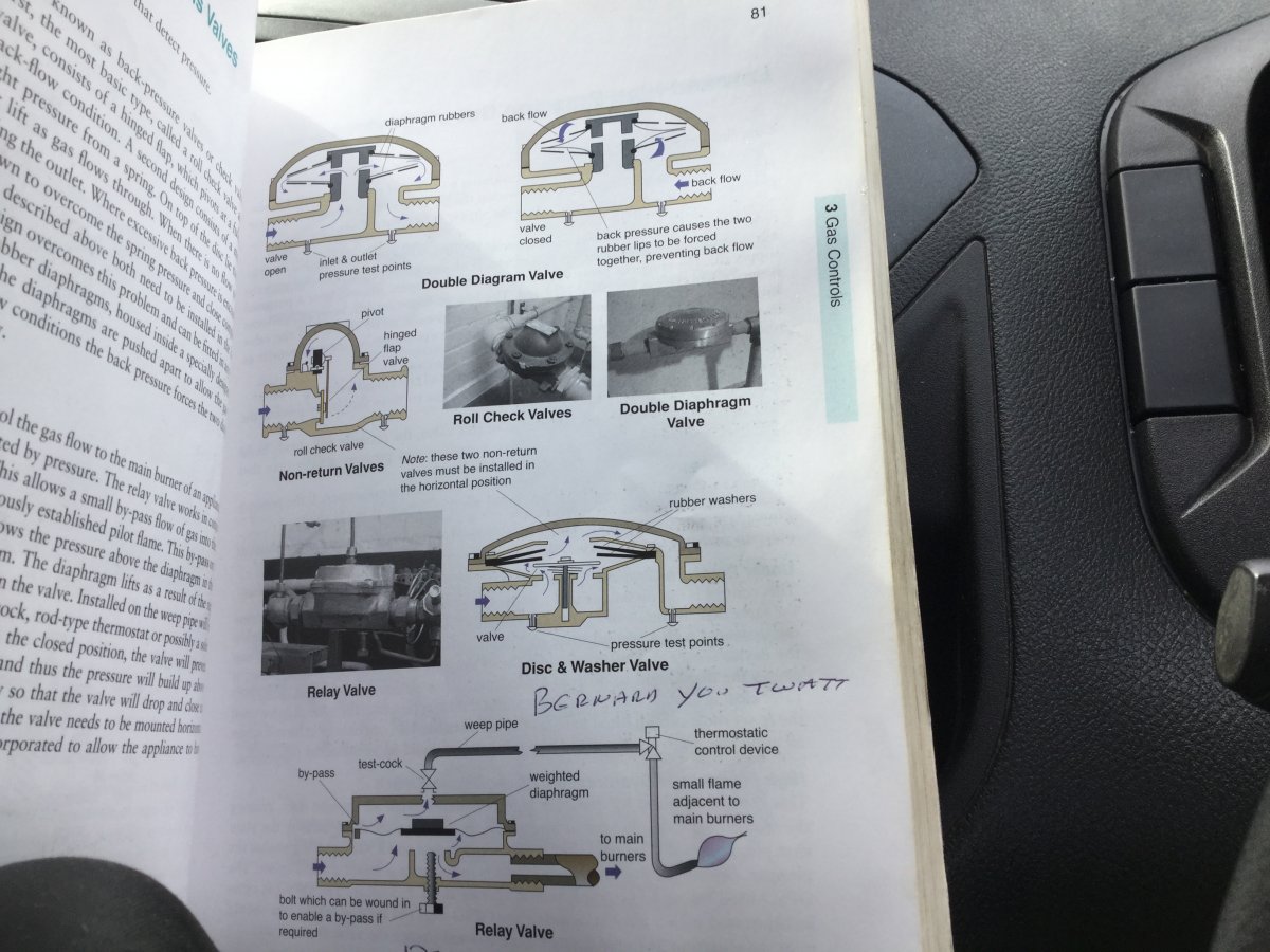

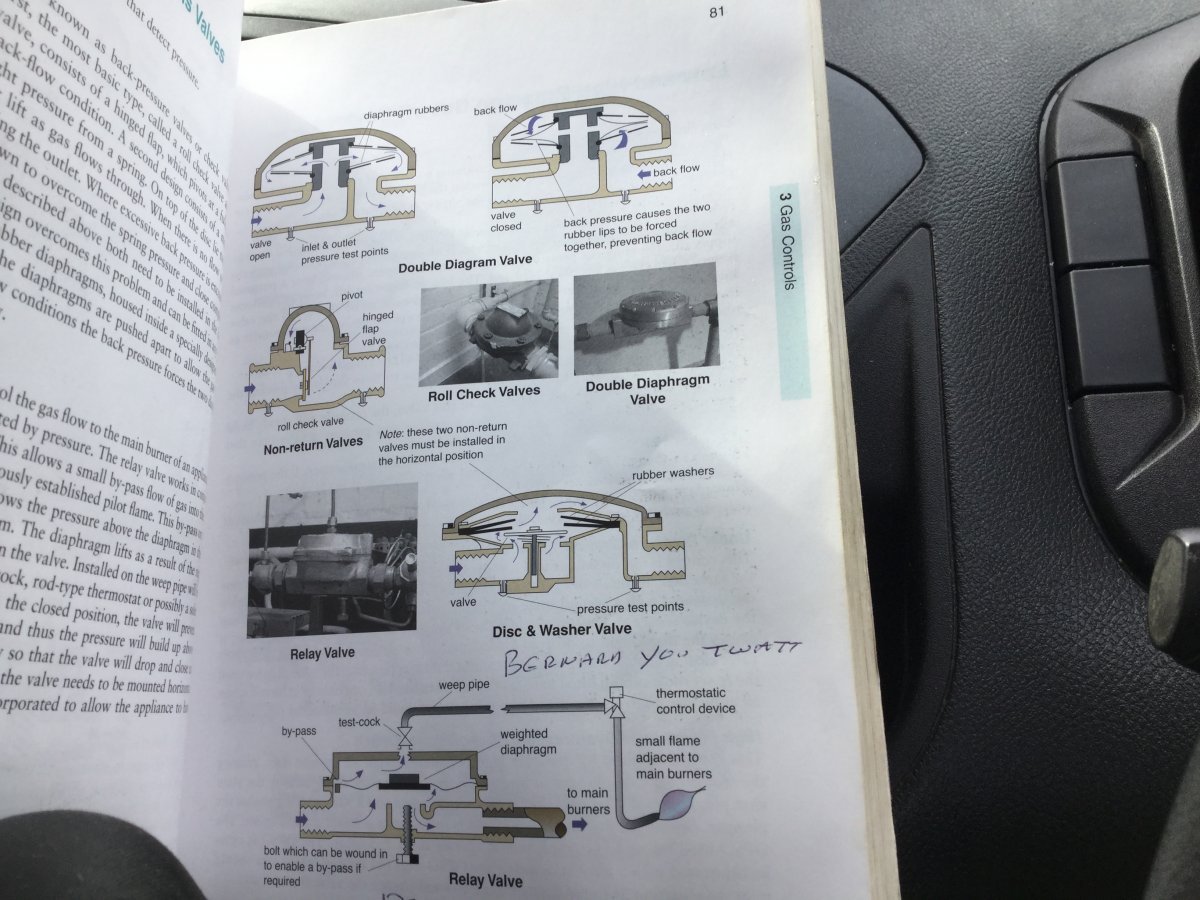

Just in case Bernard failed to read the note I left for him I'll post the picture again...:ROFLMAO::ROFLMAO::ROFLMAO:
You even spelt tw*t wrong. :LOL:. Stop now before you dig yourself in deeper. Note in your book where is says `thermostatic control device`! Look what gas line it is in. This is such fun.
First you deny there is such a thing as a gas relay valve controled by gas flowing or not flowing along a weep tube.
Then when you are shown an image of the valve and text explaining how it works you recall you have a copy of the very book.
And apparently you have had the book from a date before it ( second edition ) was published.
It is clear to see the page 81 of the book has not had the wear and tear the front cover has. ( until some one wrote a rude comment above the diagram of the valve )

I don't recall saying that a relay valve that utilises a weep tube doesn't exist?..maybe you can highlight where exactly I wrote this?..I will admit saying that a room stat utilising weep tubes would be a figment of hard-ons imagination.
Stop digging yourself into a hole. Just apologise and move on. You described Relay Valves and weep pipes (which you had never heard of) as bol!ocks. And Bernard and myself are not GasShark registered either. How can this happen! Now you can into that Combustion Chamber thread of yours and tell them all about gas relay valves. Get back to us when stuck.
Then a copper weep tube from the boiler thermostat to the wall thermostat which was variable action.
Then a weep tube from the wall thermostat back to the boiler and into the burner box where the tube terminated at the pilot light. It looked like there was two pilot lights inside.
Gas went through it all, right to the living room. The bigger the small flame at the burner the more the two stats were open..
Now this is what I was referring too as "a load of bo!!ocks"...:ROFLMAO::ROFLMAO::ROFLMAO:
