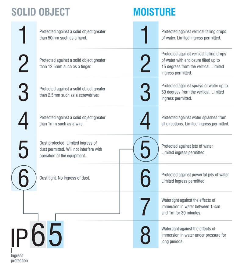

This: https://www.tlc-direct.co.uk/Products/SMSL3DG.html
It is IP65 rated so should be suitable for outside use, but it is under the "Indoor Lighting > LED Wall & Step Lights" section of TLC's site and the manual says: "IP65 Rated suitable for restricted external applications".
What is meant by restricted?
Regards: Elliott Veares.
Resists most water but not that from a hose directed at the light
That some outdoor environments require greater than IP65, so they can't give a blanket "suitable for outside use".
