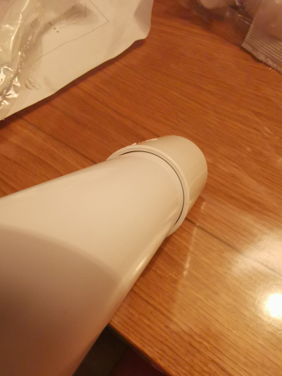

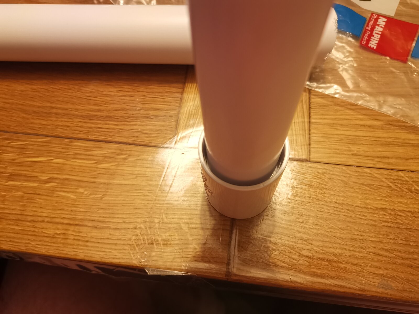

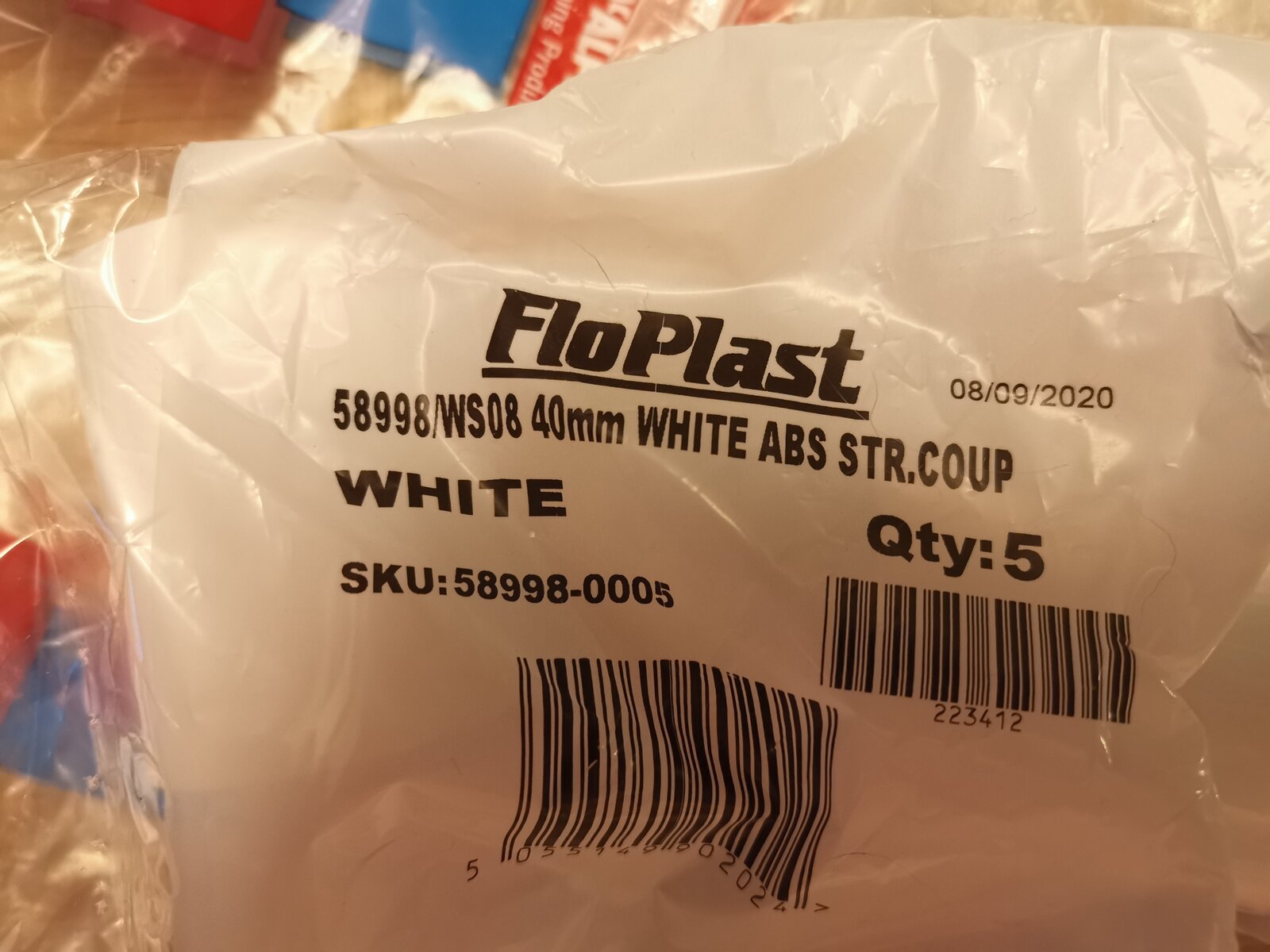

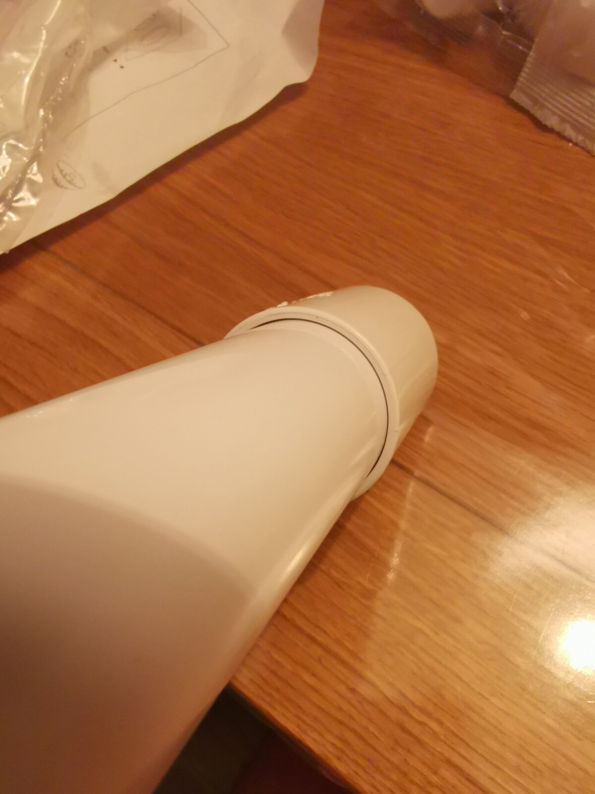

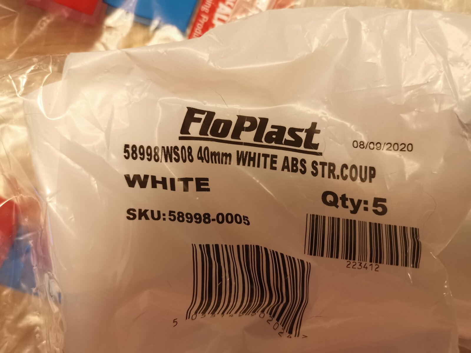

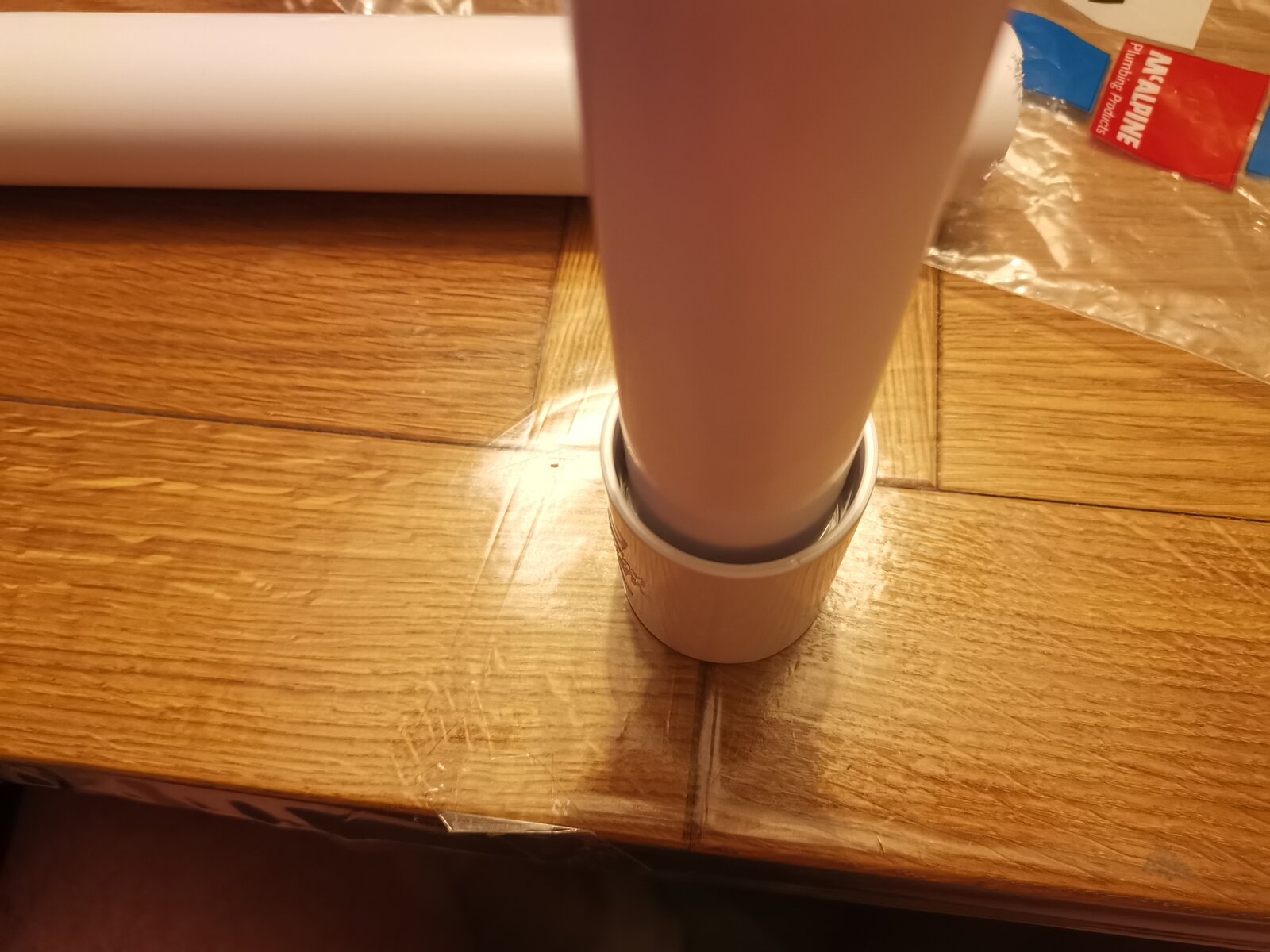

Hi Chris many thanks, just waiting for Johnny to confirm regarding my last post and will then do the above what you've suggested to make up the difference in height, however the other problem I seem to have is the 40mm elbows, coupler, and pipework I purchased today all slip into each other perfectly snug even without the solvent, however they don't fit onto the trap pipes snug, there is about 2mm difference and a lot of lateral movement and I'm sure that would leak?
Might have been better with the McAlpine double bowl kit, the one you have should work though. This snugness for trap, the trap is universal and works on the compression of the conical washer and red washer to prevent it leaking - Ive used hundreds as I’m sure vast majority of other plumbers have.

Hi Chris, it's the solvent weld pipes that I can't see being able to join onto the trap to extend it up to the strainers, I've attached photos below, one showing the 40mm coupler on the 40mm pipe (that feels and looks fine and I can see would work and be watertight even without the solvent) but the other photo is showing the coupler on the trap pipe and you can see the huge gap around the edge?

Also for the 2nd strainer even if I was able to solvent weld a new pipe to reach the 2nd strainer I don't have a thread on the solvent weld pipe to screw onto the nut on the trap?

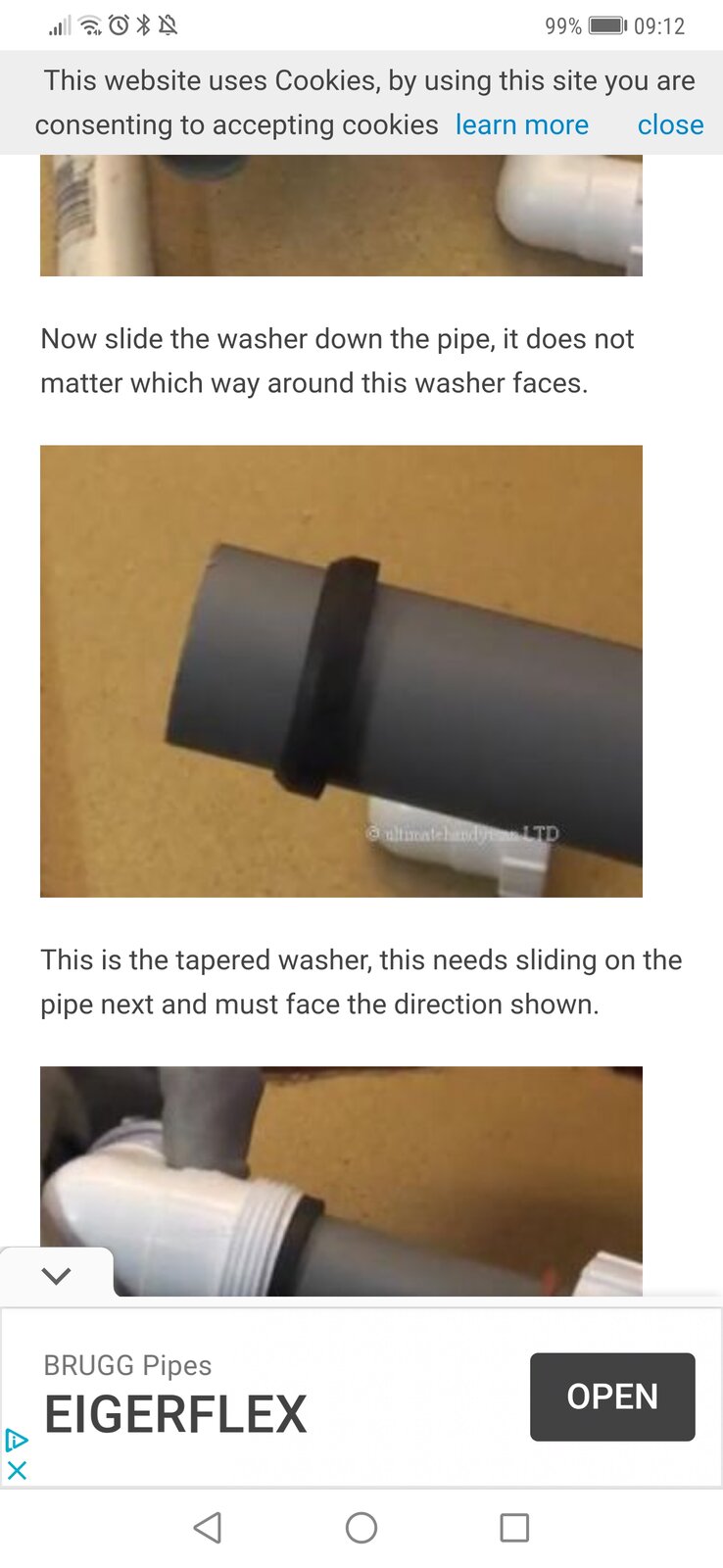

Image 4 definitely doesn't have a washer inside, however I do have one of those black rings left over the same as the other ones that slides over the pipe, shall I put this inside? I've tried and it does go in just about but it doesn't sit completely square, you get about 3/4 sat in the groove and the other 1/4 pops up.
All those black bits that were loose in the package are the same apart from the one cone shaped one that goes with the red one onto the existing solvent pipe to stop the large nut sliding off.
Shouldn't they ALL be cone shaped that slide over the pipes to stop the nuts sliding off?

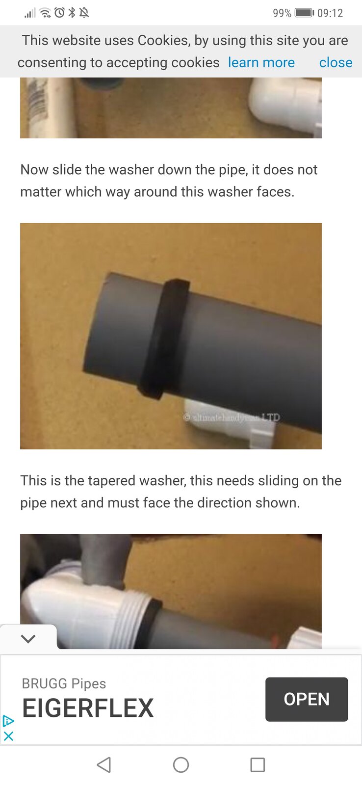

I've checked accross the net for compression fittings and they all seem to have cone shapes washers sliding over and not the straight ones that I have?

Don't use solvent anywhere on the trap.
They're all compression fittings.
The solvent is needed to extend/raise the existing pipe.

Many Thanks mate will try that, did you see those black washer type things that slip over shouldn't they all be cone shaped? As they aren't cone shaped all flat apart from the one that goes onto the large nut that connects up to the solvent pipe?

Don't use solvent on the new trap, you could use a straight waste coupler.
No
