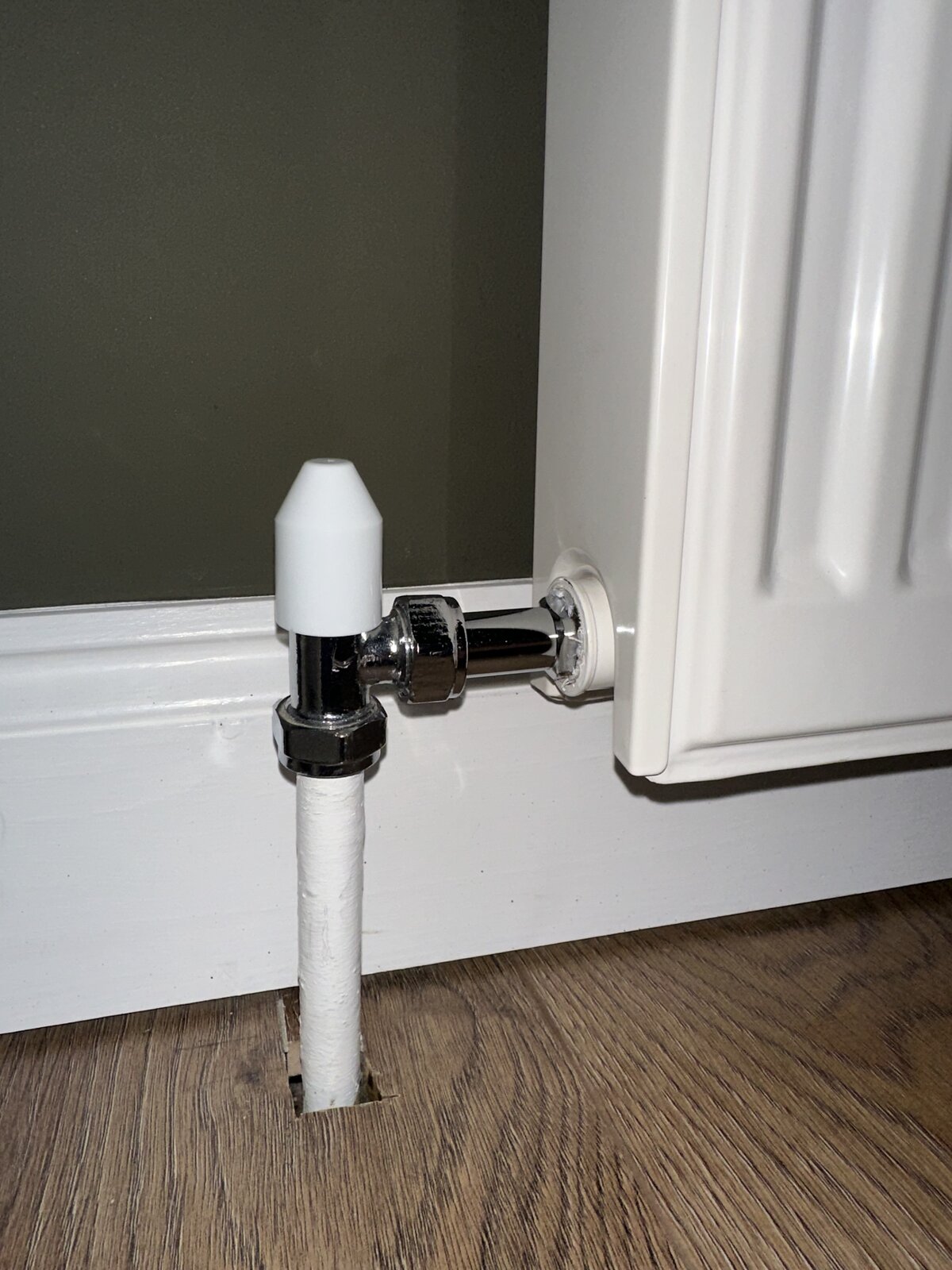

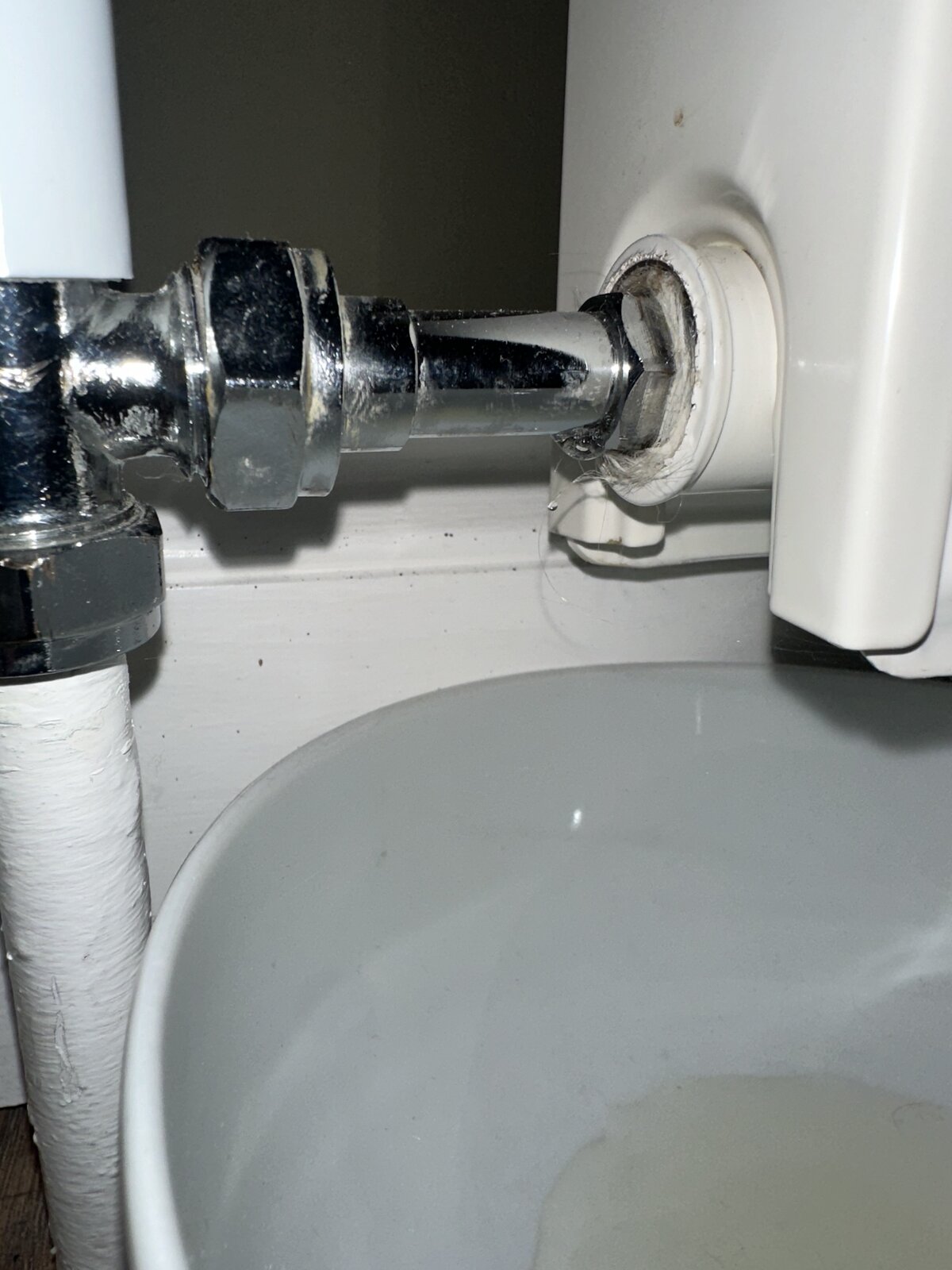

Good morning, all,
I recently removed and reattached a radiator when decorating our bedroom. I subsequently noticed that the telescopic valve was slightly leaking when this radiator, or any radiator in the house, was on.
We have a combi system, so I presume that some part of the telescopic valve has failed, and the pressure when the system is running is causing the leak. It's coming from the 'moving' or 'telescopic' part of the valve, and not the nut (and isn't therefore an issue of tightness, I don't believe).
I'm confident in draining the radiator and swapping the part, but I'm slightly unsure of what the specific part I need is. Could anyone please advise?
Many thanks :giggle:

+1 - those telescopic tails just leak for fun, terrible things.
As suggested, replace for the rigid type.

Thank you both. Swapped for a cut-down rigid one this afternoon, and now leak-free. :giggle:
I'm not sure why the professional plumber we used a few years ago, when initially fitting the new radiators, opted for a telescopic valve, but hey, ho.
