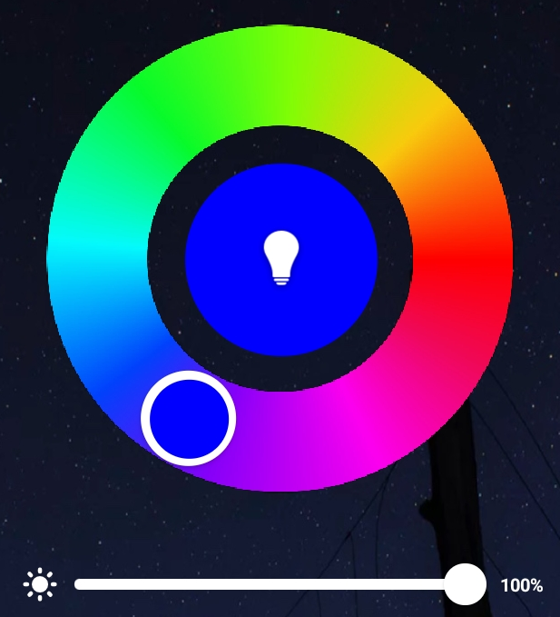

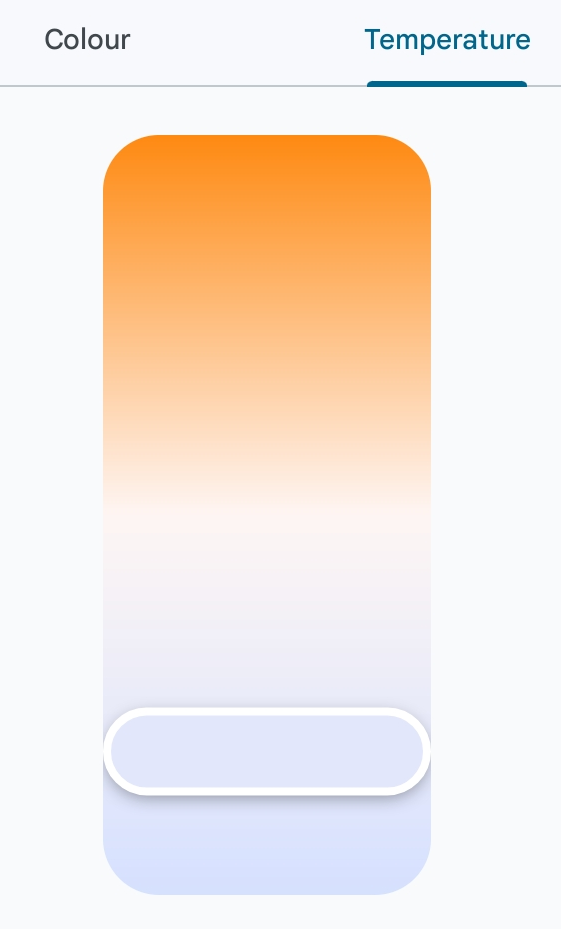

1756235307163.png The control does not actually say what the colour temperature is. 1756235496243.png The colour is a different control. As to the button, I tried a few times to set it up, still not sure what I did, but it works. One is able to group items, I do group into rooms, so I can turn the whole room off. However, trying to get all bulbs to match, has not really worked unless all the same make.

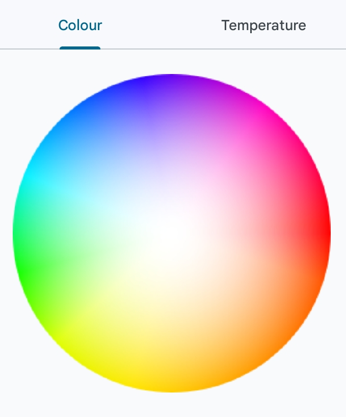

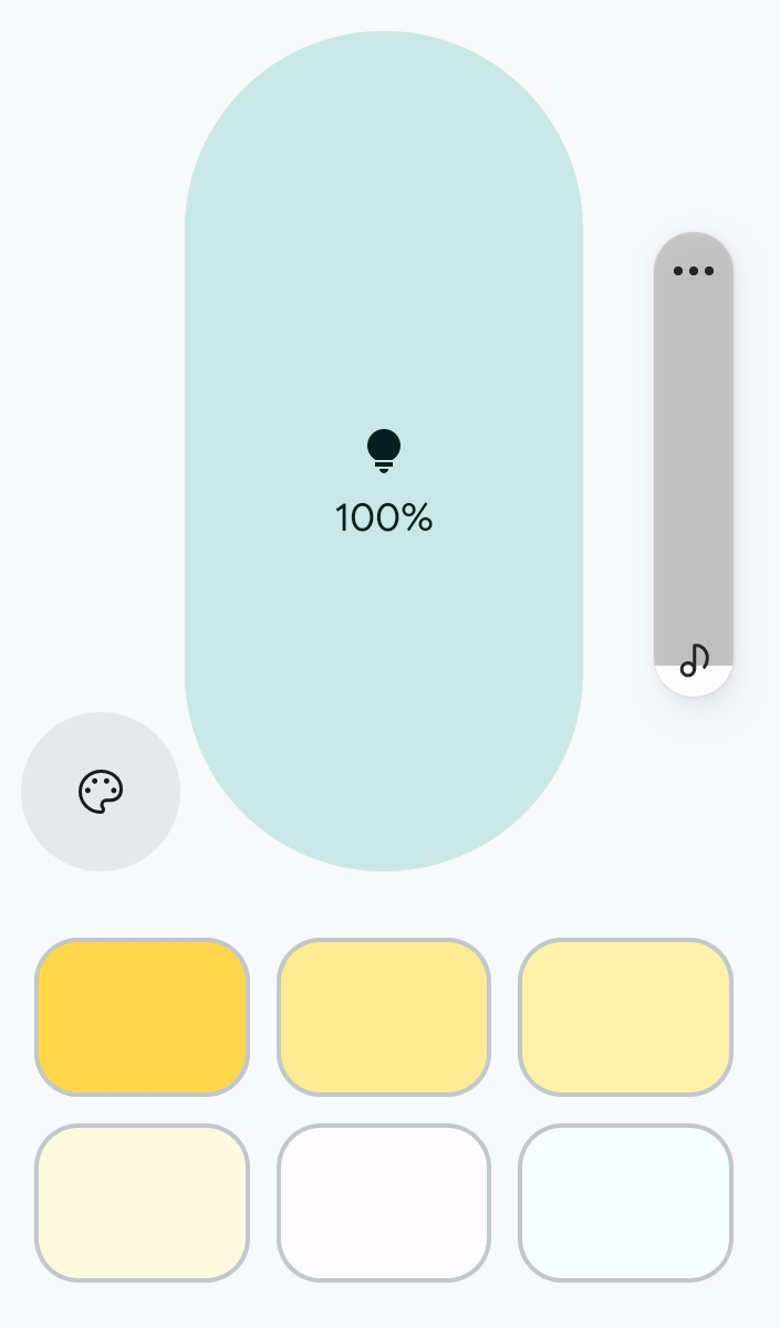

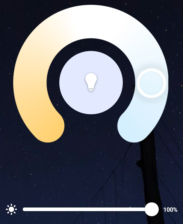

Use a different app, and same lamp has a different look 1756237215725.png1756237340570.png1756237121811.pngthis is using the Google Home App. The first two were with the Smart Life app. I basically, do as I am told, if she who must be obeyed says we need voice control, then we have voice control. I really don't see the problem with manually controlling with my phone.
What my parents would make of todays' controls, I don't know. But it's no good going half-hearted into new technology, the day of the waveform chopping dimmer switch is over, as to labour-saving, the time I spend sorting it out, it only saves labour for SWMBO, it causes me no end of headaches trying to get it to work.

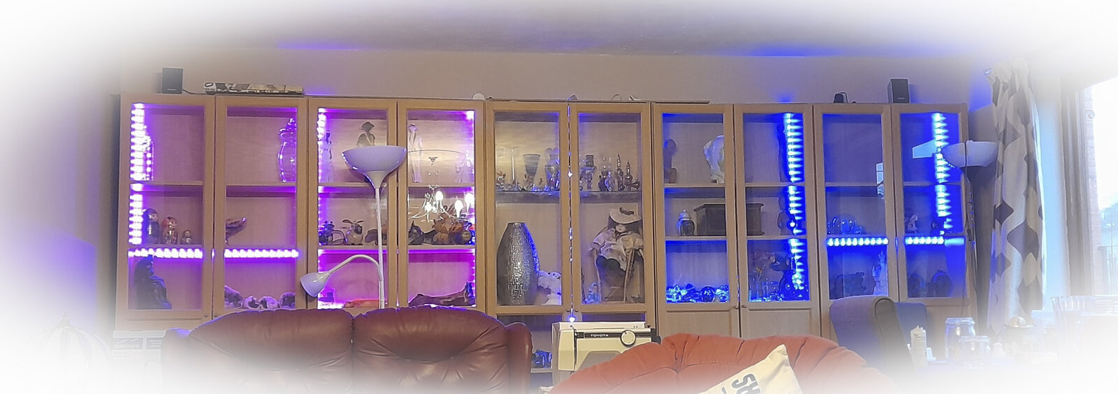

I will enjoy a pint on the weekend at the steam gala, and I would think likely purple moose or similar, would not expect to find a larger on tap, but none of this has anything to do with lighting, I have found a problem with photography with some lighting, in the main where there is a mixture, I can correct if too blue or too red, the same way as our eyes do, but when there is a mixture of LED and mercury vapour lighting, it is near impossible.
The same applies with LED lights, I have two makes in my Ikea Billy book case, 20230227_170703_1.jpgit can look good, but no way can I get all the lights to the same colour, so I simply don't try.
