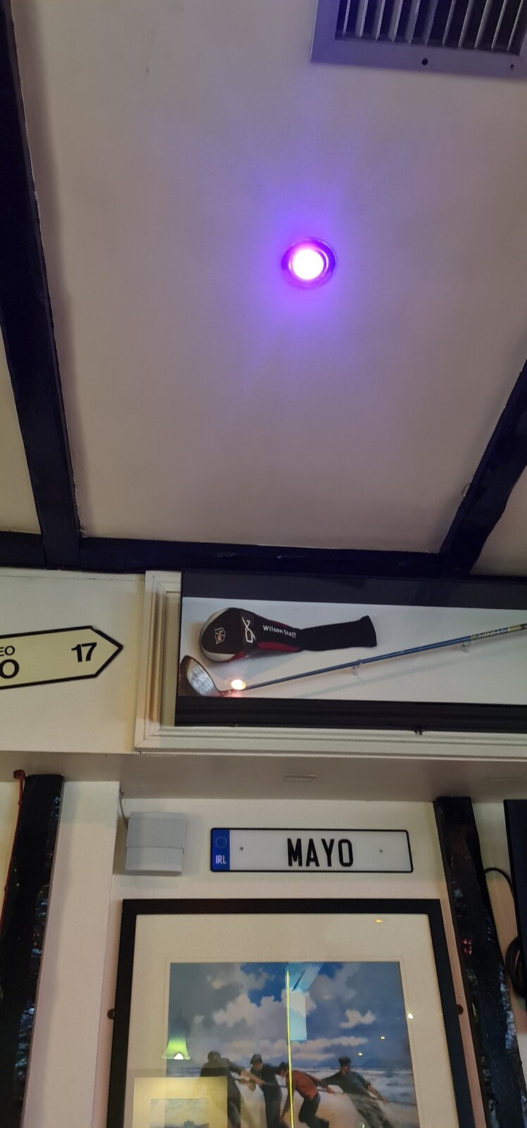

As an aside... the pub I am sitting in... the LED directly above me looks purple/pink. If I walk 1m to the side, it looks yellow.
What gives?

Hey... my pint of Kronenbourg is already 95.4% water... are you trying drown me?
Weirdly, white items under it look white. Not the best of photos. It has 4 round cells in the bulb.
