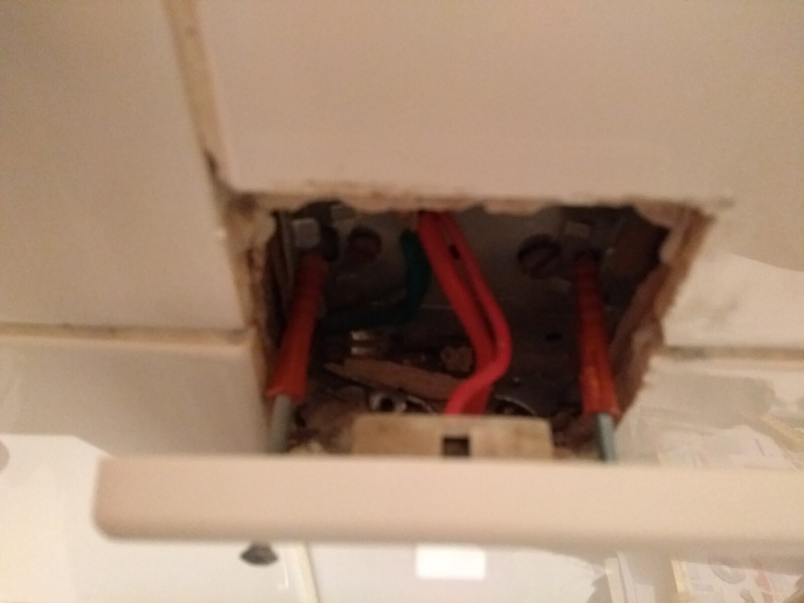

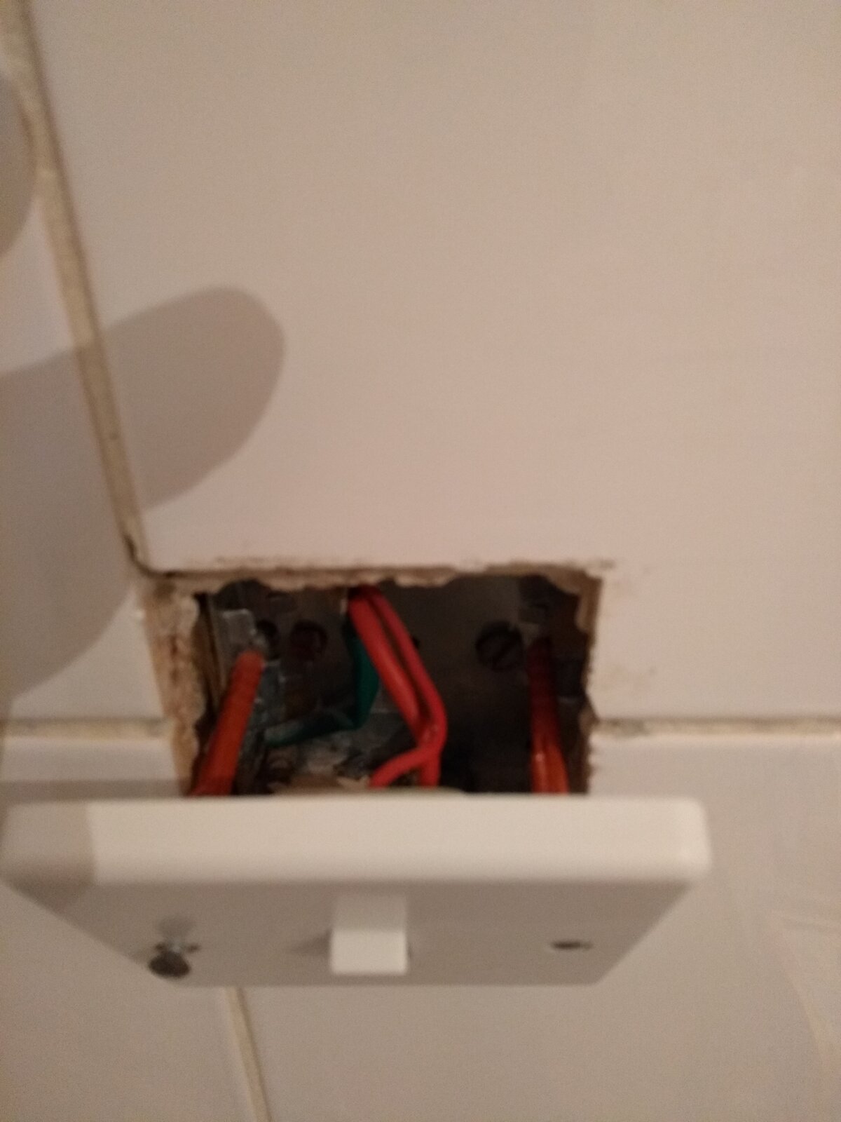

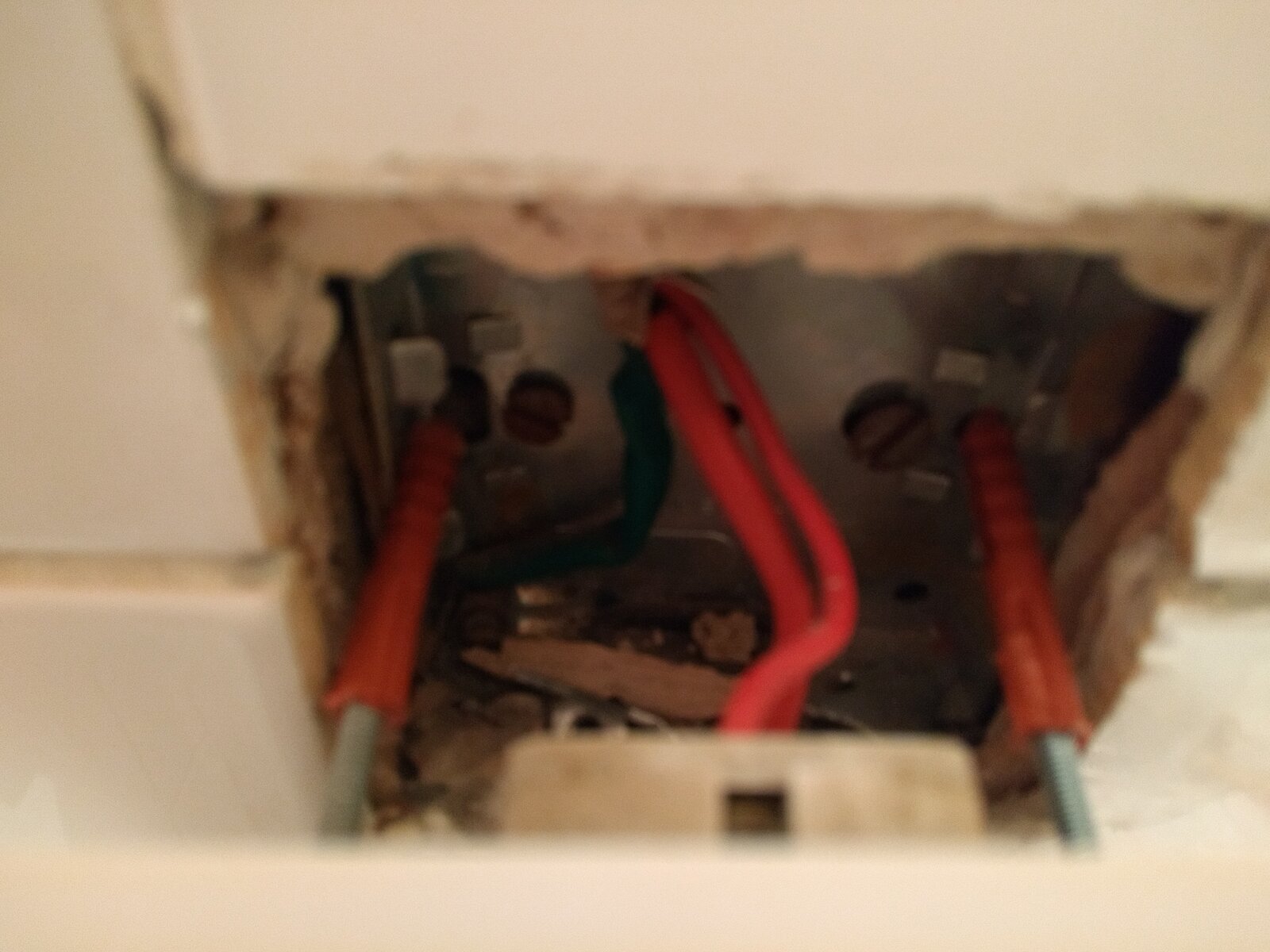

Light switch is very flaky, and keeps coming away from the kitchen wall. Not good if you're about to try and sell a property.
The 1-gang 35mm deep steel back box has its lugs broken off. Can't see how I could replace it as the gap in the tiles is too small.
The left hand screw has a 40mm thread and just about stays in the rawlplug. The right screw is 30mm and does not. I have plenty of different rawlplugs, and could buy another 40mm screw or even some 50mm ones. I do have 50mm ones, but they are not the 3.5 ones for electrics, rather 4 ones. I have polyfilla, superglue and silicone.
Any ideas as to how I can get the switch to hold in place?

A bit of a botch, but how about....
Clean all the rust way from the fixing lug area of the box, mix some car body filler, fill the area of the lugs, let it go off, then drill it lightly smaller than the proper 3.5mm screws?

There is no rule that says the screws have to be M3.5. So use your 50mm ones.
Wouldn't one of the lugs (left one) have been the loose one that can be replaced?
It looks to me as if there are tabs in the backbox for loose lugs on both sides.
If you could get a couple of those lugs...
Of course every manufacturer has slightly different designs for how the lugs fit in the tabs.
Its a bodge anyway, both lugs are missing and someone has drilled through the back of the box and put red plugs in the wall
If you want to fix it properly, get some lugs off a doner box and fit them (may have to adpt to fix)
If you want to just get it to screw back up solidly and leave it bodged, then the old matchsticks in the hole trick will probably work

Thank you all for your great replies. Plenty of ideas there. As Adam_151 rightly states, as it is a bodge anyway, I will start with the "old matchsticks in the hole trick". Can't believe I didn't think of that - my favourite DIY bodge back in my long ago student days. Whoever buys this ex-rental property will almost certainly want to gut the run-down kitchen anyway.
