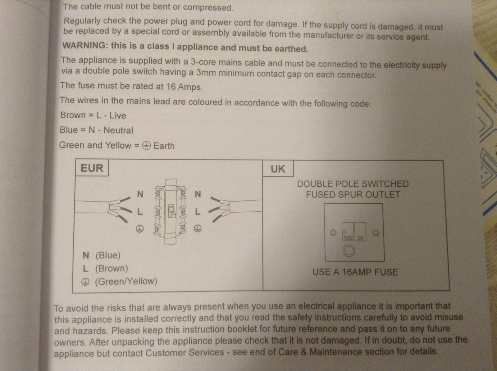

I do not make ridiculous posts. Here is an example of manufacturers instructions being wrong. This is for an oven supplied by the well known DIY store B & Q.
