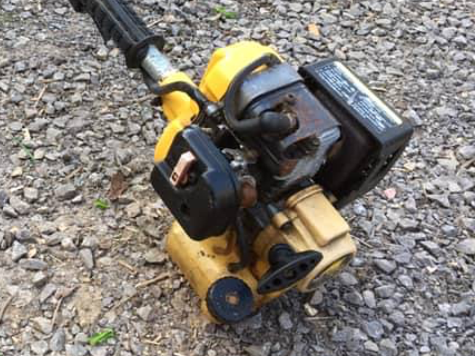

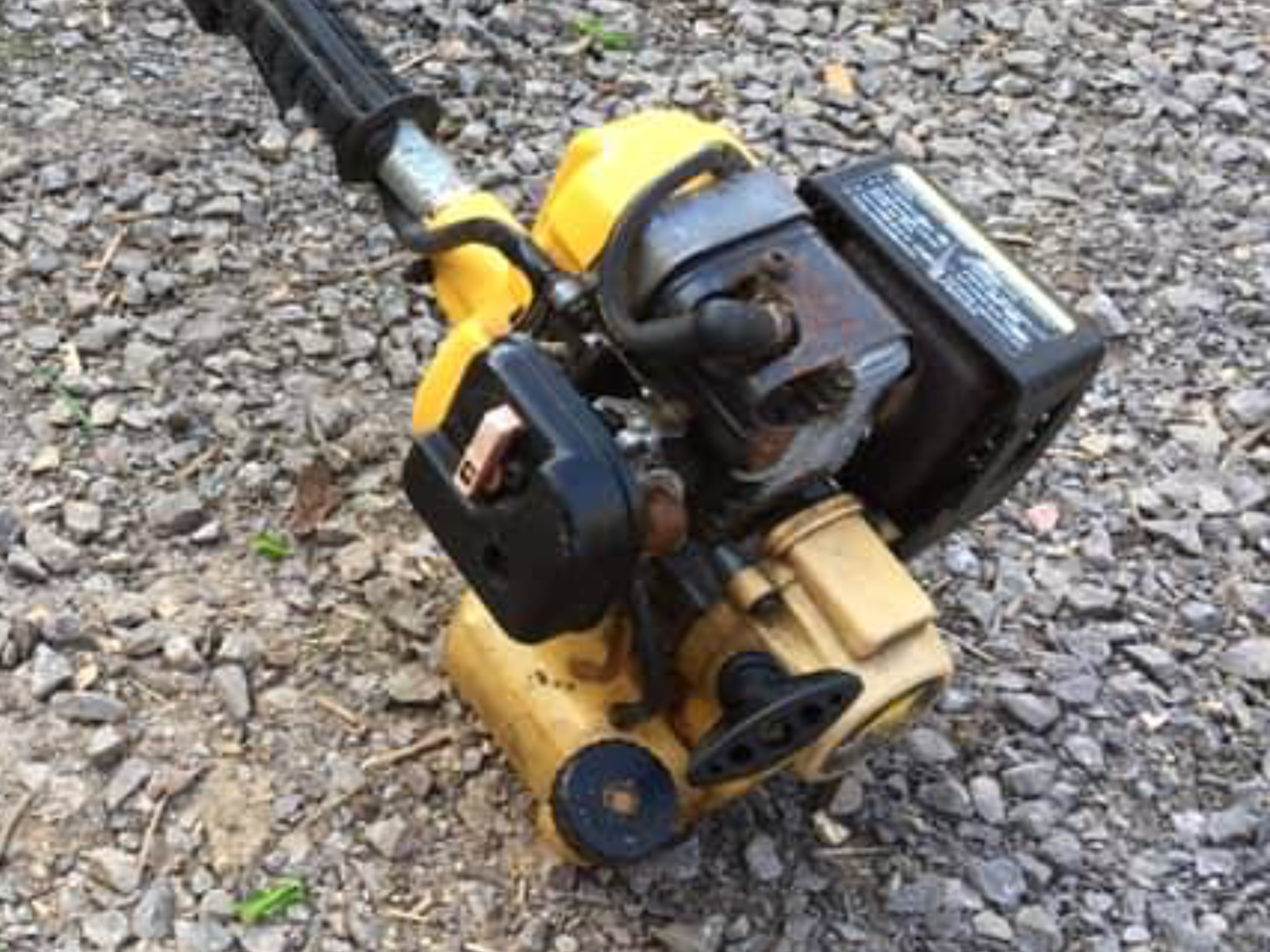

Hi,
Anybody able to identify what model this McCulloch petrol strimmer is please.

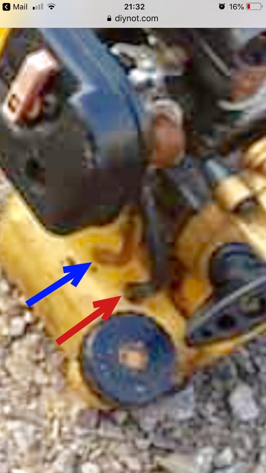

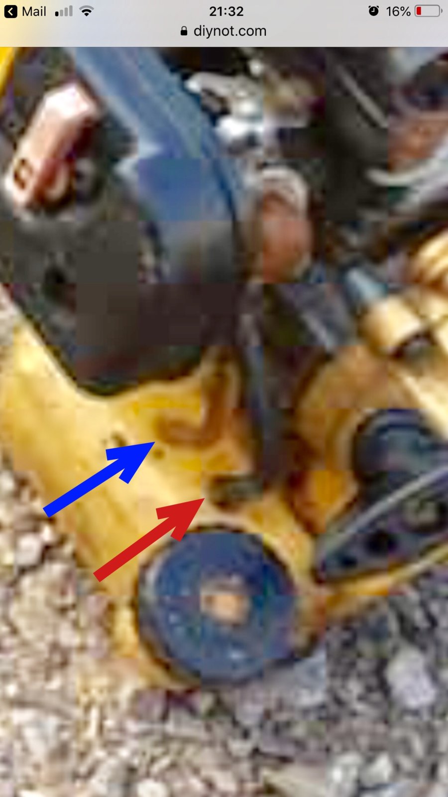

Hi,
I’ve picked this item up now and it’s a Mac 80 sx.
There are 2 fuel pipes so I assume one is intake and other is return.
So which is which ?
In the supplied photo there are a blue and red arrow to help if possible identify them.
I removed the fuel from the tank and out came a small filter hence why I need to know which is intake.
The black hose shown looks like it fits to the primer bulb. You can pull this hose out of the tank because the large black hose only touches the tank because a smaller harder hose is pushed into the soft flexible black hose. So is this normal as petrol could leak out or has someone done this as it was to hard a job to put the larger hose straight from primer bulb into the tank ?
It sounds like someone has been fiddling with the fuel pipes in the past.....the pipes need to be a snug fit in the grommet and the secret is to fit the pipes in the grommet then fit the grommet into the tank.
Anyway, time for some guesswork, Im going by memory here.
The pipe going to the primer bulb should be well immersed into the fuel tank, with a filter in the end.
The other pipe from the primer enters the carb, usually near the adjustment screws.
The other pipe exits the carb then terminates just through the grommet, its purpose to return excess fuel back to the tank.
If you connect up as suggested, you should see the fuel lift into the carb and then return back to the tank.
New fuel pipes, complete with grommet, are available from GHS. Ltd.

The return hose is clear see through and looks like it's in the tank fine as its a tight fit.
Sorry, I couldnt tell from your picture but this machine doesnt have a grommet, just holes in the tank......theres no difference in real life however.
Proper fuel hose is made from Tygon, many sizes are available so maybe a replacement has been fitted at some time. They need to be a snug fit, but only to keep dirt out of the tank...the fit doesnt have to be air tight.
John :)
