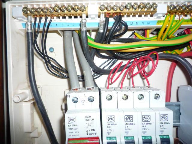

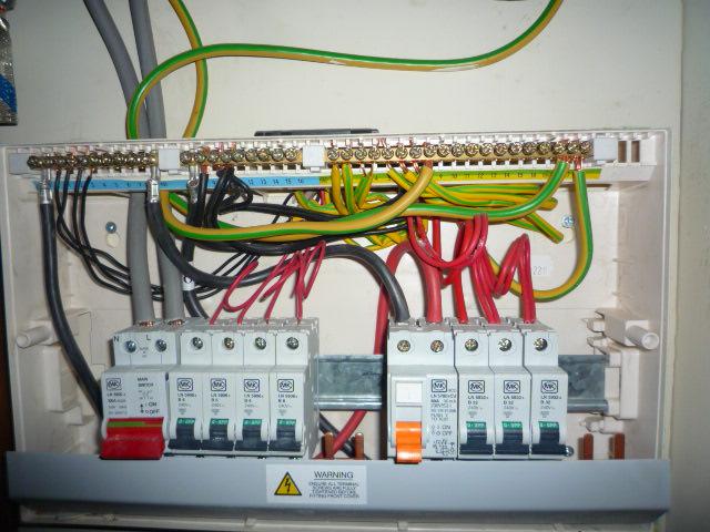

Hi after experiencing the same issue as a lot of people and reading a lot of questions around ovens tripping the RCD. I want to move the oven off the RCD to see if I can start to use my oven normally again instead of having to keep the temperature under 150degrees (to prevent the RCD from tripping)
It's the first to the right of the orange looking trip switch.
I presume once all the power is cut off I would have to unscrew the oven circuit and move it over to the lefthand non protected side. However as I was searching what to do I saw a post which says to move the neutral over and wasn't sure what that entailed.
Is this something that is obvious once I attempt to move the circuit over as didn't want to poke around too much until I posted here
I've attached a picture of my box if you can help me out
Cheers Everyone!
I can't recommend moving it across as that will make the circuit less compliant with the current regulations.

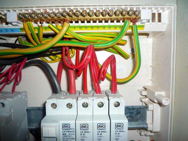

Switch the power off* unscrew the MCB, unclip it from the din rail, move it to the other side, make sure to tighten it onto the bus as well as clip it in, and connect the outgoing circuit, and yes, you will have to move the neutral to the non RCD neutral bar... see the two neutral bars at the top... left is non-rcd, right is RCD (get the wrong one and you'll trip the RCD every time), the order of cables in teh neutral bar should follow the order of the breakers, the terminals are numbered to help you... but be aware that depending on who installed the board, you cant rely on that being correct!
*Yes... commercial electricians do it with the busbars live all the time, but a DIYer certainly should not try it!!
Do what Adam says, but chuck the MCB and install a 32A 30mA RCBO instead. This will retain RCD protection to that circuit, as is required by the regs (unless you know the cables aren't buried in a wall or installed in earthed conduit?).
You'll still get tripping, but it's the only way to stay within the regulations. But hey, at least you won't lose the whole house at once!
Or... buy a new element from fleabay for £15, unscrew the panel at the back of the oven and fit the new one.
Thats quite a neat CU compared with some that are posted but why so much bare copper?
Is it just me that sees a sliver of black on the tail in the live, and a sliver of red on the tail in the neutral?

It looks like black in the live, but the I think the red you're seeing is just colouration of the copper - They're probably both black.
Any chance of a picture of the CU and meter together to see if the polarity is correct?
