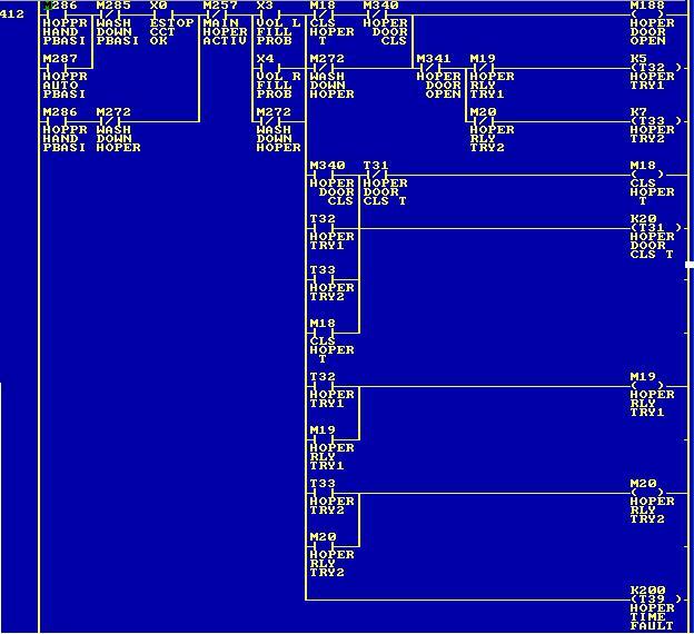

Many years ago I also had a problem with probes and time delay the opposite to this problem the probe controlled had an automatic delay and the idea was as the concrete was used in a sub hopper a door would open in the main hopper and top it up. But because of the delay not only did it top it up but it overflowed.
Cure was to limit the open time. But concrete unlike water flows a different rates according to it's slump so a single time open was not good enough and progressively the open time needed increasing until the sub hopper probe was covered.
This shows just a little of the program just to redress this problem. The M2xx were through ASi control the Xxx where direct to PLC the Mxx were relays and Txx timers.
The point is when this post started I was considering the use of a PLC what a big mistake that would have been?

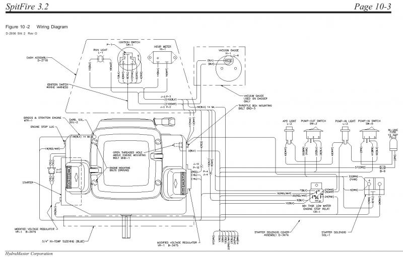

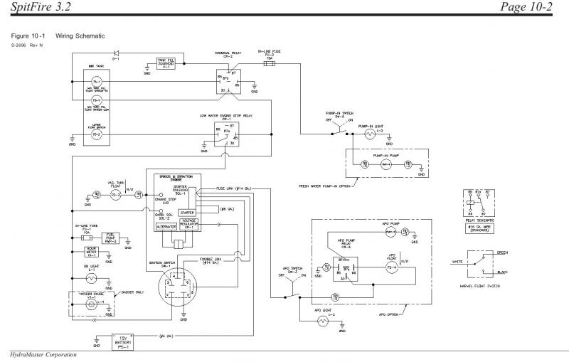

I found this on another schematic from the same manual
But I don’t know what the B2 and B3 are
I asked an auto electrician not long ago but he did not know ever
I wonder if that was the problem all along hum!
White is normally unfused non ignition live and blue with trace is head lights and blue on own often is supply to trailer live a caravan so with not more info I would say split charging supply!
Ever I need a new set of glasses or you need a check up from the doctor from the neck up

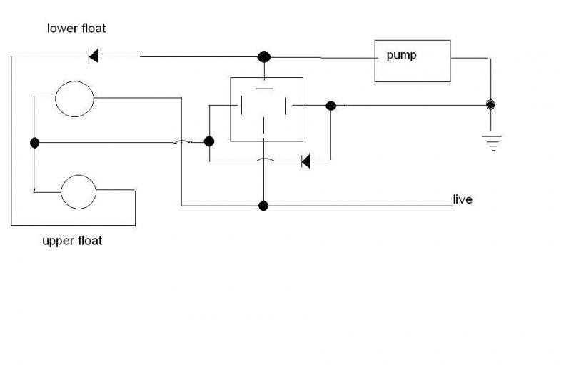

I'll have one last go at getting you to understand why I asked what I did.
Simply use two relays one works pump and other does latch.
I have set up and tested the above schematic
Using a domestic car charger as the power source
The sequence has work and it has not blown the float switch..

White is normally infused non ignition live and blue with trace is head lights and blue on own often is supply to trailer live a caravan so with not more info I would say split charging supply!
Nope its American wiring so the white is normaly earth and blue normally live

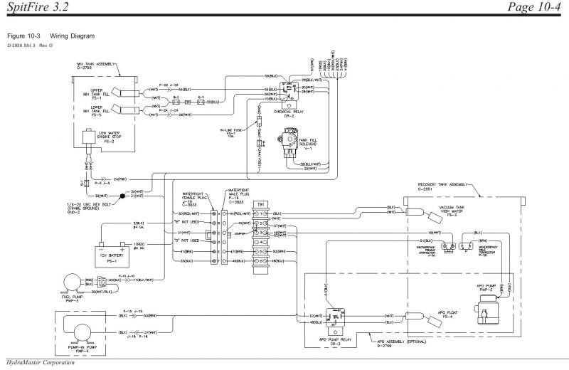

More info is needed so hears the full schematic
as you can see it’s the same schematic as the original for the other But look at the chemical solenoid they don’t match up
I just wanted to know what the b2 and b3 boxes wear rely just for pice of mind if I had missed something off of my wiring before that might of been the problem

I have tried to read the diagrams but although I can follow wires I can't read labels to find the b2 and b3 boxes. It was many years ago when I worked on USA auto electrics and I can't remember their colour code. The Lucas one I can remember the main cables and with Bosch I can remember some of the numbers but it was back in 1984 when I worked on auto electrics.

what diagram, i've been runing around this thread for 4 days now looking for such a piture
Going back to the original diagram, if the diode, although working, was fitted the wrong way round, the circuit would appear to work.
However, the snag is the lower float switch would be switching the full current to the motor for the time taken for the relay to operate, the relay would release once the lower float switch operates leaving the upper float switch to carry the full current for the pump until it too operates.
Although the relay would clunk and click nicely every time it wouldn't actually be switching the load.
The only symptom may be the relay releasing but the pump continuing to run.

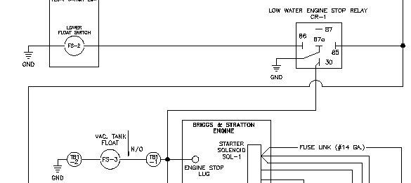

Now to my latest project hear is the wiring of the low water engine stop float switch please note that the line into port 85 on the relay is the main live in and it also goes to the other relay but that dose not matter rely
It is not wired up at the moment coz I don’t have a switch anymore but when I get a new float switch soon it won’t be hard as I have wired it up before and it worked
But what I want to do is fit a bypass switch to it that instead of stopping the machine/earthing the engine stop lug the switch would bypass it to an alarm and a warning light
Can’t be that hard to do as we see it on cars all the time
