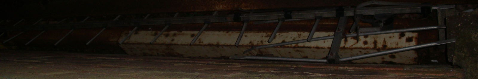

Behind my shed I have an old aerial from the chimney which was pointing at Crystal Palace:
This is about 3m or more long but the camera flash couldn't cope with all of it, this shows less than half of 29 directors and reflecter (total of 6 elements) & dipole and which I make 31 elements but manufacturers may call 36 elements.

I cannot comment on the aerial behind your shed as the picture is not good enough.

As to the aerial behind my shed, I warned the flash didn't penetrate far but you can see about a 40% of the boom and a dozen of the 29 directors. For clarification that is 29 pieces of aluminium ~6" long mounted across the boom, just the way you describe them. On this occasion you would call it 31 elements.

OK. That is unusually big.
