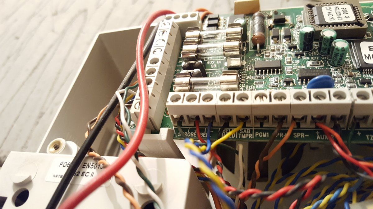

New Alarm Box Please help What wire to cut

Eurosec control panel does not support EOL

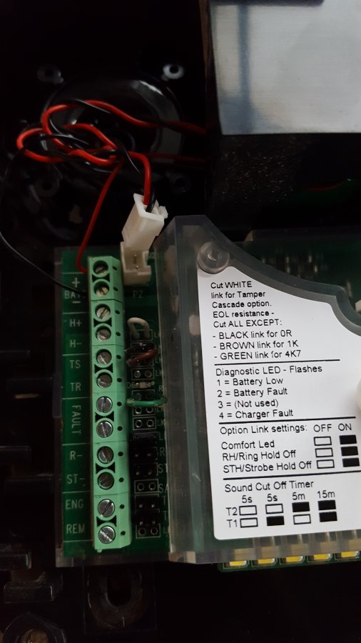

If I have no wires cut the alarm bell keeps going off and on the keypad it displays alarm bell Box tamper..
Please help
H+ Red
H- Black
TR yellow
R- Blue
ST- Brown
From your photo they are the coloured wires that should be connected in bell box
No links should be cut
Have you put cover on bell box correctly and also check rear tamper
