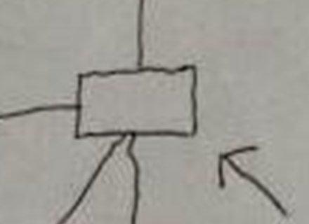

where is the 'lectricity coming from? This is just one big loop with branches off for the lights
I can but 'assume' (always dangerous, exceptionally so in this thread!) that the two 'dead end' wires heading off to the left of the diagram (one at top, t'other at bottom) go to the rest of the ring.

I was going by this:
Can I put 1 of the live wires out the socket into a junction box follow it around and go back into the same socket ?
Not sure how that statement corresponds to your drawing.
(Apologies to those with small screens, but any smaller and it might not have been clear)

It is, indeed. However, you wrote/asked:
OK - I give up. What am I not seeing in this which is causing people to get so agitated:
... and what 'you were not seeing ... which is causing people to get so agitated' was that the OP (or his friend) did not do what he was asking about but, rather, did something very different (per the diagram which riveralt rotated for him) - which I would have expected to have got you 'agitated' as well :)

Jesus Christ... How difficult is it to break into a ring to extend a circuit...?
Nothing I've seen in this post shows thats what been done.
Quite, seems much more likely that it's actually a figure-8 configuration now
Quite - with a socket at the centre of the "8" and another socket spurred off that one, using two cables in parallel. I suppose it's at least 'different', and perhaps quite fitting for a Friday evening, even before I've got the first bottle opened :)

I have 3 sets of wires in the socket I want to go from, 2 our live, 1 is dead .
Assuming you have a ring final circuit three sets of wires can mean many things.
Do you have three red/brown, three black/blue and three earths? Or do you have one of each?
If you have three of each then this socket is not suitable to create a fused spur unless you can remove what appears to be an existing spur already.
If you have one of each then this socket is already a spur and you cannot spur from a spur.
even though he'd not asked if he couls spur his new sockets.
So 1 set into junction box, into 3 new sockets and back to the same socket would be a ring circuit plus the same amount of wires in that socket.
No.
You cannot do what you are saying - stop trying to extend the ring and focus on adding a fused spur.

He has looked what I have done and this is what he has come up with.
From socket up stairs into junction box , to double socket , to F.S for 1 light, to double socket , to F.S for another light, to double socket and back down stairs into double socket.
i.e. the OP saying that what had been done was what he had asked if could be done, i.e. (apart from the FCUs) what I drew, not him describing doing something else.
I will post a picture of diagram of the job.

No socket has 4 cables in it. It had 3 in it and still has 3 now because 1 was took out to go in junction box and ringed back into that socket.
i.e. saying for a second time that what had been done was what he had twice said would be done.
I may have missed this:
Your picture says otherwise.
You are also missing cables coming into the starting downstairs socket.
You cannot connect this circuit as it is shown in the diagram.

Three plus one 'going back into it' equals 4, doesn't it? More to the point, it's crazy! You really ought to get an electrician to sort that mess out.
No 3 plus 1 going out is 2. Then back to socket is 3 your maths is really bad.
What? !!! Even if my maths is bad, I can at least count ... How many cables going to this socket:
So I didn't see it, or the 5 posts which were made after it while I was crafting and uploading my drawing.
