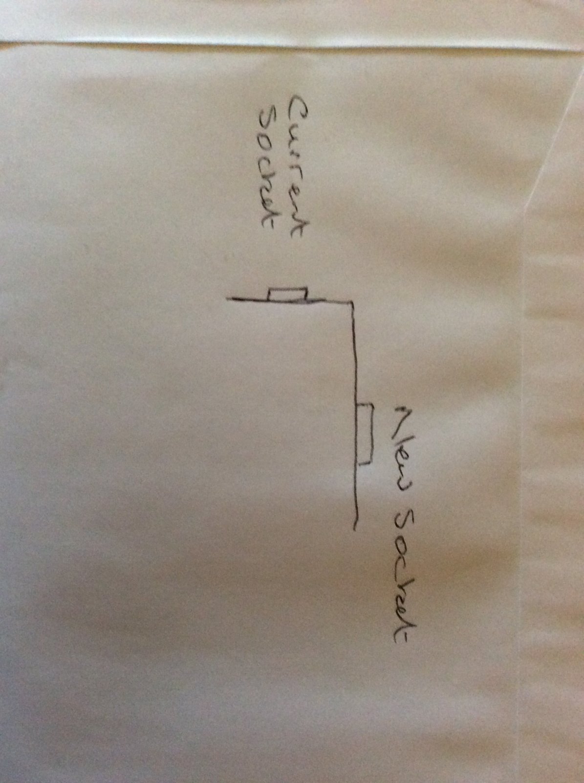

I’d like to spur from an existing socket to a new one in another room.
‘Easiest’ route is through wall behind existing socket into another room, chase wall round internal corner, along wall running perpendicular to it and drill through to new socket position.
Is this within safe zone regs?

Yes, but one of the sockets is on the other side of the wall.
You would need to chase the wall on the existing socket side until you get to the corner in the new socket room.
Think the other way round.
Run cable horizontal from existing socket to wall corner. That is in zone.
Drill through corner into room two. Run cable horizontal from corner to new socket. That's in zones too.

And as I said safe zones don’t go round corners.
Yes they do when you have fittings on both walls and they are in line.
Which is not the case here.
