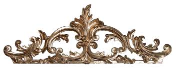

You can always cover the cut with a decorative moulding.

You could do it as well as you can with a jig-saw and, as I suggested, cover with a decorative piece.
