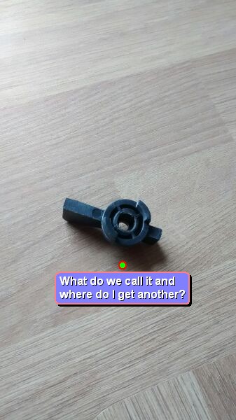

Heating valves look open, but check they feel like they're moving something when you turn them. It's not unknown for the plastic lever insides to round off, the handle turns but the valve doesn't.
Hello, it was exactly this!
I now have heating. I saw that the screw head wasn't rotating when I altered the position of the CH outlet valve, it seemed to do this on the CH return. So I unscrewed it and took off the black plastic lever (culprit below) and turned the valve with a spanner - 60 seconds later the closest radiator started to warm up. I am very grateful for the advice received, I had the Handyman all set up to come back and now I don't need him.
Just to close this off, everything is working normally again. I had to 'balance' the system again as I'd set all valves fully open, so I'm not sure if it is exactly like before (as I didn't bother remembering their position) but every radiator gets hot.
Just need to purchase a black plastic dooberywotsit (no idea) from somewhere... maybe I'll try BHS tomorrow!

When "reopened" the knob turned but not the valve!
Its odd, valves under boilers seem to be made of a very soft plastic which often deforms and turns on the shaft.
But washing machine valve knobs seem to be a harder plastic and don't seem to deform so often. Sometimes they can fit on the boiler valve shafts.
Or just leave the bare shaft and keep a small adjustable spanner handy.

i find the some valiant ones do it as well ( new and old ) very annoying
The grey Vaillant valves are some of the softest.
As its such a common failure point I can only conclude that its intentional to make additional income from selling spare parts.

I said - "So, unless I did in some kind of dream (I most certainly did not!)..." - but that is inconsequential anyway. What matters is getting a new plastic thingummy. Hard to buy one when you don't even know what it's called. "boiler valve lever" would be a good bet, but, seems no.
we would love to dream , i wish all iso's have metal handles , when you have to buy the vaillant iso's then you would complain , i think last time i brought one valiant iso it was about £ 80 - £ 90:eek: . i think the iso for this boiler was about £30 don't quote me on that
