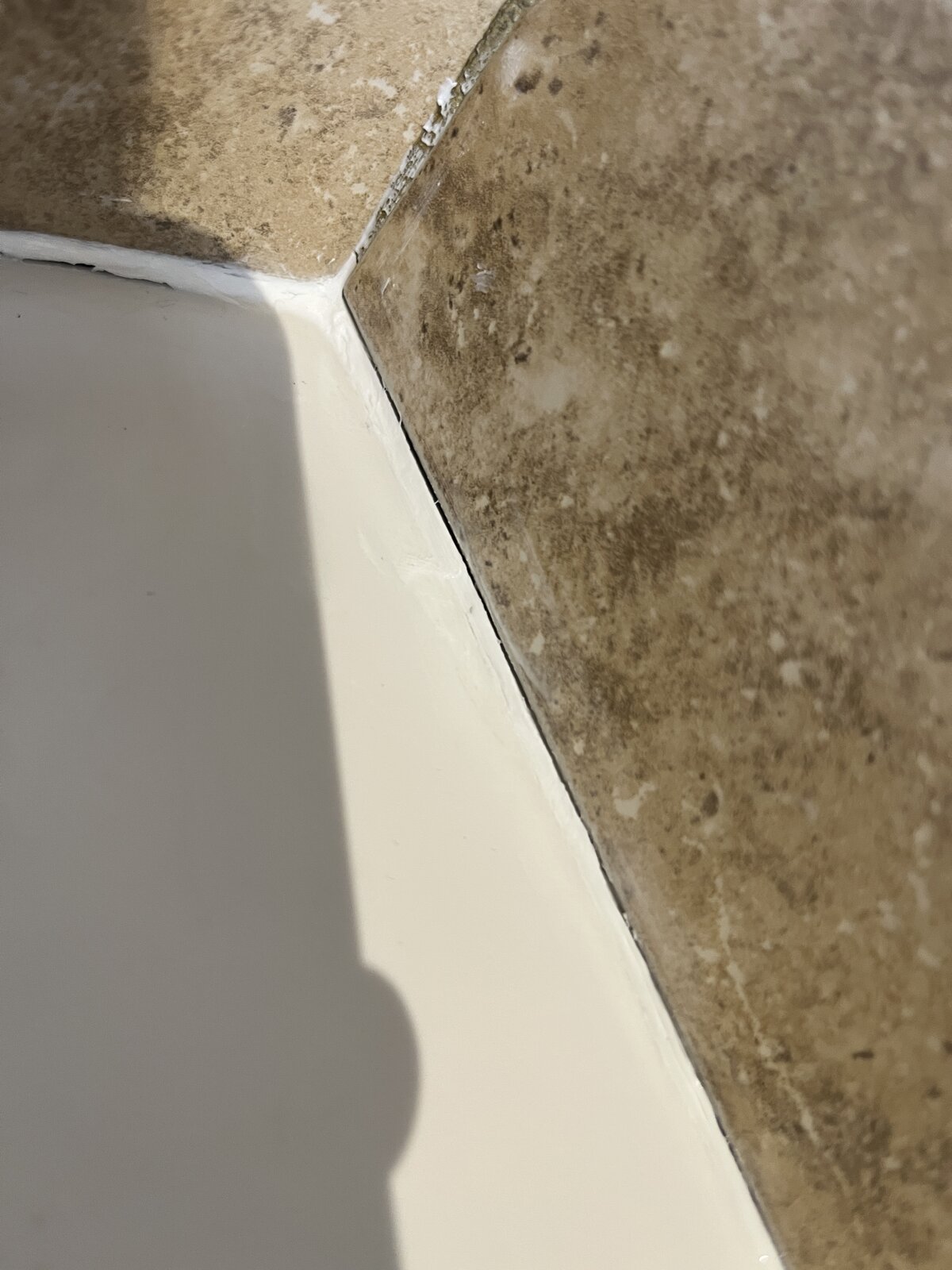

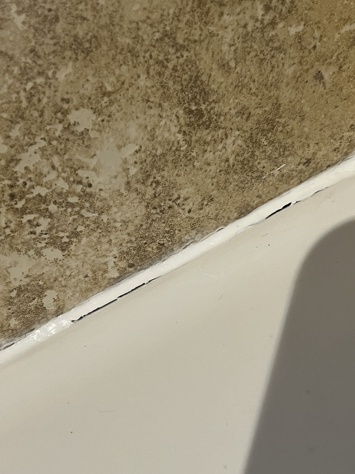

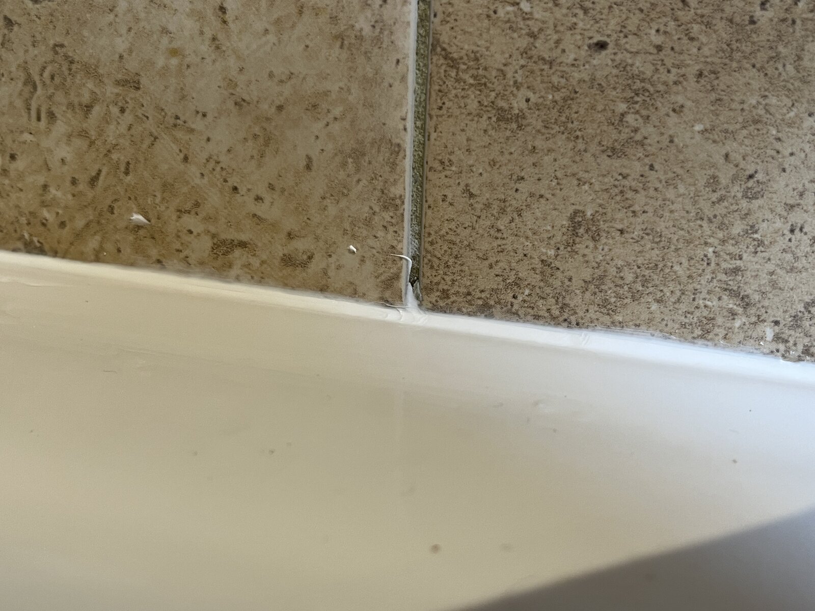

Hi all!
First time using silicone…
Scraped it out, cleaned with isopropyl alcohol and used dowsil with spray bottle and a finger to smooth.
However, not sure if I’ve put enough silicone on. The silicone required huge force to get it out the end of the nozzle and just wasn’t moving out smoothly like all the videos I’ve watched.
It seems to have pulled away/shrunk and there are definite gaps as it’s sealing which weren’t there originally. Any help?
Not sure if I’ve put too little? Gonna have to scrape out and start again but don’t want to keep repeating the same thing
Thanks for any advice.
John

It should not require huge force at all, there is something wrong there.
You should obviously not be getting gaps in the silicone. I'm wondering if it's a big gap between the tiles and bath that you are trying to cover? There shouldn't be a big gap between tiles and bath. It's difficult to get an idea of scale from the pics.
The height of my silicone line would usually be between 6-8 mm.
A profiling tool would help you get a better finish.
When a silicone gun is working correctly, it should just require a light to medium force squeeze on the trigger as you run your bead along.

There is a 1-2mm gap in places (it’s not completely consistent). I guess if there isn’t enough silicone and it’s partially squeezing away through the gap, it might result in the ‘cracks’?
What brand/type of silicone sealant did you use and how close to the 'use-by' date was the tube?

Doesn’t look like you cleaned the old stuff of very well, so prevents new adherence, if it’s tough to extrude you either didn’t cut the end of the tube enough or it’s out of date. Was it new tube and nozzle.?
Used dowsil 785 I think it’s called. New tube and nozzle yes, although I don’t think I cut a big enough aperture in hindsight.
Old stuff was cut away pretty well and used a scraper to get anything visible off. Didn’t use any chemicals or anything though, apart from the alcohol to clean
Get a brand new Stanley blade and carefully take every bit of that ( and the old) silicone off. Pop into screw fix and get a 646fn, and a 656ru. Make sure you cut enough off the end of the nozzle ( at 45 degrees) before you re-apply.

I think it possibly wasn’t clean/dry enough and I hadn’t cut enough of the silicone tip off (hence the resistance). Tried again and it seems to be neat and bonded well - time will tell. Thanks all
