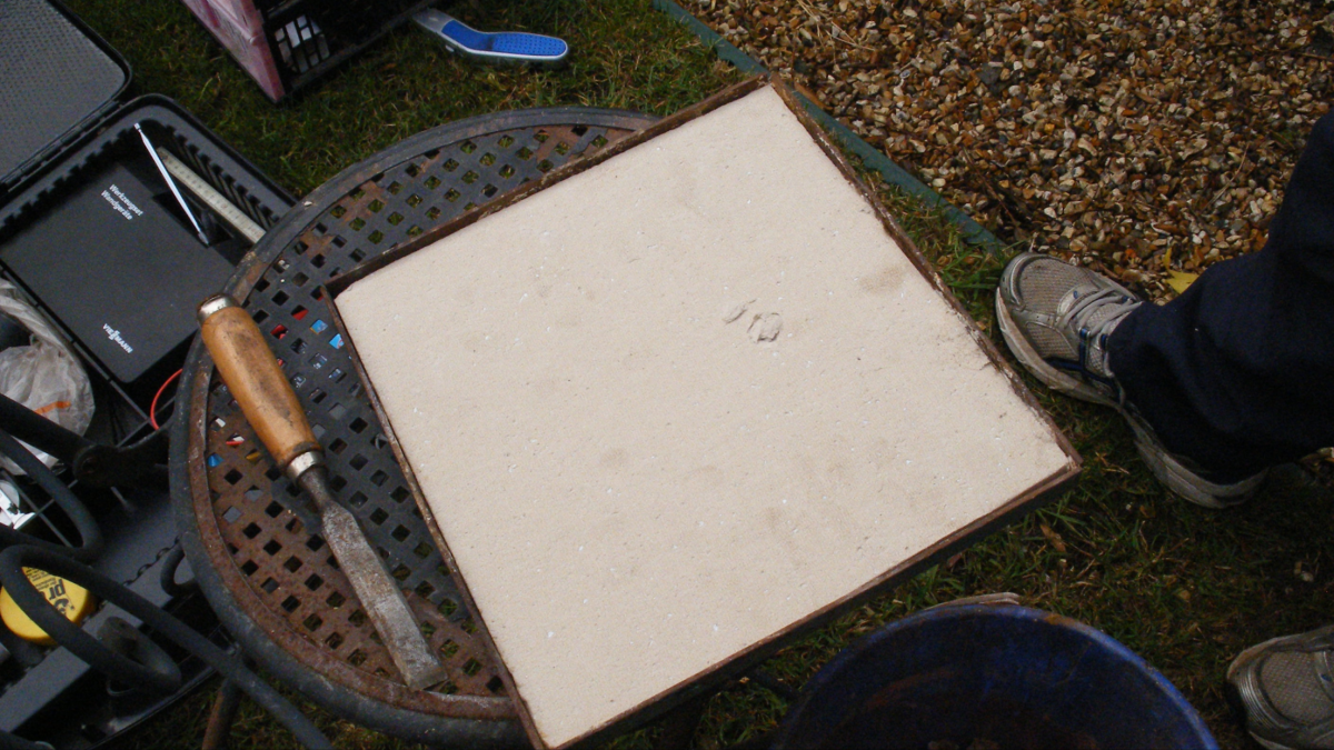

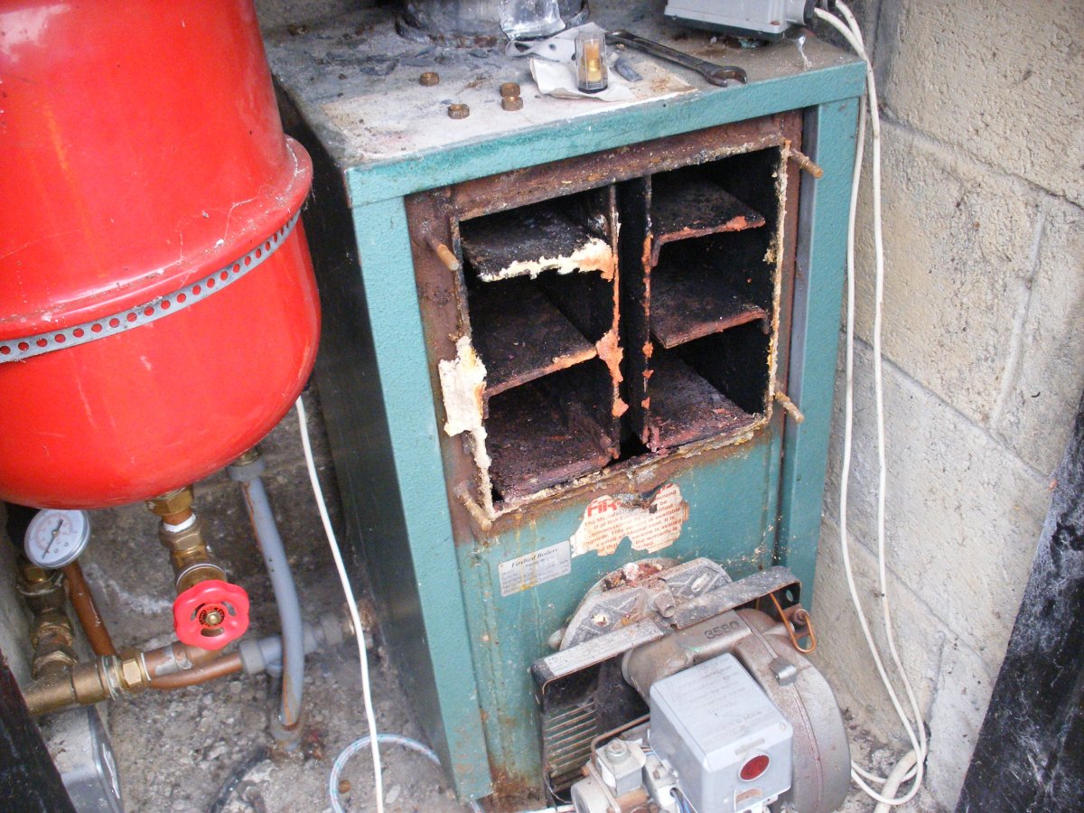

I just went to replace the rope seal on the baffle door of my firebird popular 82 and it appears that there isn't any place for it... the whole of the inside is of the baffle door is filled with a vermiculite insulation that appears to also be the seal...
Am I being thick (again) ? Or is it
possible that this is how it is supposed to be?
I have put it back without taking a picture but have found a picture of what it looks like and will post that in a minute.

It appears that the board squashes onto the protruding edges of the baffle chamber and forms a seal... But I don't know.
