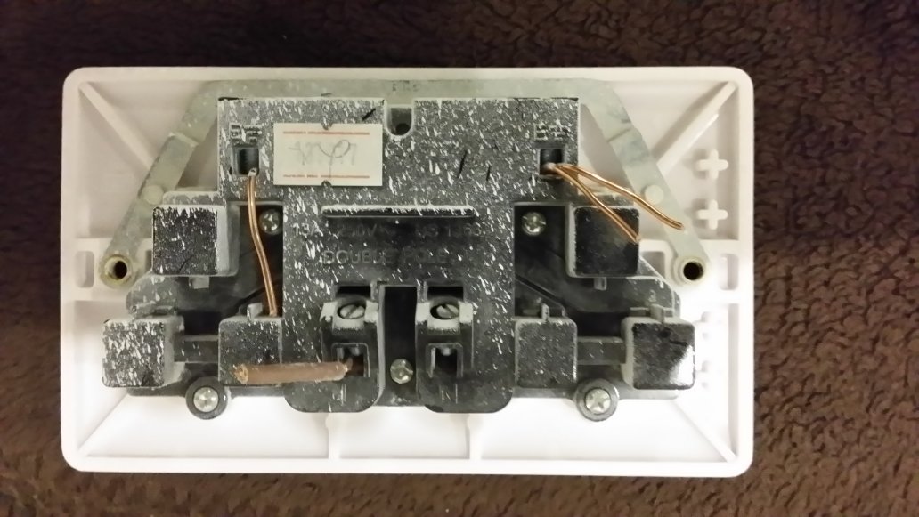

Just to let you know, I'm still planning this project! For the past month I've been feeding data cables around the house among other things but now is almost the time to install the double wall socket.
I've found this wall socket that is no longer in use but I'm wondering if I'm supposed to use both earth terminals? It's going to be a spur connection (would it be still known as one if running off the CU without connecting to any other points?) so I'm assuming I can still use this unit and one earth terminal will be left redundant?
2016-03-29-22-12-26-jpg.96330
Thanks very much
