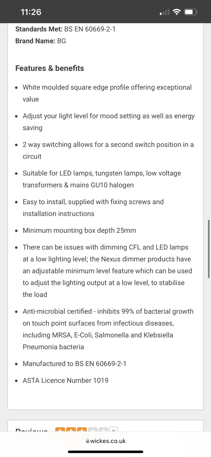

I put the new light dimmer switch and the LED light turns down suddenly, then brightens up. How come it does this eventhough I replaced the dimmer.
Incompatibility between that and the light. What is the minimum load quoted for the dimmer? What is the load of the LED?

It could be an incompatibility of the lamps or the switches, or even a bit of both. I would favour the switches being the cause, so I would suggest returning them to Wickes and trying the ones I used or or that flameport recommended.

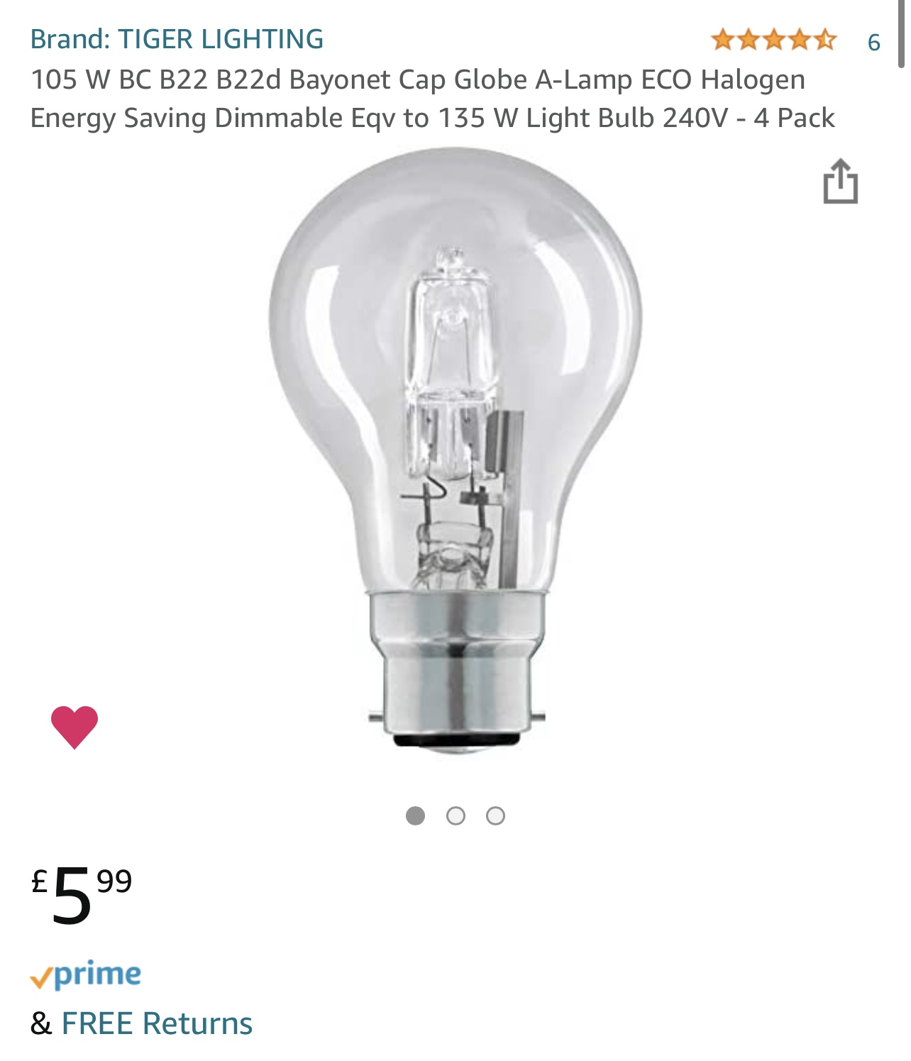

Should I try these bulbs? They are halogen bulbs which I had previously but it blew out? Do they think they will work fine?
They will work, and use 10x more electricity while doing so.
When they fail, the dimmer will be destroyed.
They are also expensive to buy, won't last long, and are not 'eco' or 'energy saving' despite being labelled as such.
The era of incandescent and halogen lamps is over.

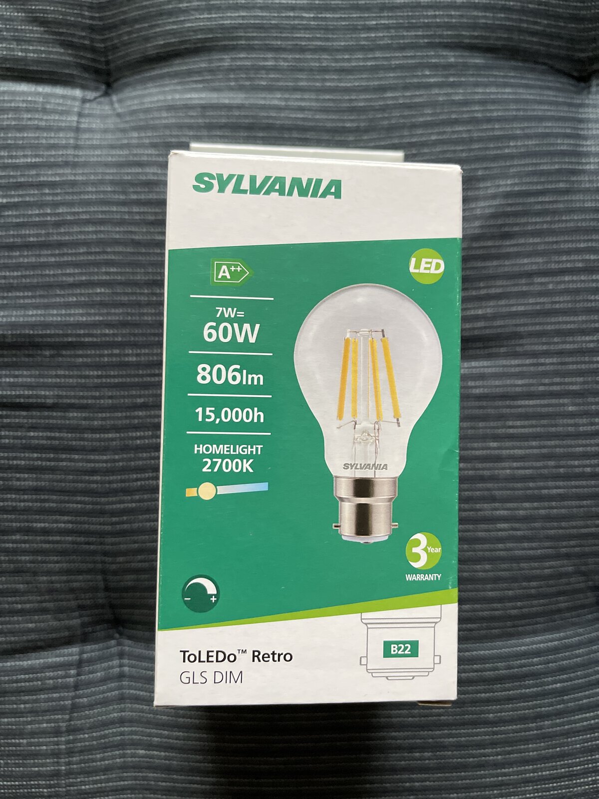

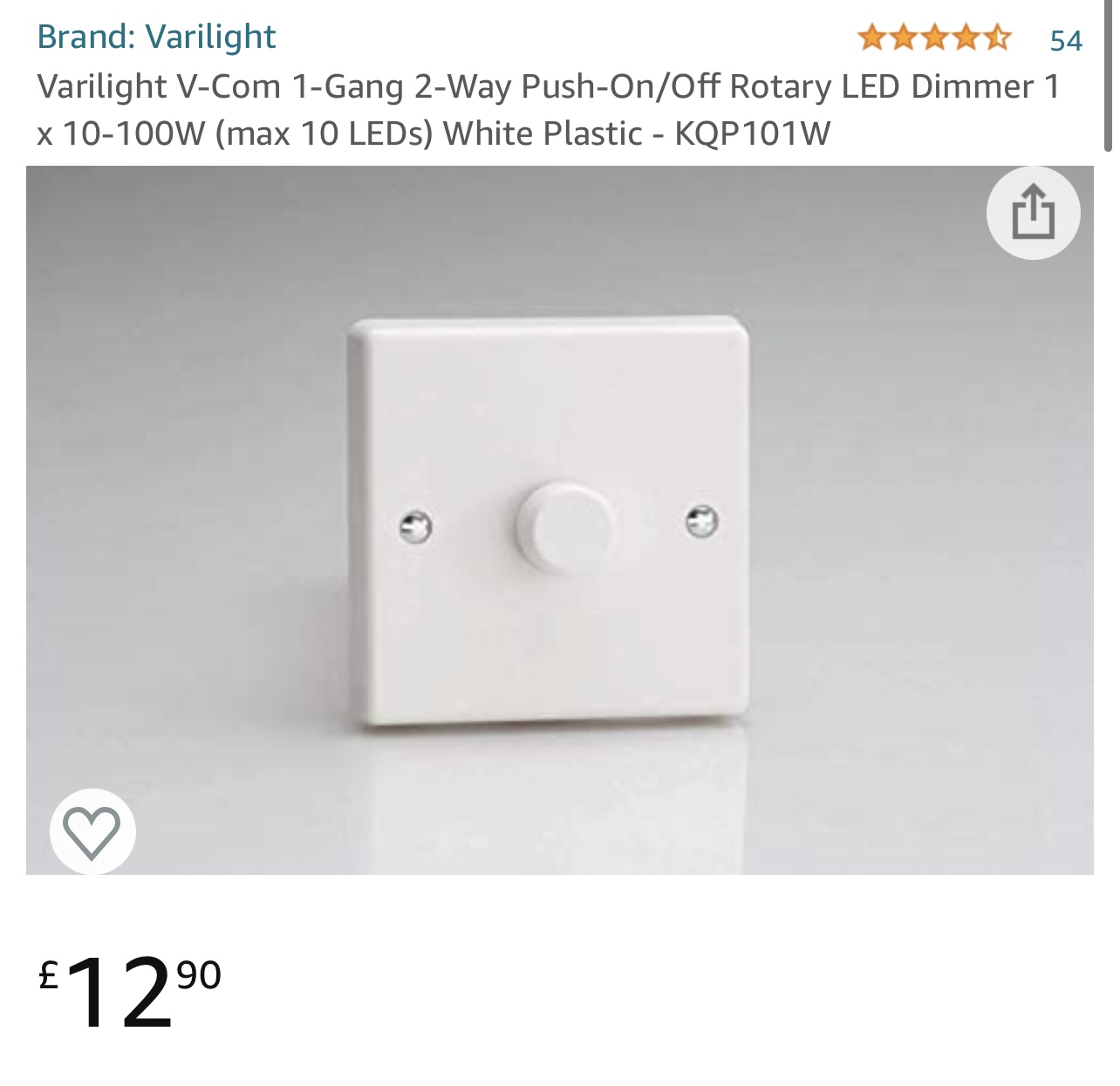

Would this dimmer be perfect for any LED bulbs. Its from Amazon. I found it cheaper than on Screwfix? I have attached an LED bulb which I purchased from wickes. Will this work fine with the following dimmer switch?
Just buy yourself a dimmer as you were recommended to do by both of us and they certainly should then work properly. If not, then you send the LED lamps back and say they will not dim satisfactorily.

That dimmer above as shown at Amazon is the same as the one you lot provided via the link. So I will purchase that dimmer and it should work work the Led light I already have!
