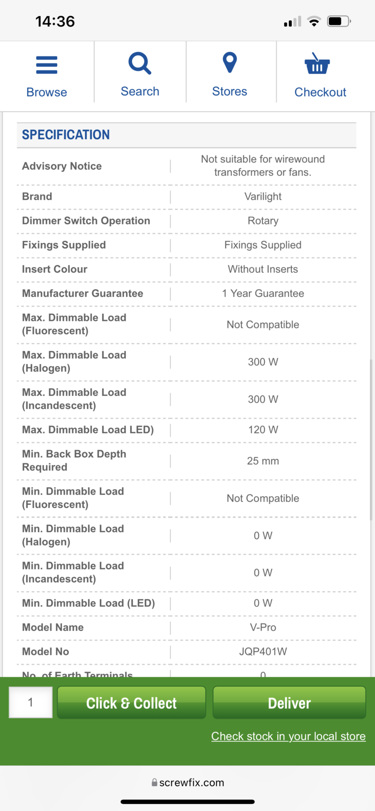

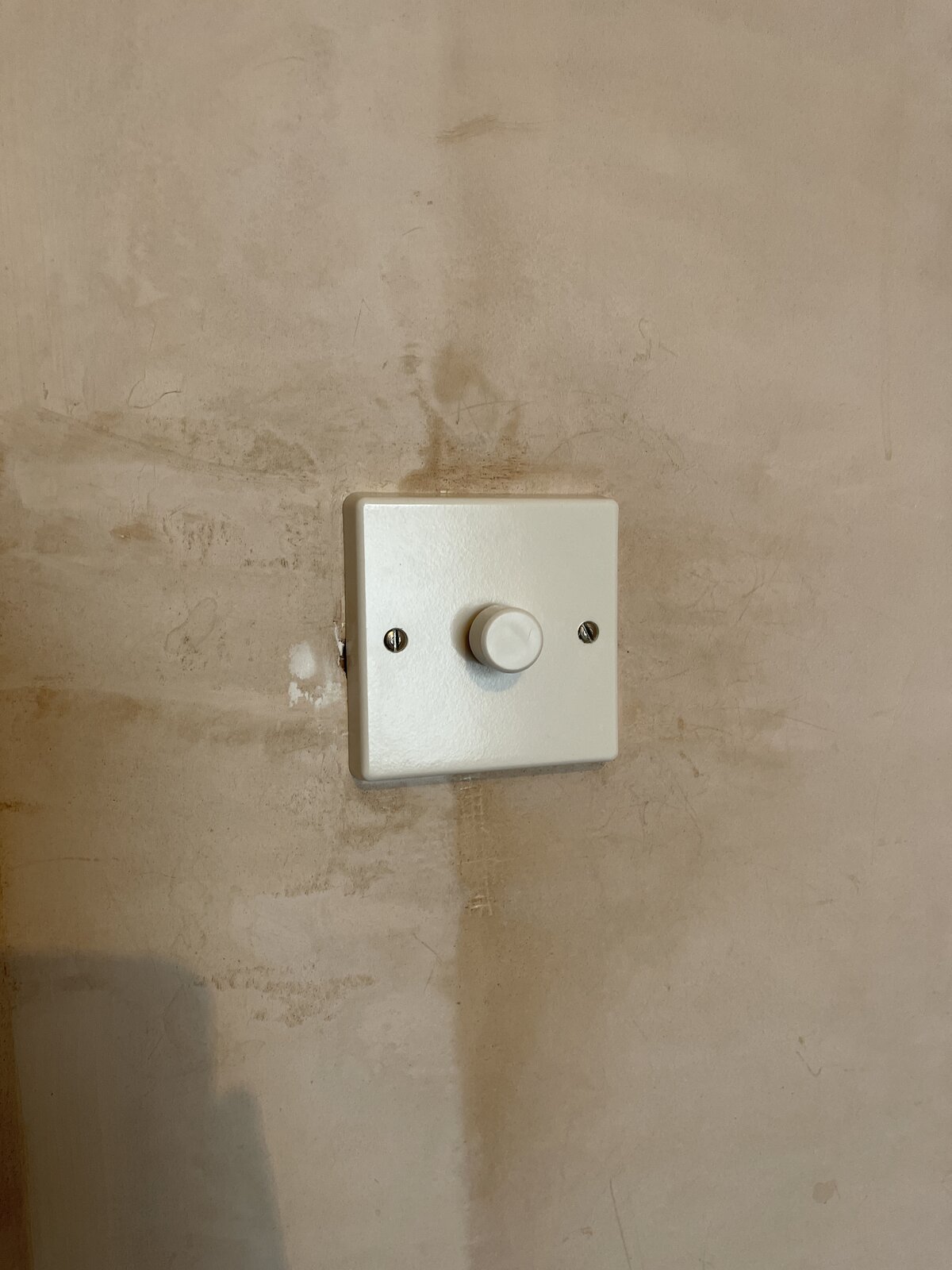

I received my dimmer switch that you lot recommended me to get from screwfix. I have fitted it on, looks good so far! If it does flicker will I have to purchase a different bulb? It talks about flickering on the manual.
Hopefully stays like this! How come I can’t adjust the brightness? When I turn it down it still stays bright.
Either the lamp, dimmer is faulty, or the two are simply not compatible.

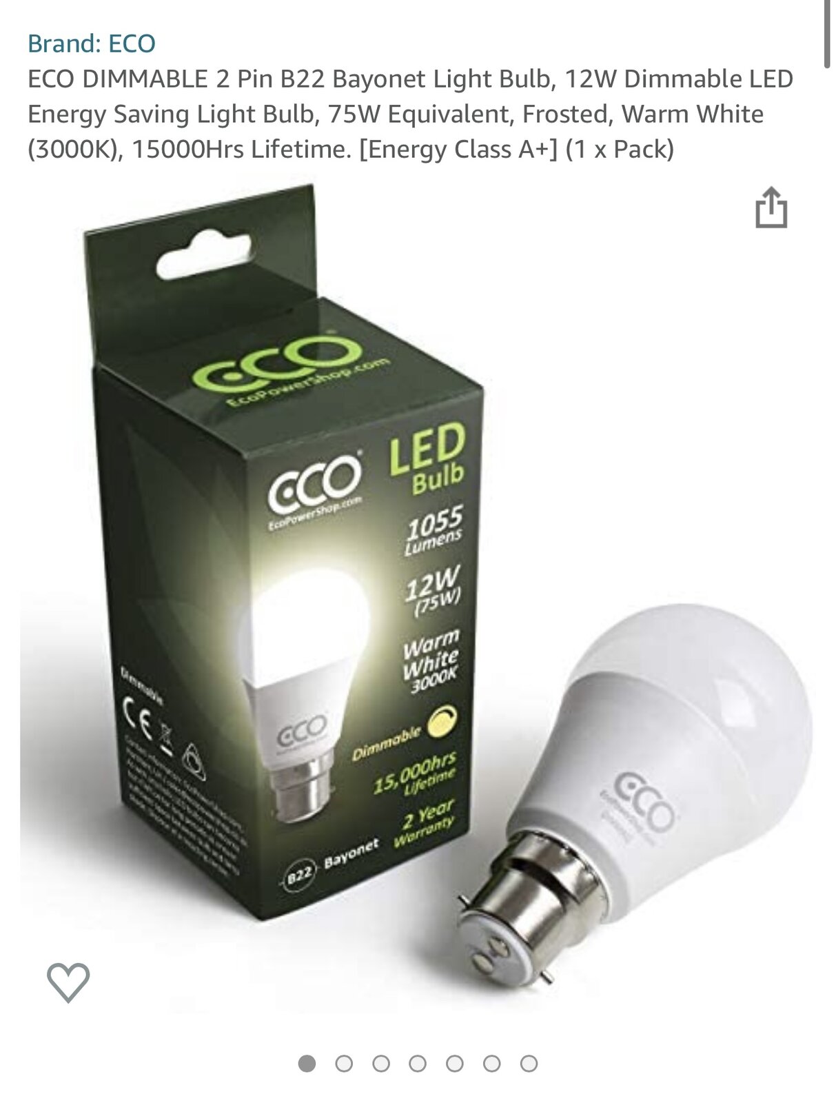

I think most likely the bulb and switch are not compatible. Which LED bulb would you recommend me to get for this new light dimmer switch which I installed from screwfix?
Did you buy one of the recommended switches by me, Flameport, or something else?
Should I just purchase a new LeD bulb. Do you think the wiring is faulty? Is it because I don’t have a neutral wire aswell?
Would this LED bulb be better than the Sylvania bulb? Its from Amazon
Flameport. The screwfix one. The one you provided from screwfix is it the same?
We both provided you with suggested switches which we had found worked, both I think available from SF, but not the same model of switch. SF do sell a number of different dimmer switches, I chose and gave you the link to the one I bought, which works fine and which was able to automatically decide whether to use + or - triggering.
As I explained - finding lamps and switches which play nicely together is a bit of a nightmare, that is why I provided a link to the switch and details of the lamps, via the thread I linked to.
