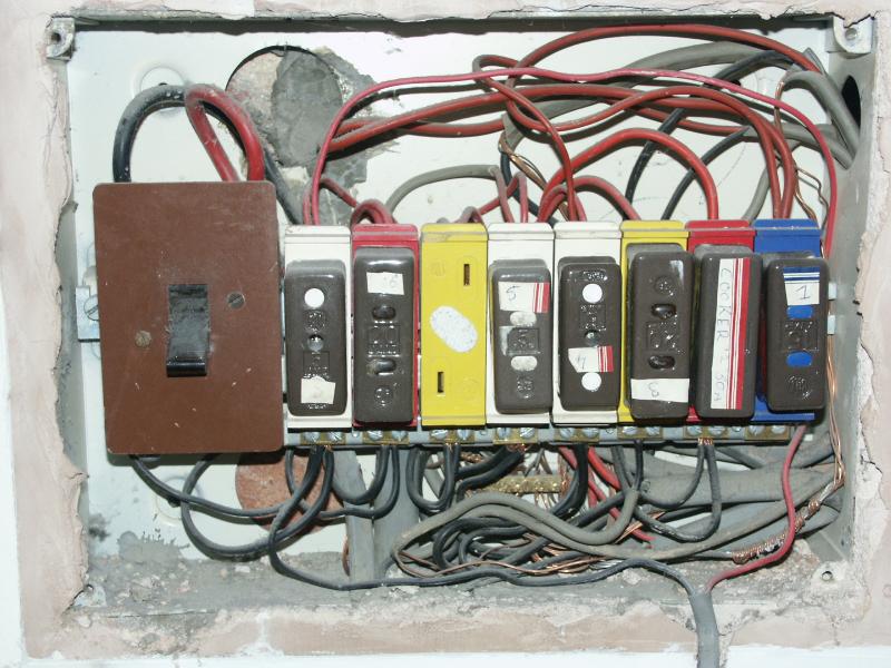

And you may have missed the point that the wiring behind that round pin plug may be so old and thin that is may fail under the load of a larger vacuum cleaner. Old rubber insulation can smoulder for a while before flames appear.
The risk is small but not zero.

Any chance for a piccy of the fuseboard and meter area?
Just like to see old installations (Yes i know, sad) :rolleyes:

I'll take my camera, rather than phone, next time I'm there. In fact I'll take phone aswell, might need fire brigade!

I don't know what PIR is, but the HIPS has been done. Nothing was mentioned about electrics until buyers lender asked for certificate to say electrics were safe, as surveyor had concerns. Electrician had quick look and just said it needs a rewire. Sale has fallen through, although not due to electrics.
I know ground floor has been rewired, as I can see the wires, not just the sockets. All new (maybe 20 years ago!) wiring is visible, ie around doors, along skirting etc.

Though it's probablly not worth getting one done in this case. If you see sockets like that it's almost a given that the wiring behind them is well past it's sell by date and a rewire is needed.
BTW if at all possible DO NOT interfere with the old wiring unless you are ripping it out to rewiring. Moving old rubber wiring can often cause it to fail completely.

Don't worry, I'm touching nothing. Hoovered downstairs, haven't plugged anything in upstairs. House is for sale as is, sold as seen, all faults, needing rewire etc etc.

Not me, mines like this:
lol The cupboard door is open, hence 50 year old wallpaper. Imagine how bright it was 50 years ago!
