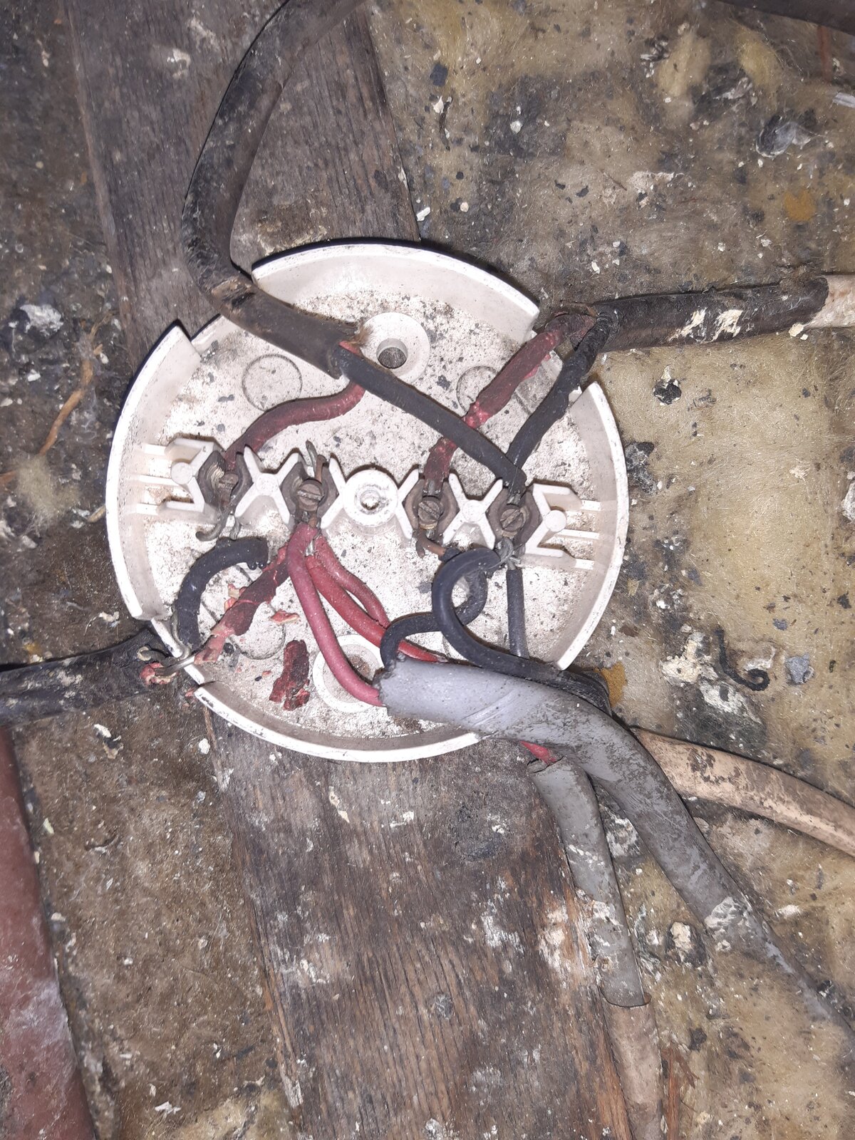

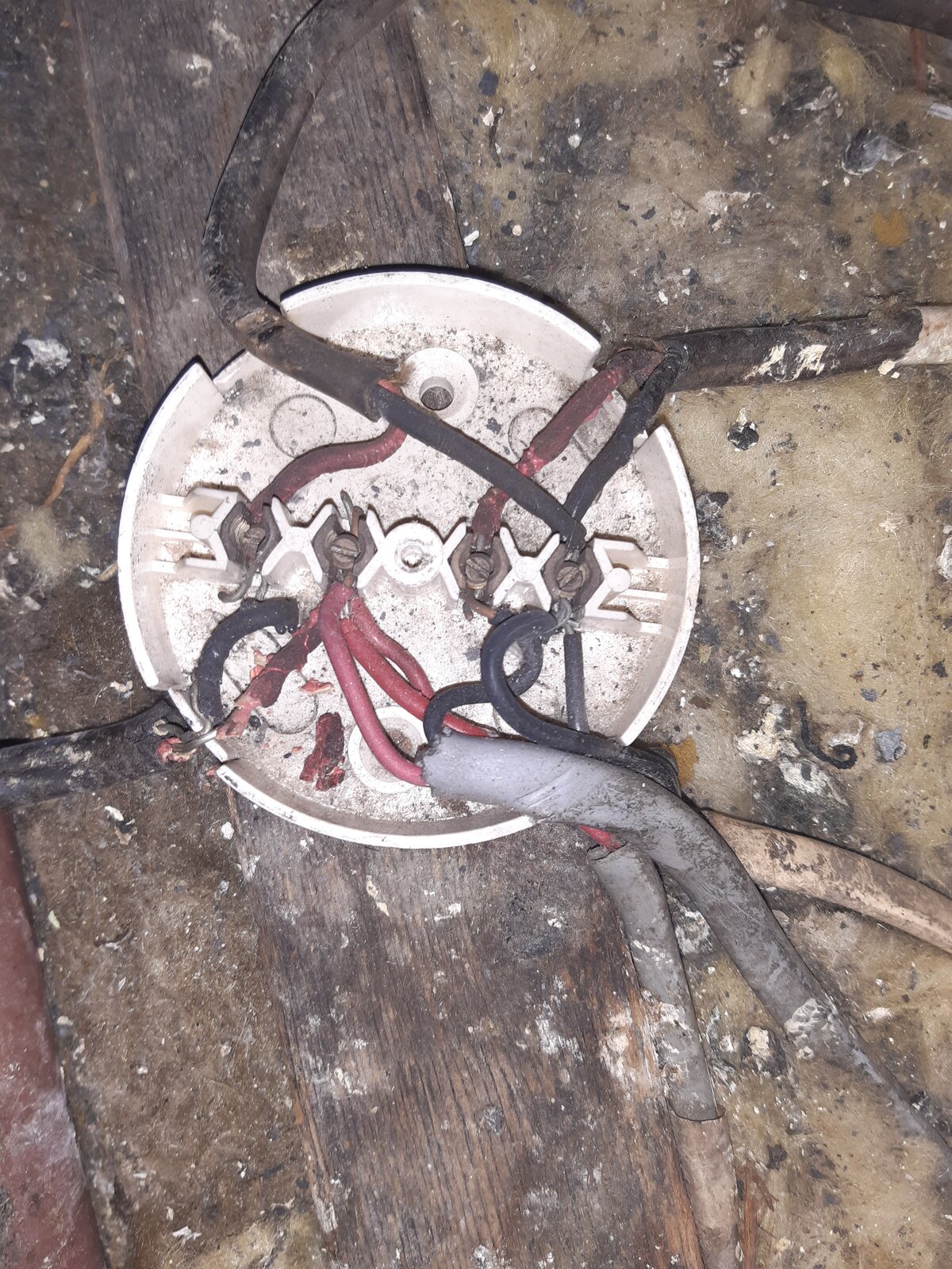

Got a call from an old friend saying "we had some pest control guys round yesterday, and now the bedroom light wont turn off"...:sick:
#dirtypigeons #loftlife
It certainly was. The visible short on the switch cable at the 8 o'clock position was the cause of the light staying on.
Oh dear, I don't envy you telling the owner he needs a rewire.
Or needed one about 30 years ago ideally! No CPCs, and no RCD, so it's something of a can of worms.
As a short term fix, I've disconnected the offending switch drop cable completely, replaced the 2 rubber outgoing cables to the roses, and fitted a ceiling pull cord switch.

Those cables appear to have solid conductors. If that's not an optical illusion, isn't that rather surprising?
Kind Regards, John
Most rubber twin lighting cable had solid, tinned conductors.
Only the 1/0.044" (0.98mm²) or rarely the 1/0.036". Otherwise it's 3/0.029" (1.28mm²).
the earlier installations tended to be solid, the later tended to be stranded as the lighting loads increased but there was no hard and fast rule.
