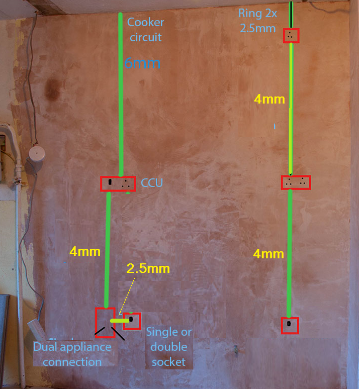

Planning Kitchen Wall Electrics - Is This Good? [PIC]
OK I'm back with an updated design lol
So do you feel confident that you can truthfully and legitimately sign this:
I being the person responsible for the design of the electrical installation (as indicated by my signature below), particulars of which are described above, having exercised reasonable skill and care when carrying out the design hereby CERTIFY that the said work for which I have been responsible is to the best of my knowledge and belief in accordance with BS 7671:2008, amended to 2015 except for the departures, if any, detailed as follows:
I've been told by my gasman that a gas hob will require a socket (for protection as well as ignition)

Also the bottom right socket is technically a spur off a spur, correct?
No.

If the circuit was designed and implemented correctly (which my experience is usually the case) it will be a dedicated radial with a single 16A socket and 6A MCB or 5A fuse.
Yes, that may well be true and may be needed in the future.
However, any time both legs of the ring are in the same place, then a ring is, itself, pointless.
If what you say is wanted, use 4mm² for the spur from the position where it stops actually being a ring.
Plus, of course, other places where it is all that is required.
I didn't get to cut those chases yet, because there's always an obstruction :(
BTW the above pic would involve buying a roll of 4mm cable just for 3 meters when I already got 6mm and 2.5mm on hand.

Massive pieces of wood in the way. Anyone got any ideas of the best way around this? Notches? For the record it is a terraced house.

Well, as a diy effort good luck with the 4mm plus 2x 2.5mm into a single socket at the ceiling ! (n)
When advising what may be the best way of doing something, I don't normally check to find out what the posters have already bought.
They don't appear to be in the way.
They appear sufficiently recessed to just clip the cable.
