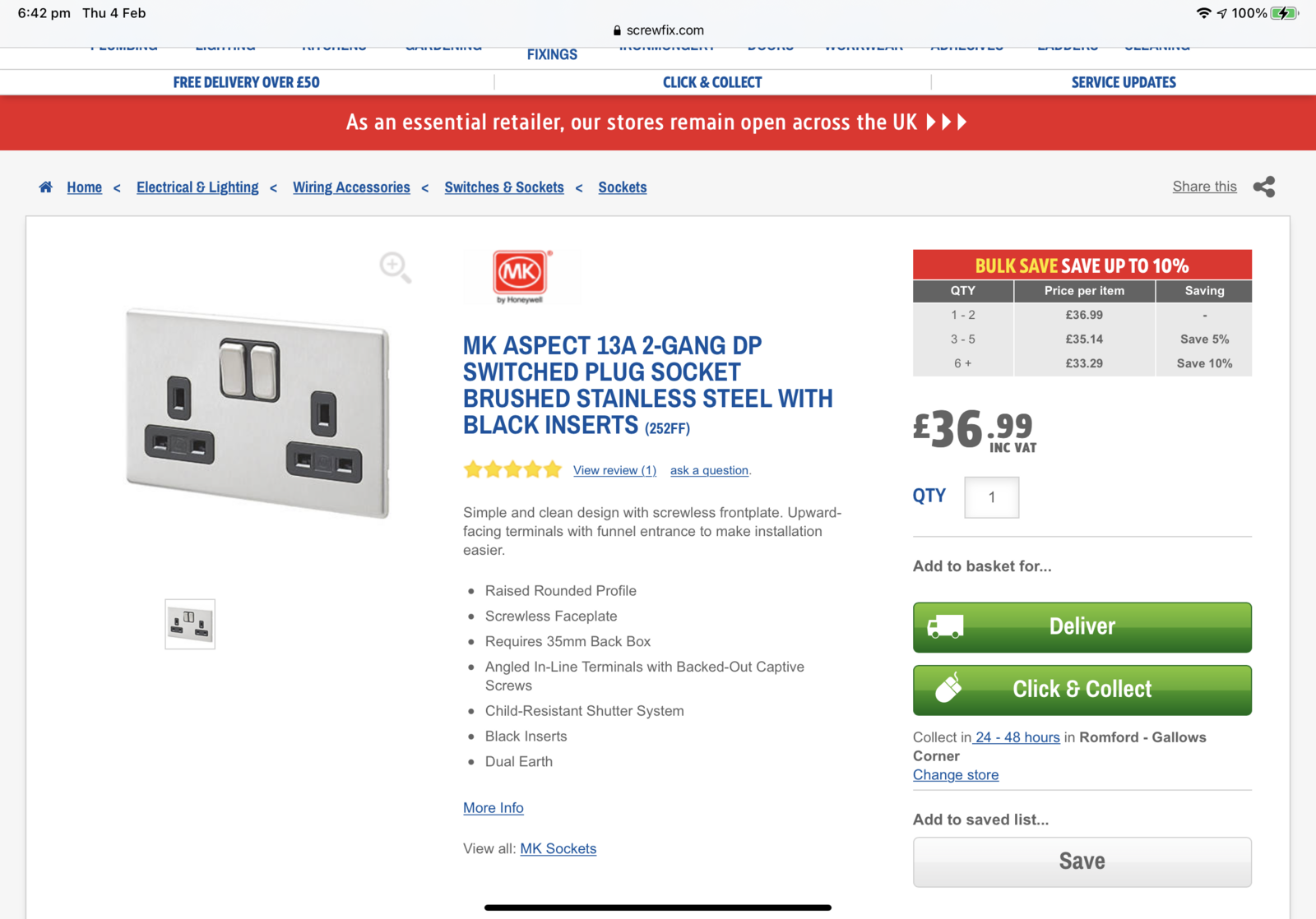

I don’t doubt it but for *£37 I would have expected some sort of quality. *I didn’t pay £37 for the originals as I fitted them about 20 years ago, that’s what I paid for the replacement. Do they have the same innards as the MK plastic sockets?
