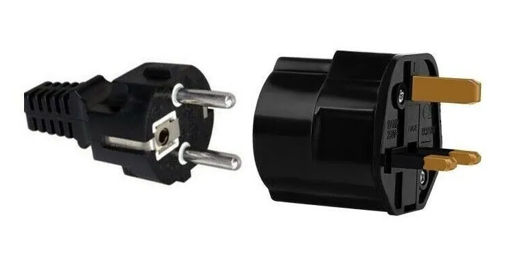

It seems the plug or adaptor needs to be fixed, so these View attachment 338006are not permitted, but these View attachment 338007 are
I presume the idea is if the converter requires a tool to remove, it won't get separated from the applicance, and therefore the user won't be tempted to do dangerous stuff to plug the appliance in.
