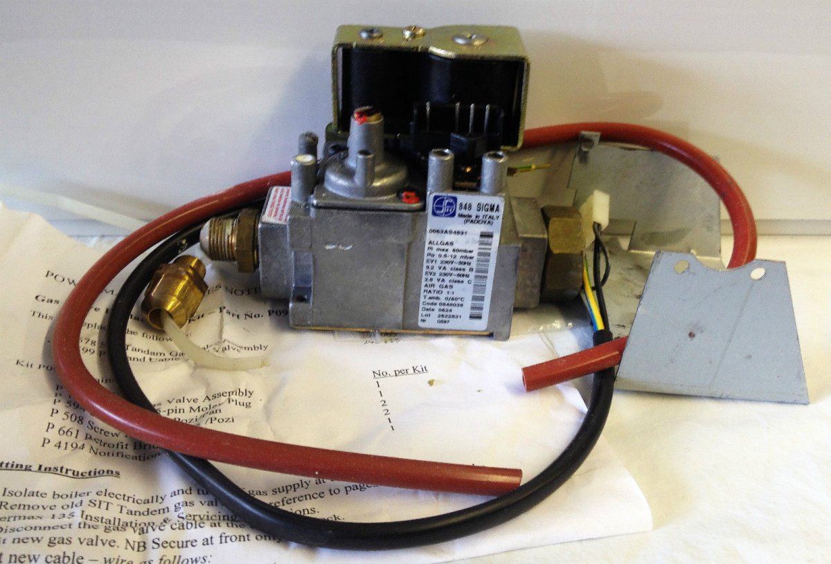

heating engineer came today and will return with parts in a few days,,,trying electrode first then maybe a new gas valve,,,I have a question,,,can anyone tell me what the replacement gas valve would be for my range powermax 155???,,,I have downloaded the parts list for the 155x as it is the only one I can find,,,im wondering if they are the same or not???,,,there are some on ebay called sigma 848 part number p090,,,and supposed to be for a 155,,,and says direct replacement for p627 or p618,,,but in the 155x parts list I downloaded the gas valve is p742,,,???,,,can someone help me out please so I can get on ordered,,,,,,here is a pic of the same gas valve as on my boiler...
thats why you got a gas engineer for ;) jesus, let the man do his job . you don't even know its a gas valve needed yet , then you will be wasting money as that is what your worried about . i wouldn't fit parts you supplied which could be from anywhere

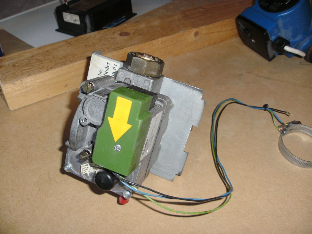

can any of you gas lads who are familliar with the powermax 155 tell me what the direct replacement is for the gas valve please,,,would the sigma 848 part no po90 replace the one above in the picture???,,,here is a pic of the sigma 848...
i thought your gas engineer is doing the repair because he would know which valve you need , i wouldn't be tempted to fit the gas valve yourself .could you give me the name of your delivery company because i could do with a company that delivers that fast ;):)
