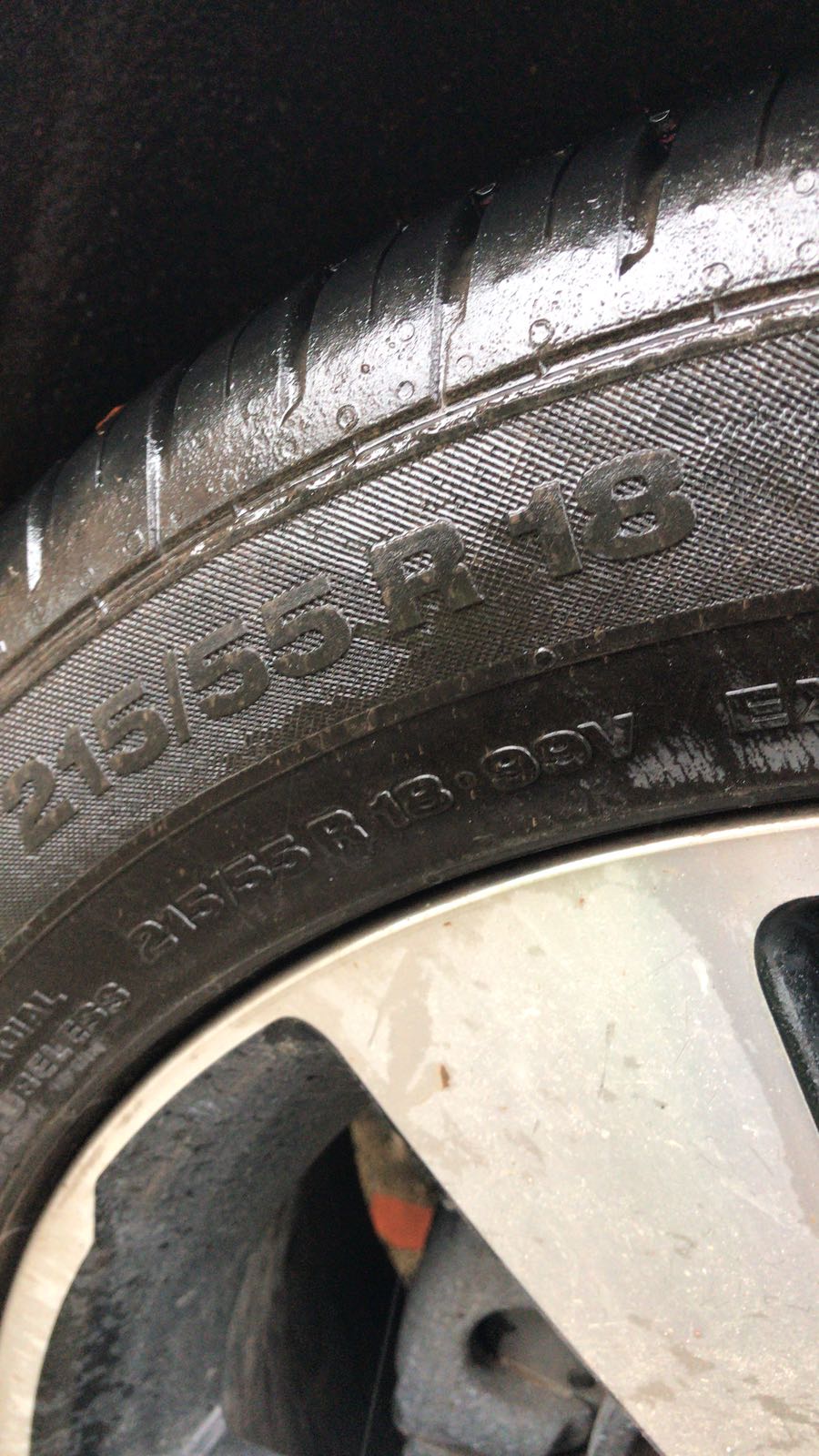

can someone offer me some advice please about obtaining a spare wheel for my daughters qashqai , 65 plate car .
I was concerned before reading the space saver post but now I realise the effect of not having a good proper spare is more worrying than before
It seems to me that the only safe answer is s proper spare, equal in size to the other tyres
Can anyone offer some advice ? Tia

Is it AWD?.
Main thing is if it clears the calipers and the circumference around the tyre is identical.
Our Kuga spare is a space saver, but the correct circumference to protect the transmission.
Hi Keith
Is AWD all wheel drive ,?
I don’t know to be honest if the car has that feature. Is it nissans version of 4 wheel drive?
You might as well buy a 16 inch steel rim, as long as it clears the larger front calipers. One of those alloys will be expensive.
A 16 inch rim with a 215/65 tyre works out as only 4mm smaller radius than the 215/55R18 tyres that you have.

How about using Ebay using following searches:
"Qashqai alloy 215 55"
"Qashqai alloy"
https://www.ebay.co.uk/sch/i.html?_from=R40&_trksid=p2380057.m570.l1313.TR0.TRC0.H0.XQashqai+alloy+215/55.TRS0&_nkw=Qashqai+alloy+215/55&_sacat=0
https://www.ebay.co.uk/sch/i.html?_odkw=Qashqai+alloy+215/55&_osacat=0&_from=R40&_trksid=p2045573.m570.l1313.TR0.TRC0.H0.XQashqai+alloy.TRS0&_nkw=Qashqai+alloy&_sacat=0
Your alloy and Tyre is there for £140 to £195 (offers accepted).
But you need to check to see if there is extra space where space saver was. Some cars have the space filled with Foam that you can remove, some do not.

He hasn't got a space saver to start with, or jack etc.
Keith,
I know but many cars in UK do have the space to put a spare wheel, but for UK market the manufacturers have filled it with foam. Examples of this are Mazda who for UK market do it to save weight and improve fuel economy. Many then rove the foam and put in a full size wheel and tyre.
