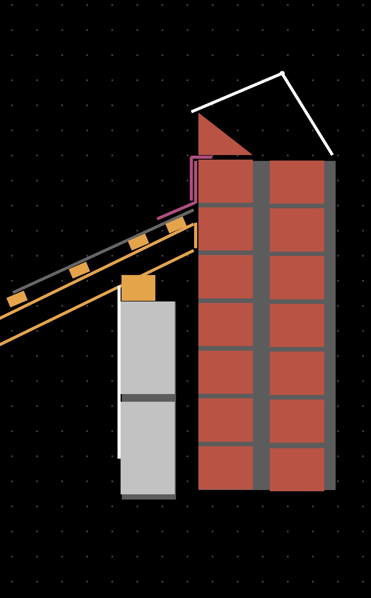

Hi all,
First time poster here.
I’ve recently been carrying out roofwork on my terrace house. Fitted a velux, replaced lead 2cm x 3cm soakers with 14cm x 10cm and cover flashing on the main house abutment wall with a drip bead rendered in immediately above the lead mate line to ensure it’s bulletproof as I’m on a very exposed steep hill.
Now I’ve turned my attention to the extension finally, I’ve discovered:

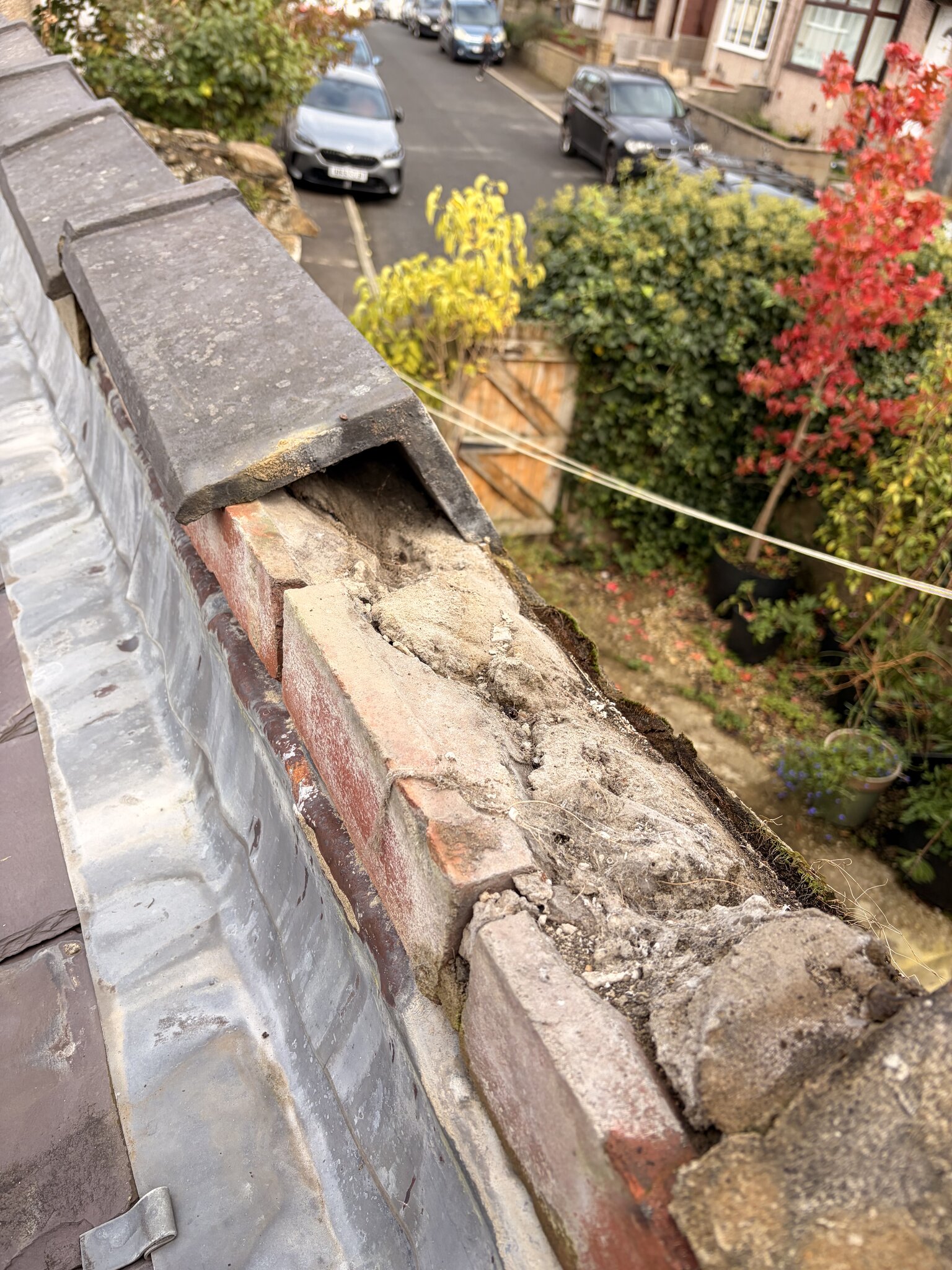

- Lead is knackered, cracked in places as they just rolled 3m of it and fixed it in continuous lengths plus its old.
- Ridge tiles are loose with no mortar anywhere.

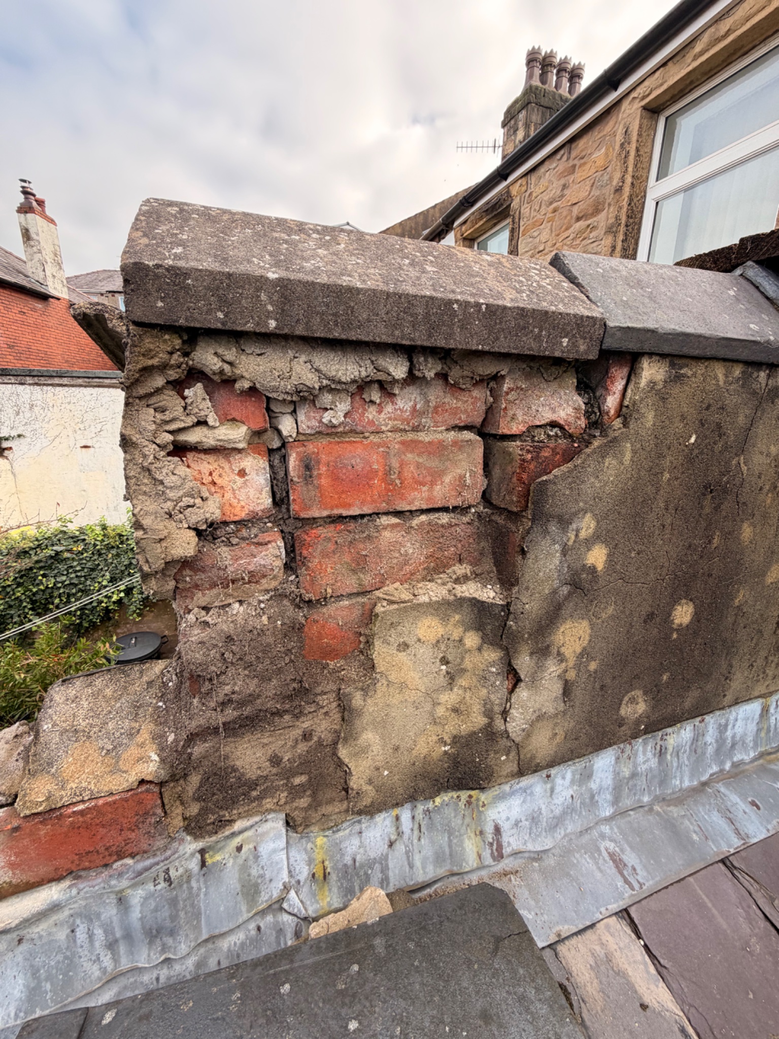

- Top sloped brick course immediately above the chase for cover flashing is loose.
I’m trying to work out what would be the best way to approach this. I could rebed the tiles and render the small wall drop down to the chase where I’d use leadmate again. But I don’t want to create a situation where when the roof comes to being replaced (probably in a year or so) inserting new lead pops off/cracks the render and single brick/ridge above.
I’m open to any ideas on how to approach this, perhaps even improve this janky setup.
On the other side of the wall is my neighbors yard. A little further back is where his extension ends and the party wall steps up to his roofline.
Thanks,
Alex

Can you do a sketch of what it looks like, on each side of the wall, as a section through the wall?
E.g. is it where two pitches meet, or is it where a pitch meets a vertical wall, or two different height pitches etc?
OP,
Where the party wall in pic#1 extends above the roof abutment it becomes a parapet. Is the party wall solid or cavity?
In your case, first thing might be to drop the full length of the "lower" (pic#1) parapet to the abutment line - & see what you've got before any remedial rebuilding.
Does pic#2 form part of the neighbor's extension? Or is it also part of the parapet? Whatever, it also needs rebuilding.

Hi Ree, the parapet wall is solid brick with clinker infill. A header course is every 5 courses. My extension has its own thermalite block wall with a 5cm cavity between it and the solid one with a DPC tied into the floors DPM.
Thinking that may be the direction I’ll need to go with it, the lead cover flashing could be replaced at the same time.
Pic 2 does indeed, since posting that amazing brickwork came loose after I chipped away the render gently. It was held together with… mud. I’ve rebuilt it now properly keyed into surrounding bricks and reinstated a matching ridge tile. I can see this area has failed when the people replacing the roof on the rental next door drove wood wedges into the perp where my bricks aren’t keyed into anything. There’s only slight damp issues where the extension adjoins the original rear wall of the house on this side, but nothing major.

So no opposing roof on the other side of the wall? Therefore no potential to create a ridge by reducing it and roofing over it.
I'm trying to work out why it's so tall.
Nice piccie!
nope, as far as I can tell the height is that to meet with what would have been the roof ridge on the coal store at the end of the yard. On most of these properties they are long gone.
The stagger between properties is 1.4m, making this wall 3m tall to ground level on my side.
I did consider lowering it by 1 brick course and using spare slates I have to create a proper ridge detail. But seems far from ideal, besides there’s nothing to attach a batten to up there.
It's a party wall so trespass is out of the question. It should remain as a parapet. You need to agree costs with the neighbour to tidy up the brickwork and finish the parapet correctly - i.e. with a coping etc.
If this was your property alone, you'd likely extend the rafters so that the roof tiles travel far enough upwards to be covered with a 'mono ridge'.
