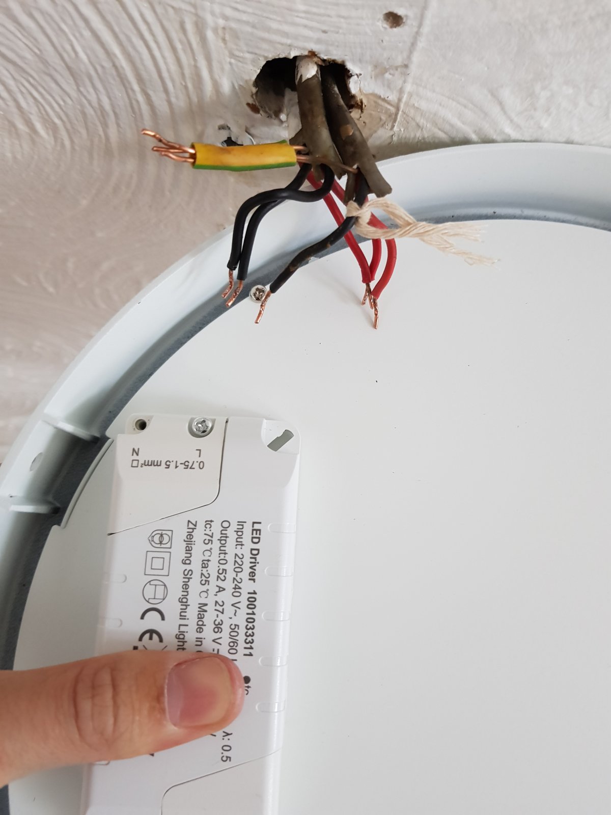

Hi all,
Replacing kitchen light but not sure of the wiring. 2 light switches in kitchen, old light was a strip light.
3 live, 3 neutral and 3 earth.
There is nothing indicating that 1 of the neutrals is a live.
Please help lol
Many thanks
Lee

I thought it may be the live out of the 3. So with my light... do I isolate all 3 reds? Find out which is the live out of the 3 blacks. Pair up the 2 blacks (neutral) then single out the black which is live. Connect to light obviously 2 blacks to N and 1 black to L. There is no where to put the earth so do they get isolated aswell?
Why did you think that?
Sort of. You connect them all together.
That's right.
Connected together, yes.
Yeah isolate the 3 earth and 3 reds as a group of 3. Right... thank you I'll go get my multi meter. Thanks for your help.
Connect the three together. Isolate is not quite the right word.

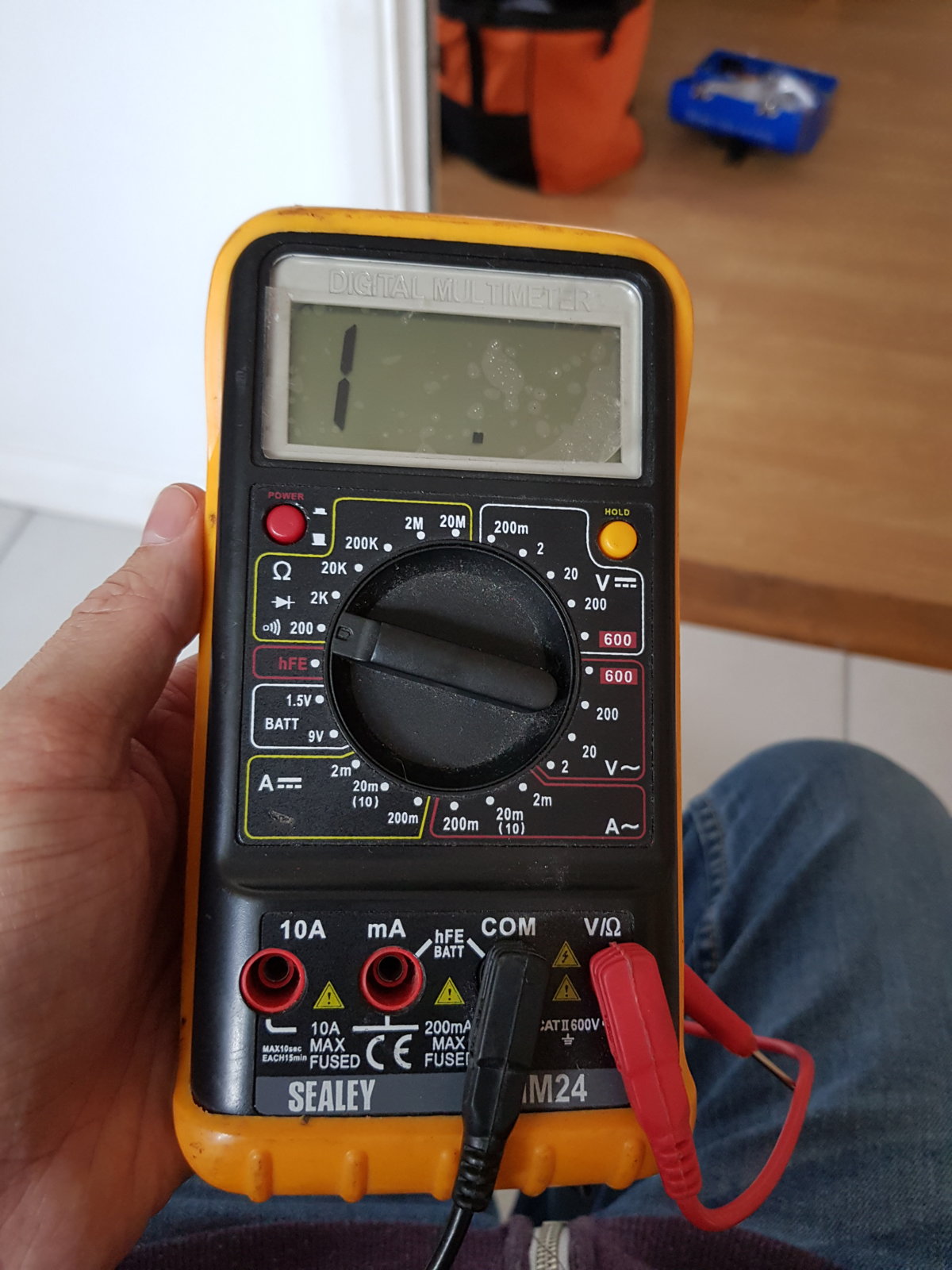

No beeping beeps. Fuse is out of box so all power to house lights out. Is that right?
Yes, that's right.
One of the cables should beep when you turn the switch on - if it is wired the usual way.
Power OFF
Neutrals will be connected together at the CU.
Try with probes on two of the blacks, and then a different two.
Is there one which does not beep? That is not connected to the other two.

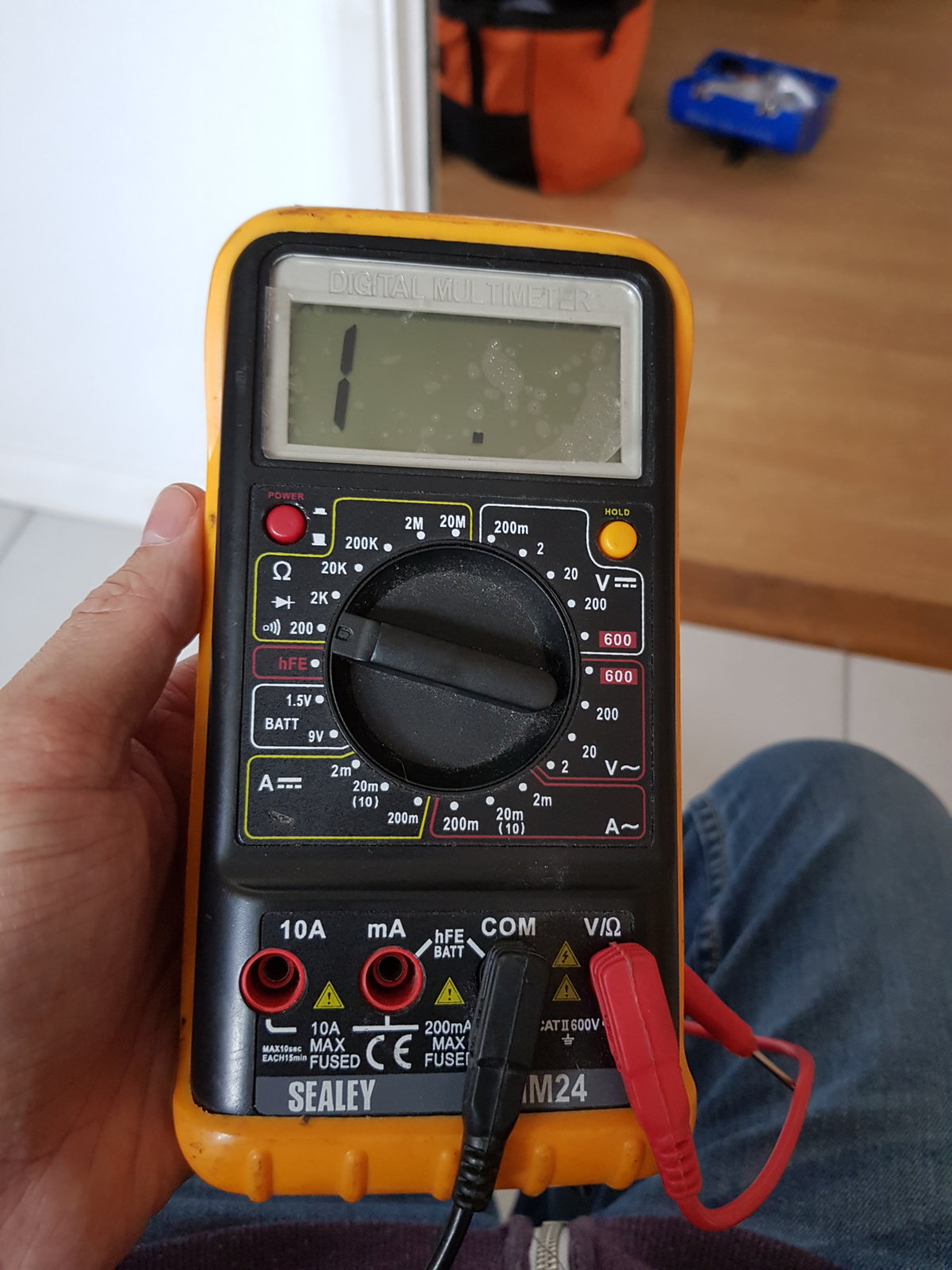

This is my setup. When probs touch they beep.
