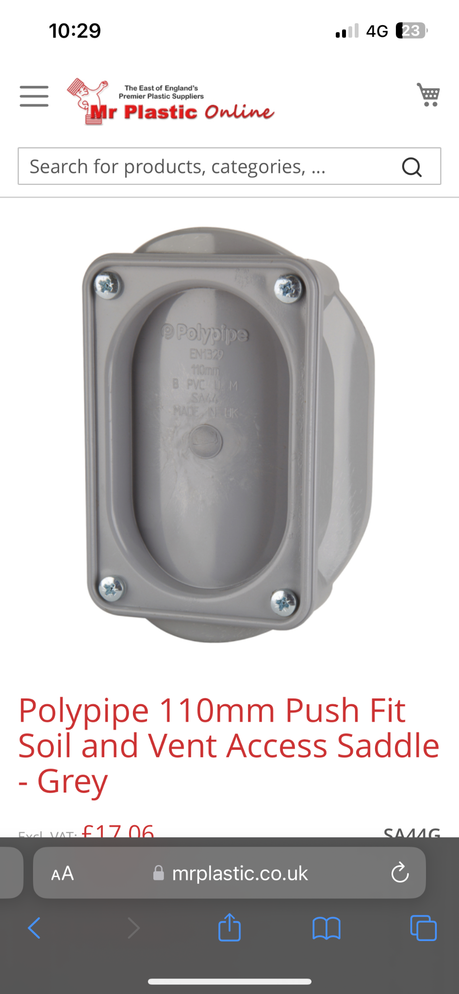

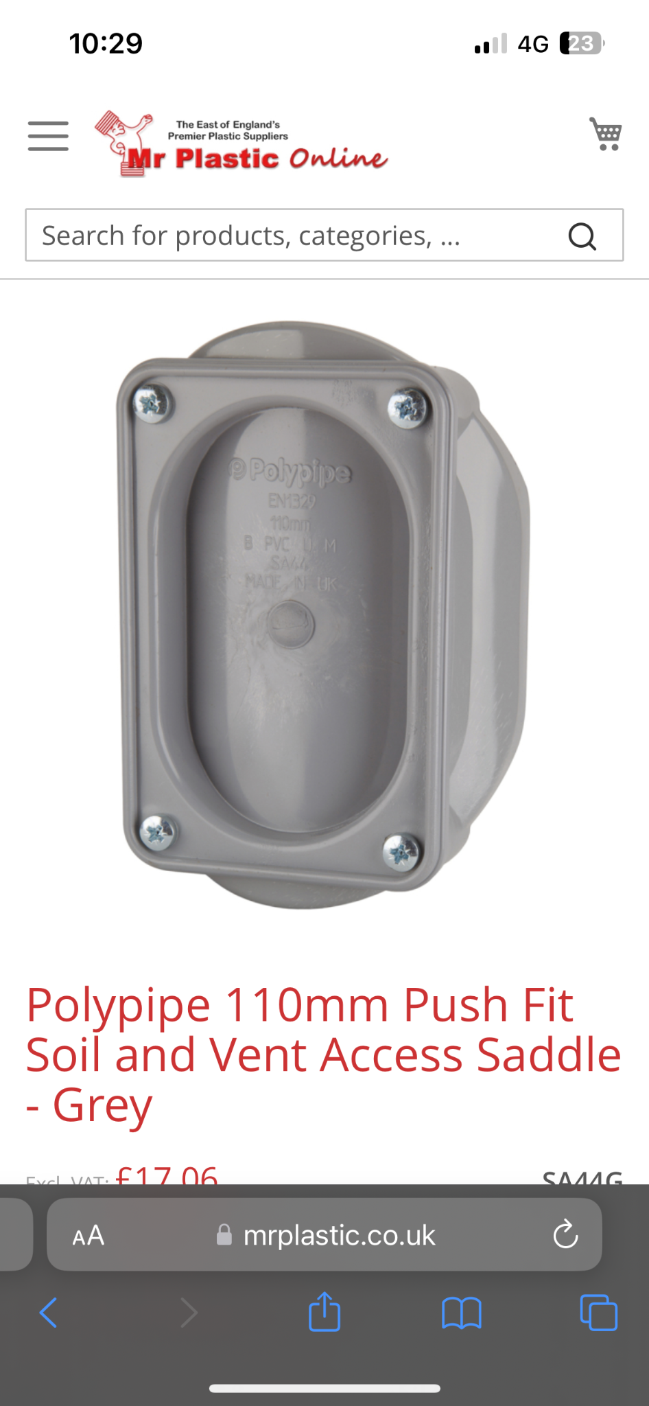

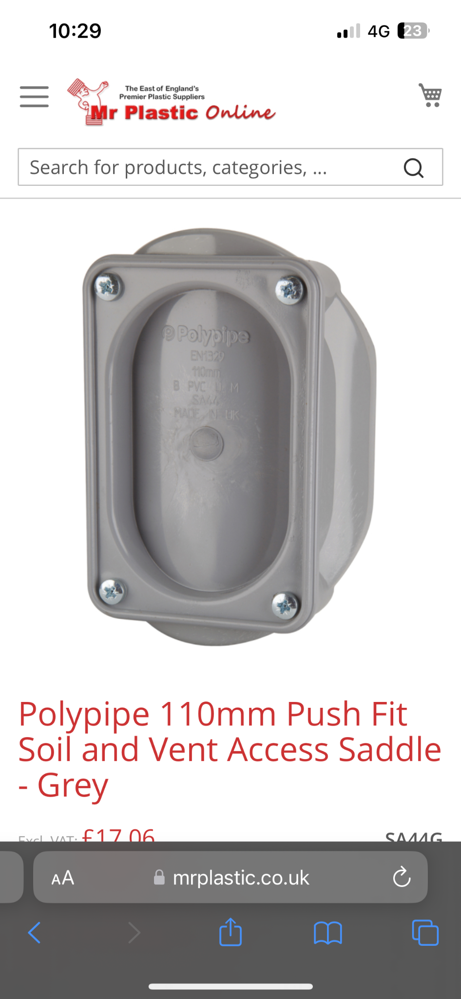

Morning. An inspector has asked I fit a rodding access to new 110 waste pipe which runs from an upstairs bathroom.
I’ve purchased one of these (see below) and wonder the best place to attach.
Thanks.

Any access point must be fitted in a place where it can actually be used and rods used easily, not where it is easy to fit or looks good
I’m following a builder doing some snagging. The client wants it. Was going to fit it on top of the the horizontal run so it definitely won’t leak. Means you need a step ladder to access for rodding.

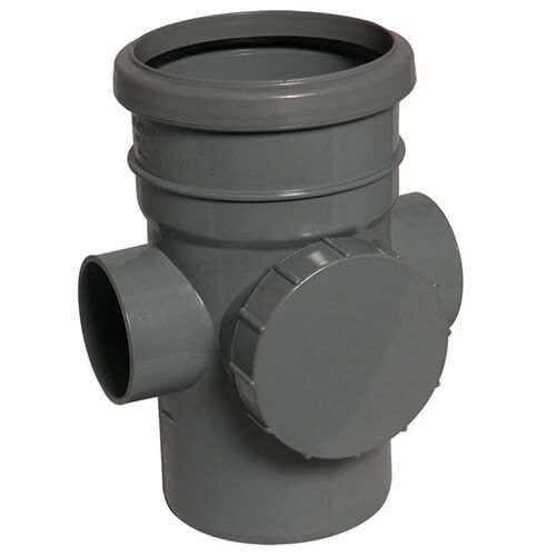

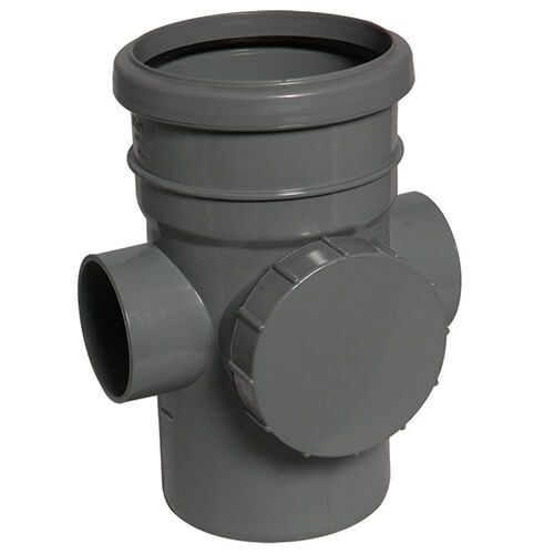

I fit these for access in soilstacks:

More for CCTV by the looks of it. I need rodding access.

You would normally incorporate a fitting like this as you build the stack...
Yes but the builder didn’t and I dont want to mess about with the already installed stack. Hence the retrofit.
I've had a similar issue. Council BC demanded it... tried to argue, but there was no way. They would not issue a compliance certificate without it, so builder fitted a boss connector at the bottom of the svp so its reachable w/out any ladders.
