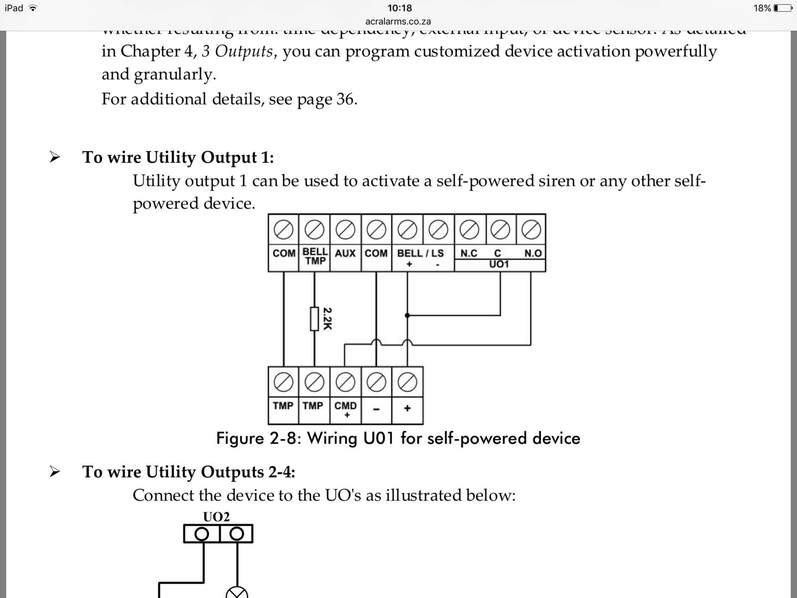

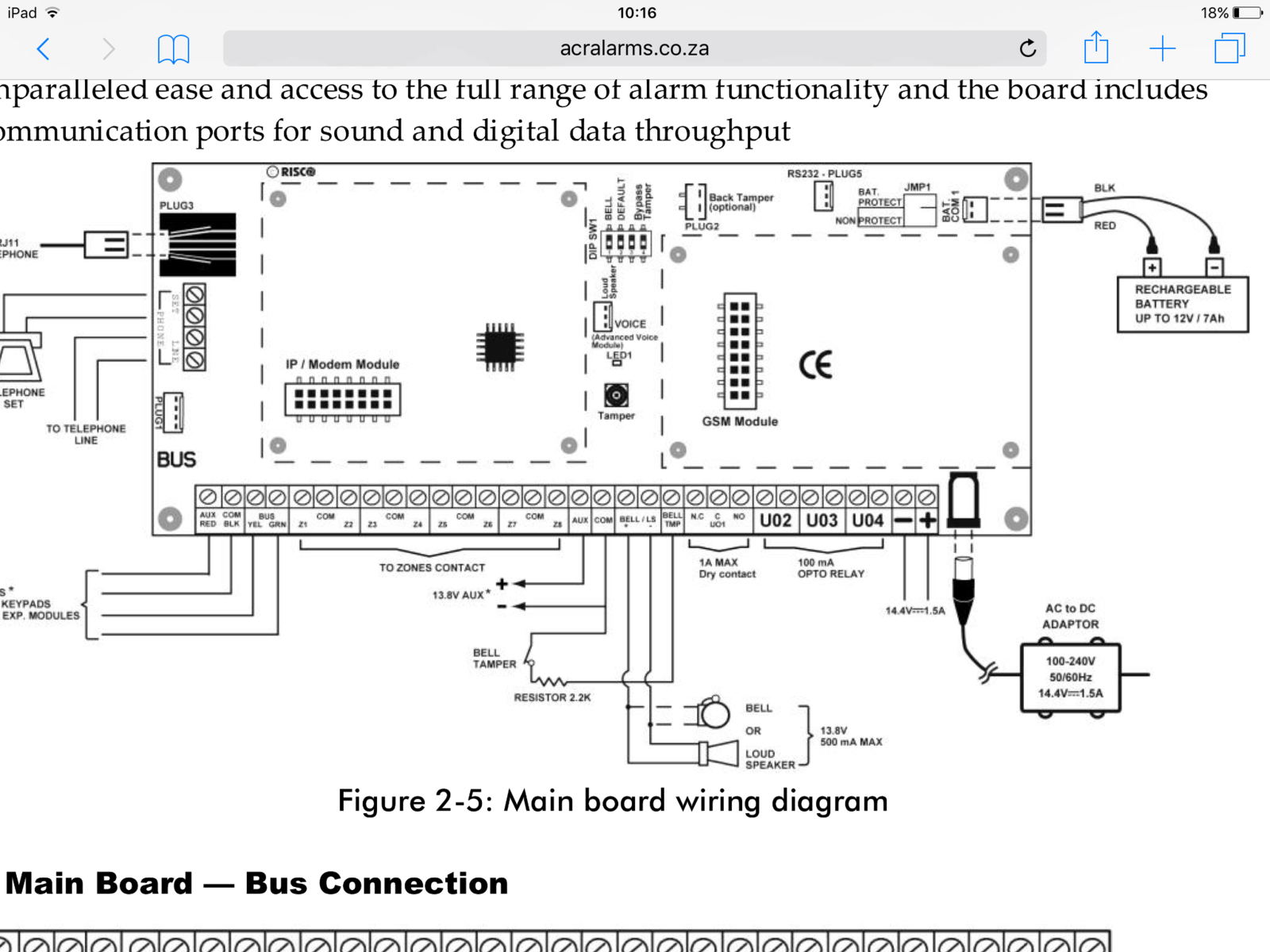

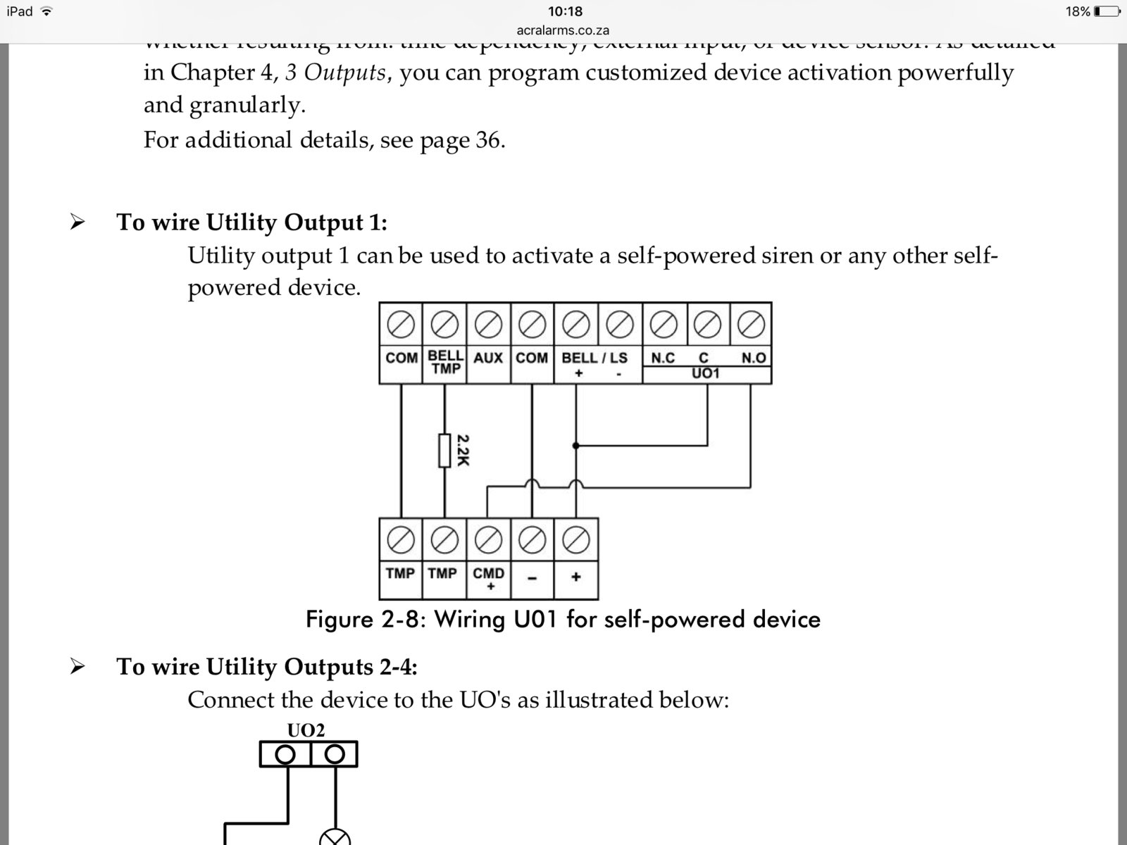

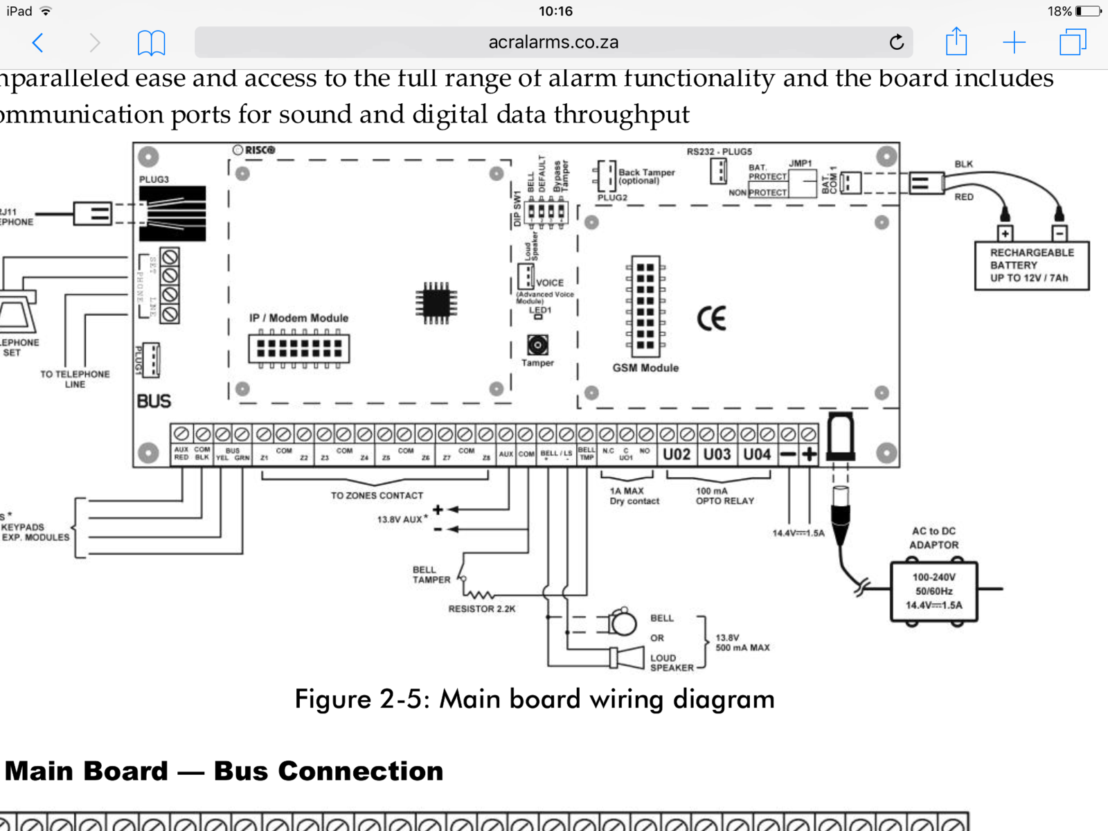

IMG_2232.PNG IMG_2233.PNG Looking at a Risco manual looks like the bell is positive ring ( unlike most U.K. Panels )
But without knowing what the siren is ? You could use the relay option as above and either can be used
These screenshots are indeed from a pdf I have and they match my board. The BELL/LS connectors are positive and negative vdc and they are connected as per the diagram (at least based on the wire colour).
DIP SW1 toggles between Bell (on) and LS (off) but on a voltmeter I haven't noticed any change in behaviour.
Sorry - I'm not sure what relay option you mean?
I guess there is a chance that the board is defective but I have to admit it's defective in an odd way
as pointed out the wiring diagrams do not mean anything without identifying the options available in the bell box.
Okay, I a going to guess that your bell box has the three connections only.
positive, bell tamper and bell trigger only.
you have a permanent negative and a permanent positive to what effectively is an old fashioned on off bell. When wired is bell permanently on, not wired off.
you need to remove the LS- (permanent negative) and wire to the U01 and program up the output for bell.
post back as you go along so we can attempt to guide you through this, be aware the assumption is being made that the bell box only has those three connections available. Personally longer term I would swap the bell for something better.
