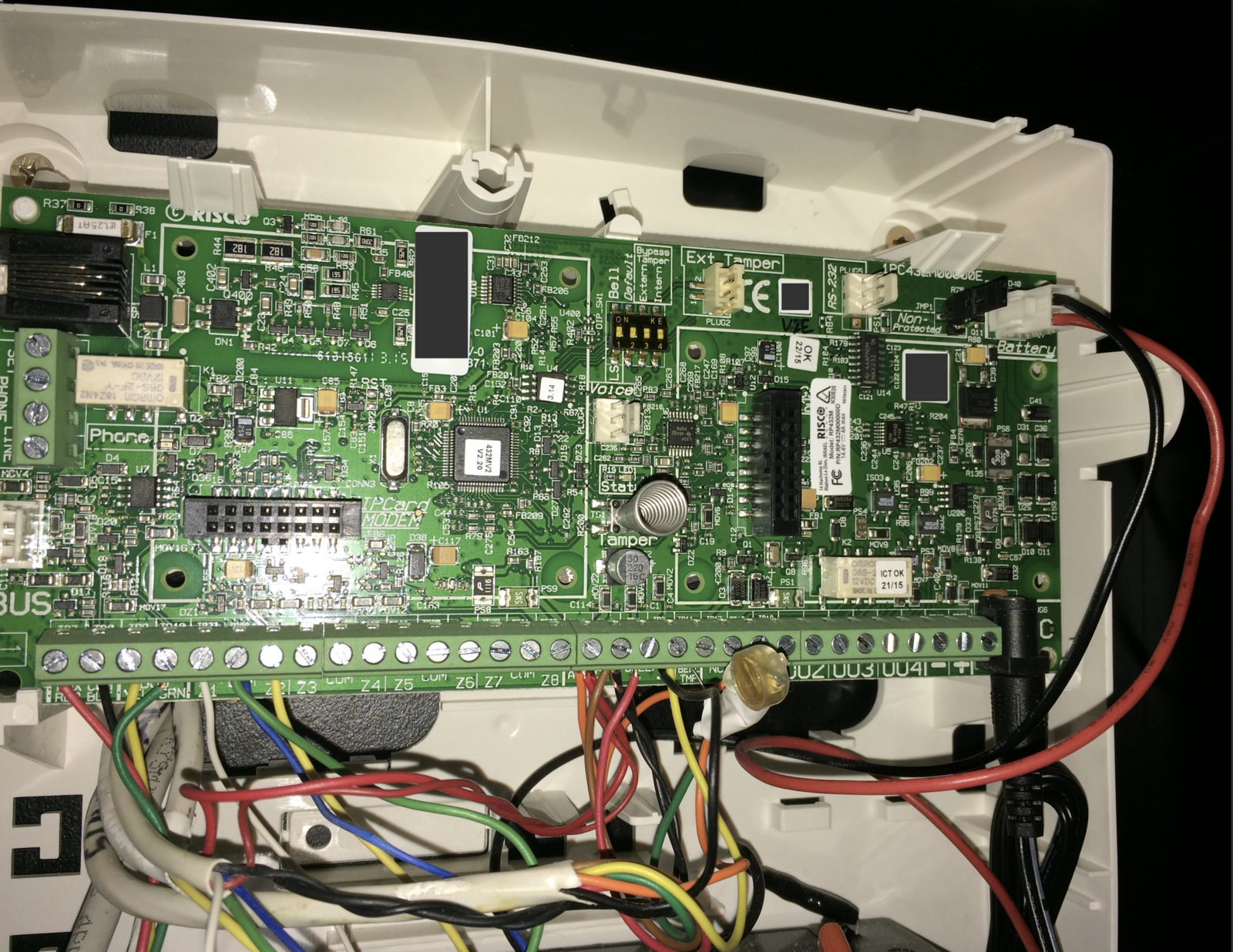

I've attached a photo of the main board. Unfortunately I don't have access to the bell box so I can only guess the wiring towards there.
From what I understand, in the photo attached:
Wires 1-4 go to the keypad (this I can confirm)
5/6 and 6/7 appear to be the data for the PIRs
8-16 - Not connected
17 and 18 are positive/negative VDC
19 and 20 should be positive and negative for the bell (box)
21 is a (what appears to be a 2.2kOhm resistor that goes to the bellbox). If I remove it I trigger a tamper alert)
(not seen in thep hoto but)
23 is a short loop to 17
24 is a green wire that goes to the bell box.
If I leave 19 and 20 connected the outside siren goes on continuously, no matter what I do on the panel.
If I disconnect it I get a warning about the bell loop but the arming/disarming process works fine. And as I mentioned above, on those pins the voltage is about 12VDC when the alarm is disarmed and goes to 13.6-13.8 when it's an alarm.
The keypad is a 432KP.
Thanks for your patience :)
