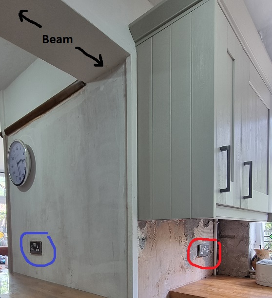

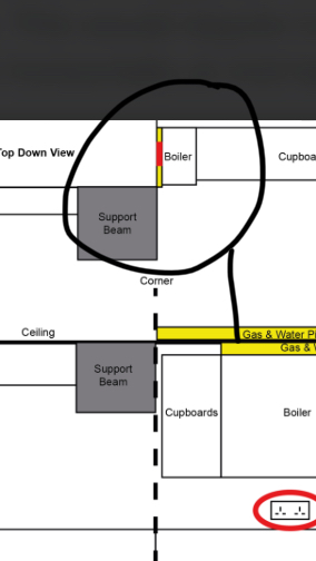

Running a cable around a corner
You clearly don’t understand that the cable would have to pass along 3 walls and the middle one doesn’t have a safe zone
Eh?
I think you're probably getting confused by the beam, which presumable exists only near ceiling level. If I understand correctly, at the level of the socket there appear to be only two walls
Three walls?
There are only two walls at 90 degrees from each other.
What about the wall the boiler is on ?
It does say top down view
As I understand it, that's the wall that the OP's 'red' socket is on (below the boiler). As I said, the beam only exists uop high
Indeed, because that's what it is, but, being 'top down', it doesn't show you that the socket is way below both boiler and beam - you need to look at the second pic to see that.
Again, unless I'm missing something, I would say that you are unnecessarily introducing a (confusing for OP) red herring into this thread.
If, as seems to be the case case, we're just talking about two sockets at the same height on two adjacent walls that meet at right angles, the (non confusing) answer for the OP is extremely simple, and I provided it in post #2.

Thanks to everyone thats tried to help me with the post. I hope this helps with any confusion.
I must admit that I saw that as essentially 3 walls, One with the red socket on it, one with the blue socket on it and the third on the short wall between them because it steps the other two back "dog legged" fashion, this short wall joining to and at 90 degrees to to other two would have been the one in question as to whether it is exceeding 300m and has any points on it.
Therefore is it a short wall forming an external corner to the LH wall (Blue socket) and an internal corner to the RH wall (Red socket) if more than 300mm there is no zone joining the corners unless it has a point there to identify a zone.
Although I think most would suspect cables might be present below finish wall level, it was not actually a zone.
Now we`ve seen the pic it does clarify a bit, before the pic we could only go off the drawing.
I think that some of us, because of trades working, have seen walls in all sorts of fashions, some you`d never expect in a million years unlessyou`d been in enough properties.
Yes, when I first saw the 'plan' diagram I did, for a few seconds, have the same thoughts as Murdo and yourself.
However, when I looked at the second diagram, I 'trusted' the OP. He had very clearly indicated a corner (with a dashed line), so I felt 'sure' (yes, I know :-) ) that had there been two corners, he would have indicated both of them.
