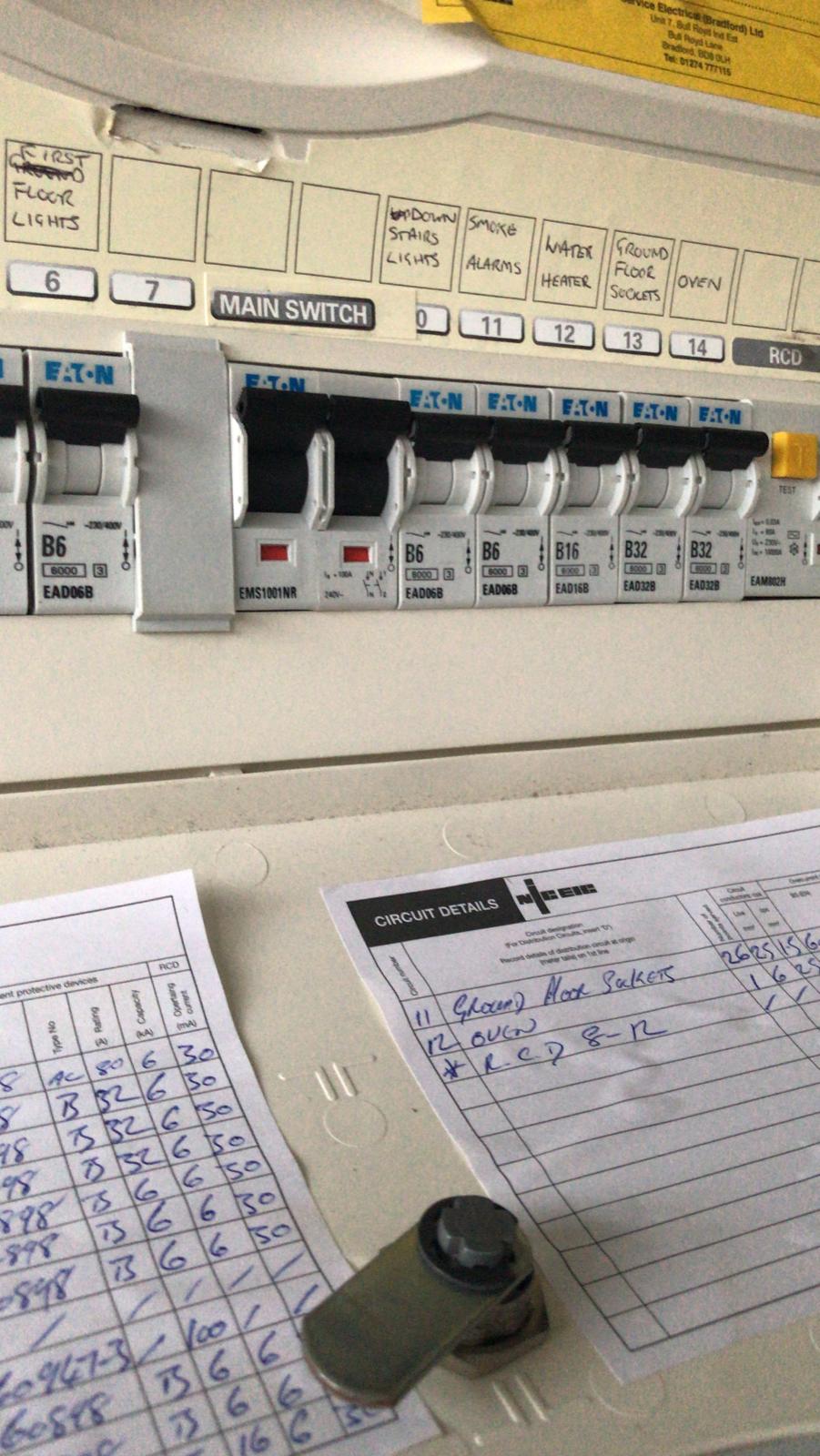

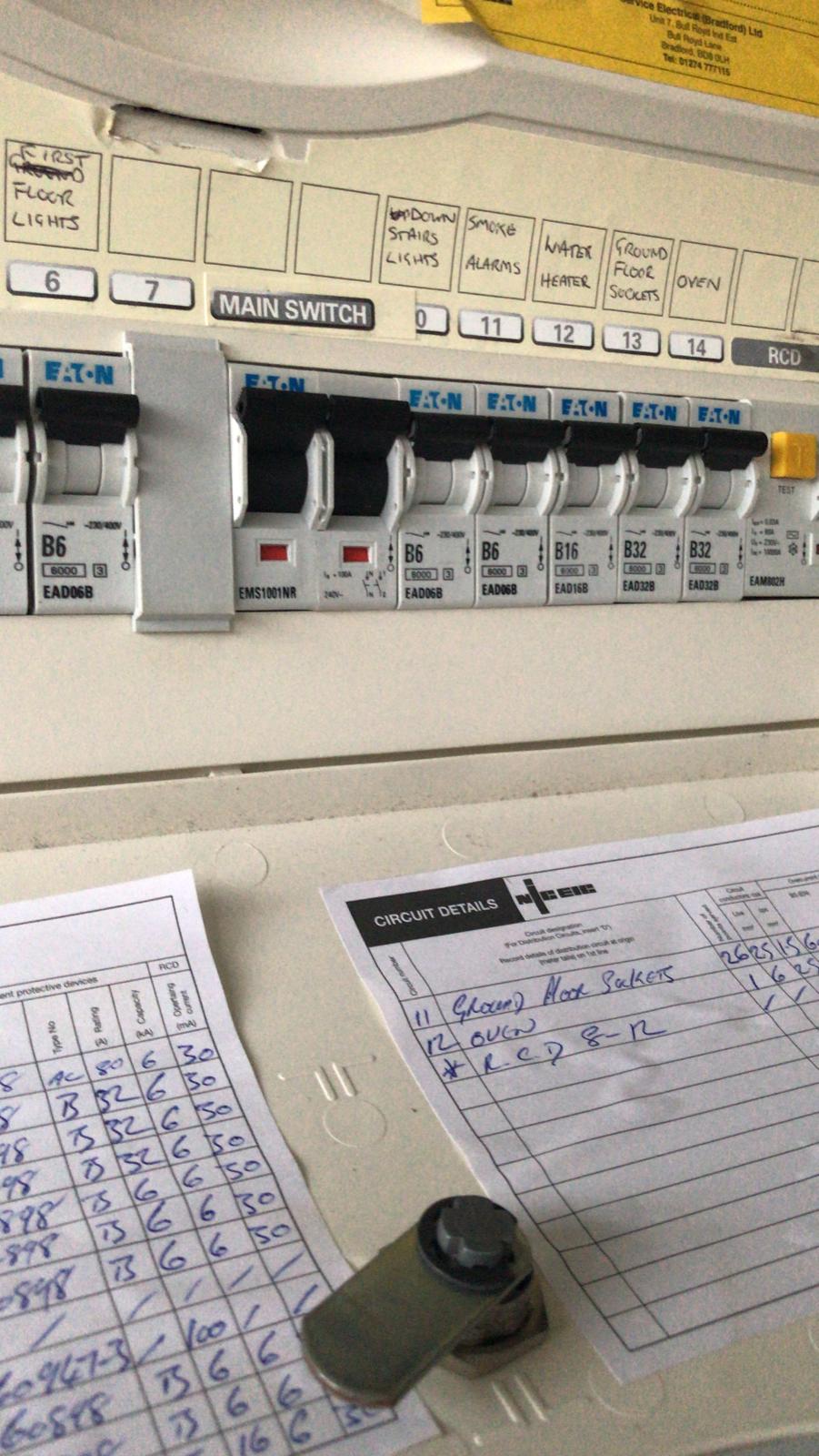

Separate circuit direct from supply to bypass main CU
Status
Not open for further replies.
If your main isolator is tripping then it isn't a main isolator.
Cheaper safer easier fix would be a UPS or other battery backup for the door mech.
Even cheaper fix is just go through the house & reset on those rare occasions
Perhaps his main switch is an RCD (RCCB).
Although that doesn't really tie in with the original post.
Already have a battery backup and no internal door to garage. Thanks though.
I might be wrong on the main switch tripping guys, I’m getting confused now (been a long day!). Will test the RCD in morning and see what happens.

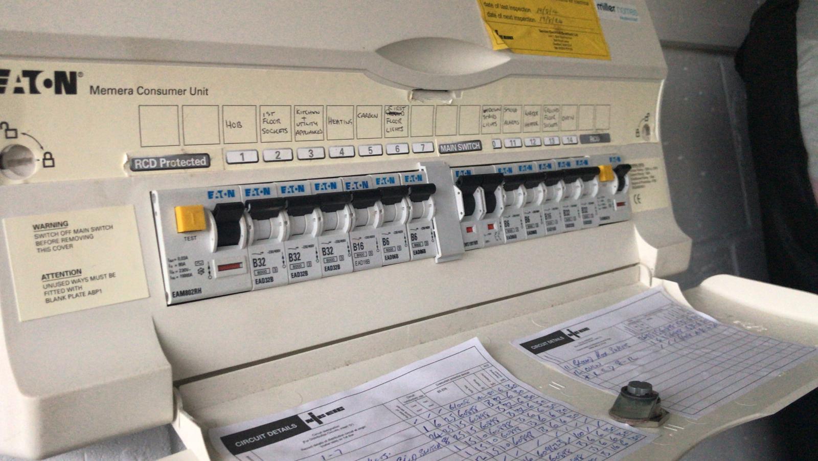

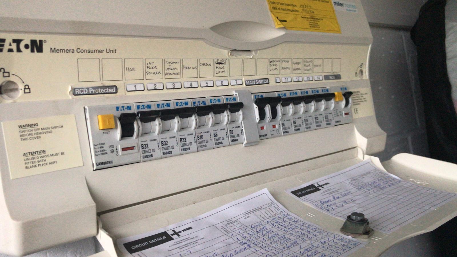

In the meantime I’ve just found this pics on my phone. Will get a cover off pic in morning for you.
Thanks for your help.
Can you do a picture of the consumer unit taken further back?
There may be a way of connecting in between the meter and the consumer unit.
Cool so I can take a feed from the load side of that then. Don’t even need a MCB downstream of it then? Just a cable to my garage door?
ABSOLUTELY NOT. The only upstream protection in that case would be your main fuse ~60-100A.
Father-in-law had same problem, cure was a key and lock which when unlocked withdrew the pin in the mechanism allowing manual operation, and a battery back up in the door so still worked with a power cut, just like a stair lift, where motor is 24 volt DC powered from batteries. I suppose you could fit an UPS, but that would limit how long the battery would last for.
Thanks. Got both of them.
