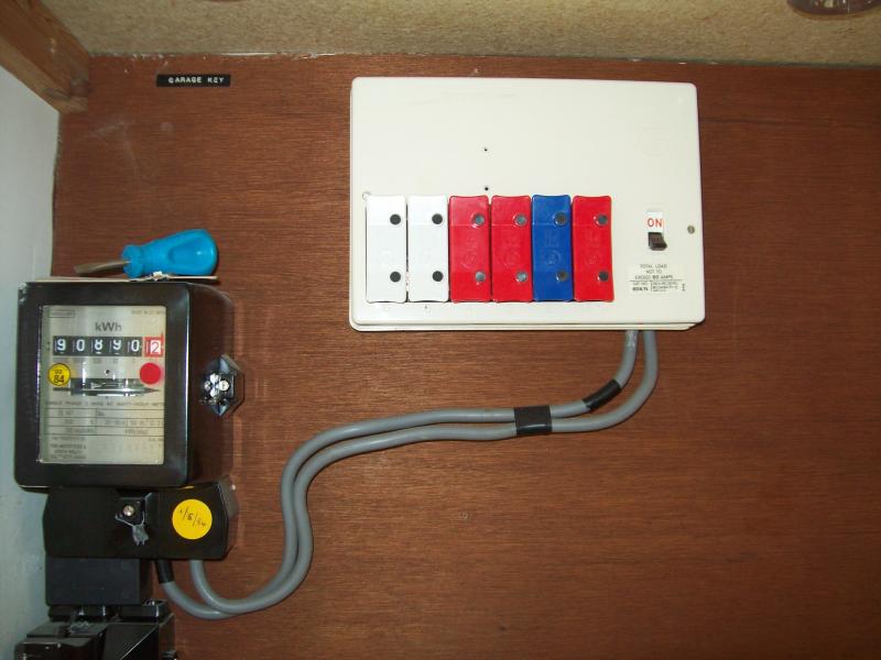

Hi guys
I'm fitting a new shower and could do with some advice.
The shower is a 10.5Kw unit
The cabling will be 10mm, the run consisting of about 3mtrs to ceiling mounted switch, then 4mtrs across the loft plus a further 4mtrs down to the fuse box, and this is where the problem starts. The fusebox is an old one with only 6 fuses (see pic ).
from left to right I know the first 2 (white 5amp) are for lighting circuit upstairs and down, the next 2 (red 30amp) are the ring mains upstairs and down, but don't know about the last two. 1st is blue 15 amp and the last again red 30amp. Could one of these be for central heating?
Firstly is this unit too small? Secondly can I fit a larger fuse carriage of i.e. 45amp. I will be connecting via an RCBO as recommended but I'm wondering wether to upgrade the consumer unit instead.
The two mystery fuses would by convention supply your immersion heater and your cooker, but it is common these days for a combi boiler to be fitted and the immersion heater removed.
You also might find the cooker has been replaced with gas at some point.
As for the new shower, you can not supply a load of that size from your existing fuse box.
You would either need the existing unit replaced, or install a henley block and fid an additional consumer unit for the shower only.
All of this work is notifiable to your LABC.

I can not see a main earth wire from your cutout to your fuse box, which is a big worry if one is not present.

Thanks RF guess you've confirmed what I thought, new consumer unit it is then.
As for the earth lead, this is the unit as wired when house was built in 1984 so I assumed it was wired correctly, if not I'd better get it checked out.
Again many thanks
Can you take us a photo of your cutout and supply cable?
(the bits below your meter)
We should be able to tell the supply type and see if there is actually an earth present.
On a 1984 installation, I would expect to find a main earth present (albeit undersized by todays standards)
You will probably also need your main protective bonding upgrading before you can have this work to install the shower done. :(
Thanks RF here's the pic, I guess you mean that earth cable at the bottom, so at least it is there. :D
Also, given that I will be adding a further two showers, (ensuites), what size unit would you recommend?
The house is 4 bedrooms but I think not very well built in the firstplace :cry:
You will not be able to get an RCBO for that CU, and is is rather elderly.
Have a think about getting a new CU fitted. If you can afford all new RCBOs as well, so much the better.
It will be considerably more expensive though :( but at least you will only need one large one with space for future expansion (a large CU costs very little more than a small one, as you are mostly paying for fresh air)
